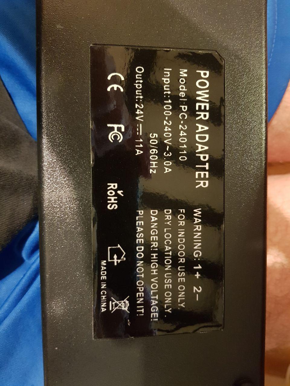

@alil2096 said in Configuration duet wifi + clearpath:
Error: Attempt to move motors when VIN is not in range
How are you powering the Duet? It sounds to me that you haven't connected VIN power.
oh, sorry.
I use this power supply:
Thanks,
Andrea
