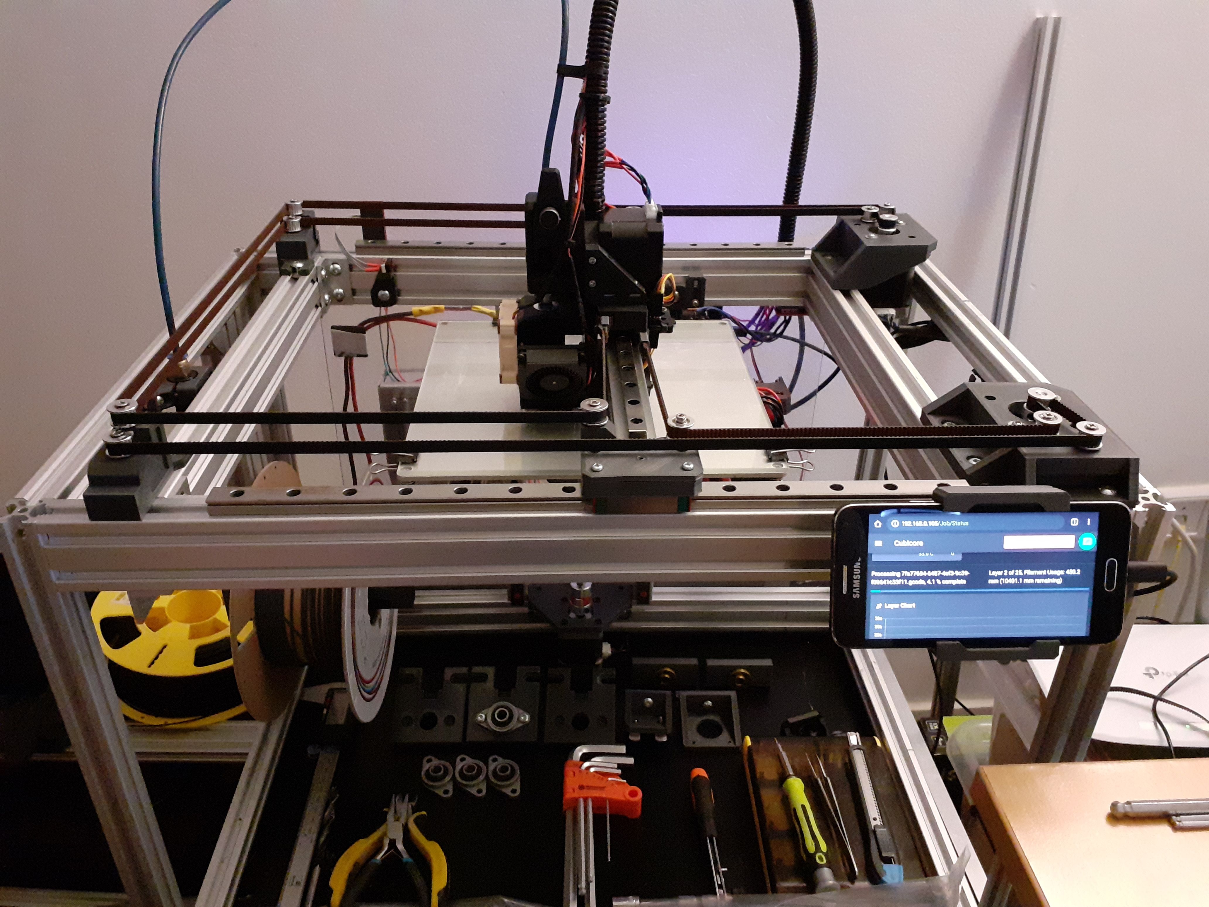

  • @Dkos said in Print quality issue:
    It is a DIY CoreXY printer
    can you post a picture of the printer? then we may be able to give more hints as to what could be causing problems.
  • @Veti Yes of course.
    Here is the current state with a cantilever z axis (dual linear rails):
    And i have a weekend upgrade (long time coming one..) planned for a dual lead screw bed with 1 Z motor and 3 screw leveling cast aluminum bed:
    Last, i am currently figuring out the most convenient way to add a thin aluminum plate on top of each pulley pair on the XY system. As it turns out, some of the have a bit of play, which may introduce the backlash that dc42 is talking about. At the moment i readjusted all of them to be as tight as possible (and still being able to turn without much friction) and have a print on the way. But this might be the source..
  • the belts on the x axis dont look perpendicular to each other.
    that will cause slight positional errors as well.
    can you post a picture from above?
  • I attached both real and CAD since its not very clean:
    There is a bending due to the clamping of the ends next to the extruder if thats what you noticed.
    Yes that is going to lead to positioning errors since the length of the belt will vary depending on the angel of the belt. Those belt runs should be 9o degrees perpendicular to the idler direction change.

    Thanks both for the 90degrees notice, i did not though of that! I will design a new way to clamp the belts.

  • So.. in order to fight the issues one by one. I did a kind of "dirty" redesign of the belt clamps in order to make the belts parallel, which did improve the situation:

  • So, I finally solved my issue. The culprits where all these idlers:
    These are the typical cheap ones, that had a fair amount of play between the inner 3mm bore and the m3 bolt which is of course less a bit less that 3mm. I did a quick test by replacing them with pairs of F623ZZ (which i was able to tighten all the way without blocking their rotation...) and had a huge quality improvement, so i went ahead and redesigned all the idlers to use F625ZZ to go from 3mm to 5mm shaft, and placed an order for shoulder bolts. That should be considerably stiffer.
    That of course as far as the mechanical part is concerned. The slicer related issues might be compensated a fair amount by tweaking the settings, but not entirely disappear.
