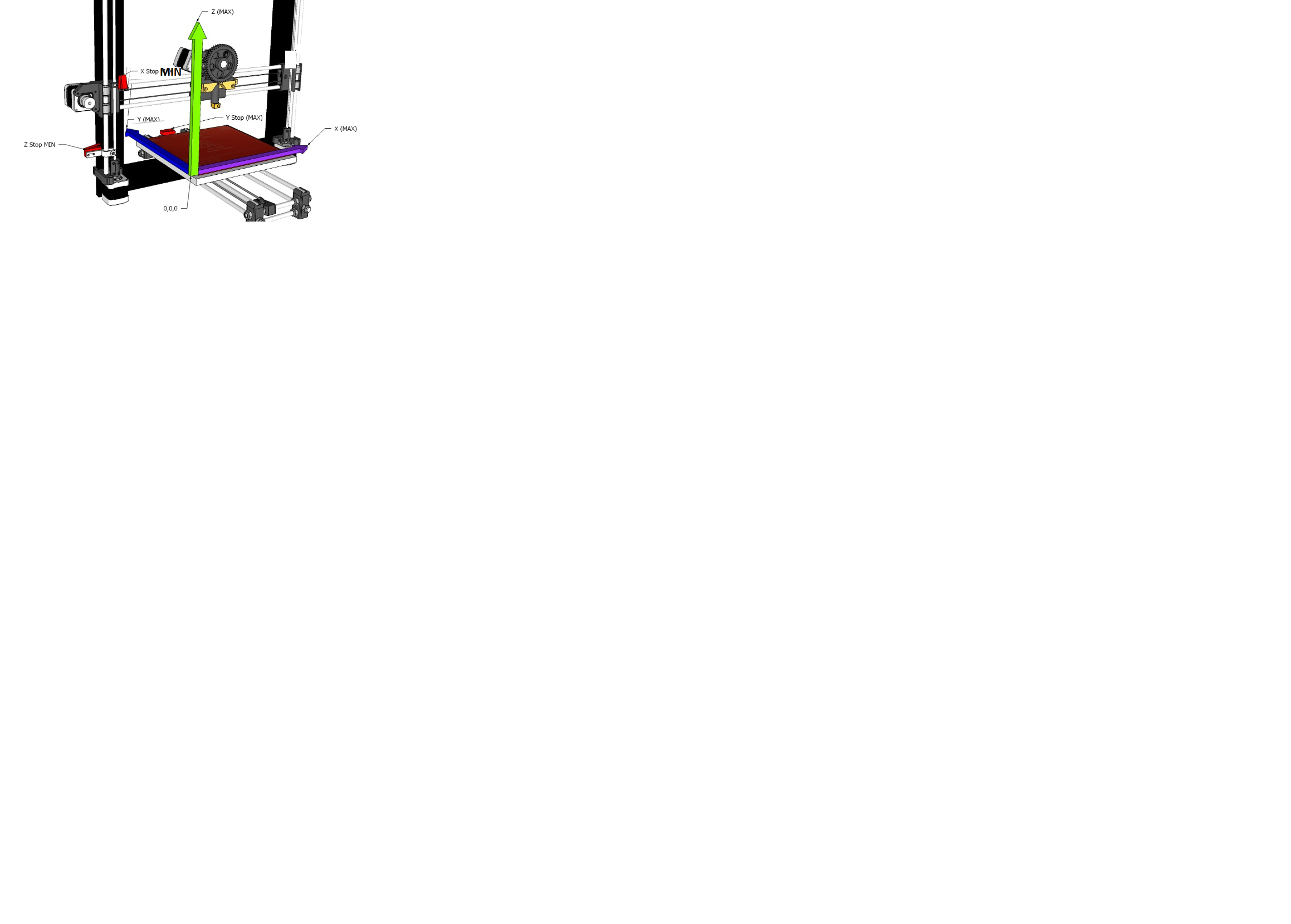

Have a little hard to understanding how is it with Endstop Location at low end high end. How can explain this to an old man.
If we take X axis in my case, I have home 0 for printer on left seen from the front.
X step motor to go right must rotate counterclockwise (backward).
The switch is to the left of the X axis, and connected to the NC.
How about the endstop which should i choose, low end or high end.
has drawn a sketch of it.
; Drives M569 P0 S0 ; physical drive 0 goes backwards M569 P1 S0 ; physical drive 1 goes backwards M569 P2 S1 ; physical drive 2 goes forwards M569 P3 S0 ; physical drive 3 goes backwards M584 X0 Y1 Z2 E3 ; set drive mapping M350 X16 Y16 Z16 E16 I1 ; configure microstepping with interpolation M92 X160.00 Y160.00 Z1600.00 E873.08 ; set steps per mm M566 X900.00 Y900.00 Z12.00 E120.00 ; set maximum instantaneous speed changes (mm/min) M203 X6000.00 Y6000.00 Z180.00 E1200.00 ; set maximum speeds (mm/min) M201 X500.00 Y500.00 Z20.00 E250.00 ; set accelerations (mm/s^2) M906 X800 Y800 Z800 E800 I30 ; set motor currents (mA) and motor idle factor in per cent M84 S30 ; Set idle timeout ; Axis Limits M208 X0 Y0 Z0 S1 ; set axis minima M208 X230 Y210 Z200 S0 ; set axis maxima ; Endstops M574 X1 Y1 Z1 S1 ; set active high endstops
If moving the axis to bigger (positive) numbers makes it go toward the switch, the switch is at the high end.
If moving the axis to smaller (negative) numbers makes it go toward the switch, the switch is at the low end.
To keep from crashing things, do a very small move. This is easiest to do in relative mode, for example (you can enter these one at a time on the console):
M564 H0 G91 G1 F1000 X-10
The M564 allows movement without homing. The G91 is relative mode, and the G1 will move X 10 mm. Since it is negative, if X moves toward the homing switch, that switch is at the low end.

On the left or right of the shaft (0 home is on the left together with the switch and the stepper motor is going from left to right on the Xaxel to move the extruder carriage)
One question, stepmotor motion is against the switch or vice versa when setting stepmotor motion to in drivers.
very complicated for me. Must learn more about this. -
You've asked about everything EXCEPT the numeric value that moves X. And that value is THE determinant. Yes, it seems complex if you bring in left, right, counterclockwise. But... none of that matters. Push it out of your mind. Make it simple.
Does
move the carriage TOWARD the switch? If so, that is the low end. Period. Nothing else enters into it. You can enter all three commands on one line exactly as shown. Please do that and report whether it moves toward the switch.P.S. The "negative moves toward = low" is exactly what @deckingman said in the third post in this thread.

G code M564 H0 G91 G1 F1000 X-10, nothing happens but if you do X positive, 10 moved to the right.

The second part is correct, +10 should move to the right in a Cartesian coordinate system. The last part of the puzzle is to determine if the switch is on the far left (M574 X1) or far right (M574 X2).The switch is on the far left (M574 X1)
and now works properly with home all.
step motor goes towards the switch on the left press and x step motor stops. I continue with the calibration now, it will be a challenge for a senior, who is a bit sluggish.
PS motion on stepmotor forward and backward is determined by low end and high end, or anything else, or not at all. My clever puzzle that I have to solve -

if you have a printer like in the pictures where the bed moves, the confusing part may be that you're not interested in the movement of the bed, but rather the position of the nozzle on the bed. so a positive Y movement should move the bed towards the front, but the nozzles relative position would be towards the back of the bed.
so the y switch at the back of the printer would trigger when the nozzle is at the front of the bed, meaning low end.
(i.e. its the nozzle and coordinate system that determine motor direction, and then you set the end stop location after the motor direction is having the desired effect on the nozzle position)

Fantastic! Combining these two answers, the negative move moved TOWARD the switch. That means the switch is on the LOW END.
That means your M574 for this switch should specify X1 S1
Yay! Progress!
@chris4 said in calculate the positions of switch, low and high:
You don't really care how the motor turns. You care how the carriage moves. As we determined in the prior post, -10 moves TOWARD the switch, so the switch is LOW END.
