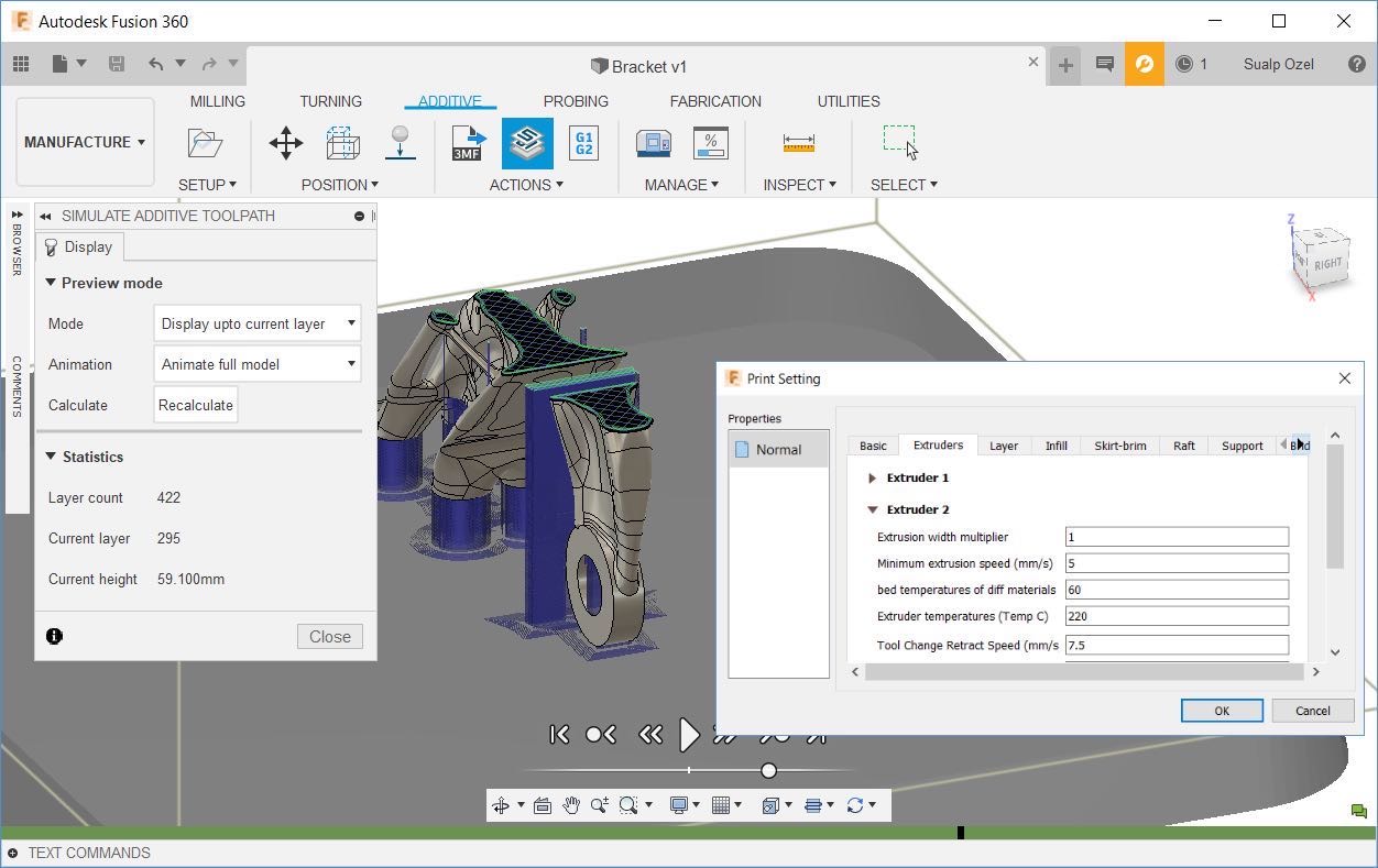

So, Fusion 360 is getting FFF slicing capabilities soon. It appears that it will be able to slice solid geometry, like produced in CAD packages. Whether or not it outputs g-code curve commands is not known, but it seems promising.
[...] we have been working on adding new AM technologies into Fusion 360, starting with Fused Filament Fabrication (FFF). This new method of sliding and toolpath creation will be available for both Single and Dual nozzle printers within the Manufacture workspace. Autodesk is an innovator in non-planar 3D printing and for generating high quality top surfaces, and we plan on adding this functionality into Fusion 360 in the near future as well.I remember somebody mentioned KISSlicer was getting/has STEP file import capabilities. How is the progress on that?
I bring this up, because I am very excited about the new era of FFF printing. I think the time for curves in g-code is soon. I think S-Curve acceleration or similar must follow, too.
I'd like to hear what people's current thoughts on these matters are.
I am approaching near-desperation to try s-curve acceleration, or an approximation, because I am reaching the limits of the balance of speed vs. quality. I, unfortunately, do not have the skills to code these solutions or I definitely would be trying. I've been trying for years to convince the people I know who can code to help with this but none have stepped forward.
So... what do you think?
