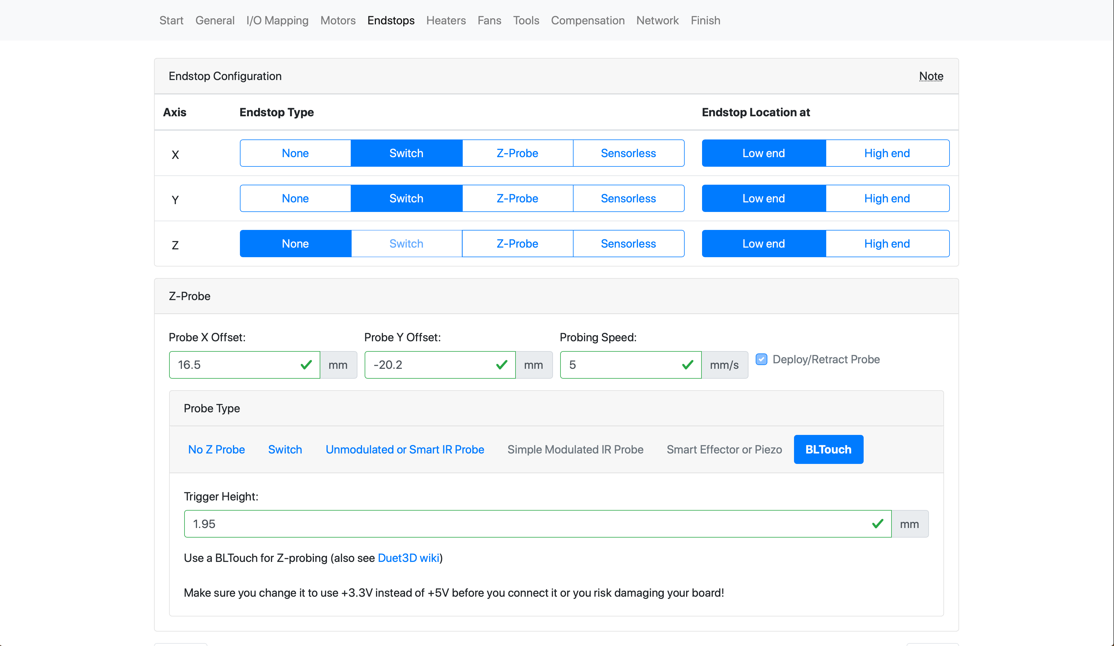

      G28 end-stop error happens after updated RRF 2.03 -> 3.1.1
        jay_s_uk
        Have you read the upgrade notes and updated your config.g accordingly?
        • tkdirpundefined
          tkdirp
          I believe so...
            jay_s_uk
            you'd be better of posting the contents of your config.g
            Can you also run M115 and make sure you're definitely on 3.1.1?

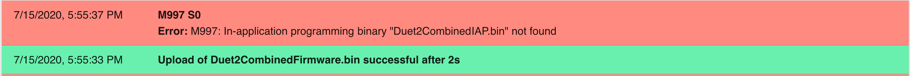

                  could this be a problem?
                  • tkdirpundefined
                    tkdirp
                    I am currently using a Duet 2 Wifi
                      jay_s_uk
                      you need to upgrade to RRF3.0 first. It can be found here https://github.com/Duet3D/RepRapFirmware/releases/tag/3.0
                      Use the Duet2and3Firmware-3.0.zip
                      Then upgrade to 3.1.1 from here https://github.com/Duet3D/RepRapFirmware/releases/tag/3.1.1
                      Use the Duet2and3Firmware-3.1.1.zip
