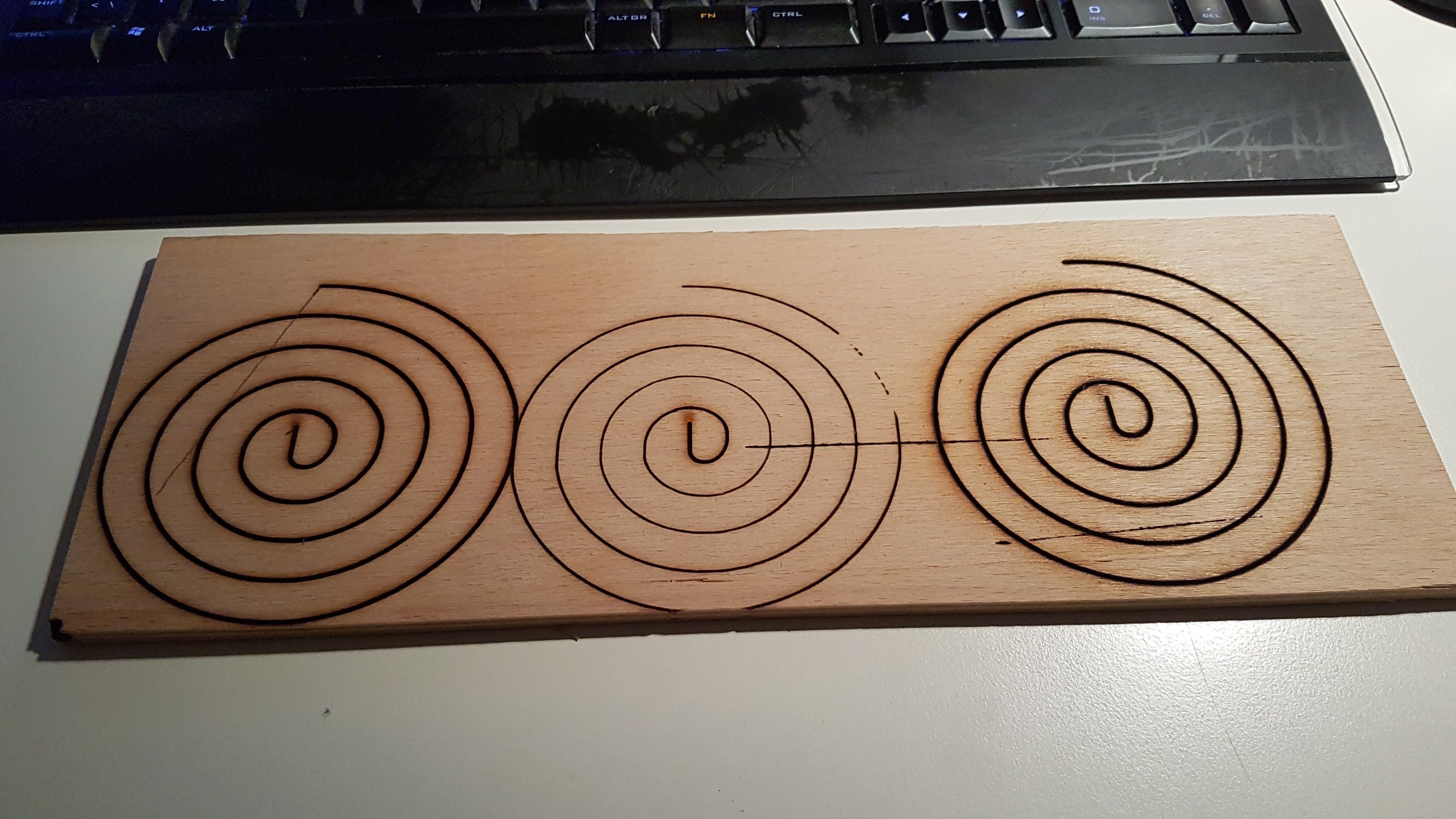

      I'd love to get some advice from you guys.
      I'm using the new Duet 3 Motherboard 6HC + RPi (DSF Version: 3.1.1, RepRapFirmware for Duet 3 MB6HC 3.1.1 (2020-05-19b2)) and built my own laser using an SPT 100W red dot tube and an Cloudray 100W power supply. It moves, it lazes, but not consistently. I spent many nights troubleshooting and would love to get your input on the following problem:
      When i start a lazing job, initially the power is very high, but looses lots of power over the next 4-5cm - it finishes the job with this very low power (probably only about 20% of the acutal set power) - it sometimes doesn't even activate the laser anymore (which means less than about 5-6mA). During all this i get normal amperage readings (17mA for S0.5 = 50% PWM), which confuses me.
      Today i disconnected the power supply from the Duet 3 and controlled power via a potentiometer - no power loss here (I'm very happy about this - thought i killed the tube!). Below you'll find two test jobs i just lazed.
      Image: Left - 15mA via Potentiometer, Right - 17mA via TTL
      All this tells me I must be doing something wrong controlling the lasers power input via TTL:
      • I connected the 5V rail of the power supply to the "IN" port - which should give full power if activated via TTL.
      • I attach the ground-cable from the duets "out9" (the somewhat dedicated laser output port) to TTL_High "H" on the power supply and ground from the out9-port to ground on the power supply.
      • I'm overriding the waterpump-alarm on the power supply with a simple switch.
      This is my config.g:

      M452 C"out9" R1 S1 Q20000
      I think this should be all the information needed. I'm happy to provide more if I missed something.
      Thanks for your help
        droftarts administrators @Royassas
        @Royassas I’m not a laser expert, so not sure I can help much. But I think to help, can you supply the Gcode file too? Is there a reason for using R1 rather than R255 in M452? Is the PSU expecting a 20000hz input for the TTL?

          @droftarts Thanks for your reply.
          I'm using R1 because i use LightBurn with the Smoothieboard-settings - i can't change the min/max S parameters in that profile.
          This is the GCode-File i used:

          No reason for the 20'000 Hz, i think i read that the duet 3 can output 65khz max. - i can't find any recommandations on the cloudray power supply specs for this. I'm using this one: 100W CO2 Laser Power Supply MYJG-100W LCD. My nooby self expects a smoother average voltage with higher PWM-frequency.
          • Royassasundefined
            Royassas
            I'm hoping to get a grip on an oscilloscope in the next couple of days to check the PWM output
            • Royassasundefined
              Royassas
              Ok - problem solved! A new member of our makerspace brought his scope. Turns out, there's a little glitch in the documentation of possible Gcodes für the M452 command:
              @dc42 I suggested the following correction of the at GCode Wiki:
              M452 C"exp.heater3" F100 ; laser uses heater3 pin, PWM frequency 100Hz
              instead of:
              M452 C"exp.heater3" Q100 ; laser uses heater3 pin, PWM frequency 100Hz
              That letter must have cost me 5 nights 😉
              With this change I got to play with the PWM-frequency:
              • If i set it too low, for example to 500Hz - the default if no F parameter is set, I got the problem described above.
              • If i set it too high, for example the maximum of about 65kHz, i oversaturated my power supply and the laser kept burning at maximum power.
              In the end i settled for 12500Hz - and lazing is fun again!!
              droftartsundefined 1 Reply Last reply Reply Quote 2
                @Royassas well spotted, and sorry for the wasted time! I’ve accepted your edits to the Gcode page.
                It probably would have helped if sending M452 with no parameters reported the current settings, then you would have seen the frequency was not changing, but M451/452/453 were originally defined (not by us) to have no parameters. So they switch modes without any. M450 reports the mode (CNC/laser/3D printer) but not the parameters. I’ve asked @dc42 if he can add parameter reporting to M450.
