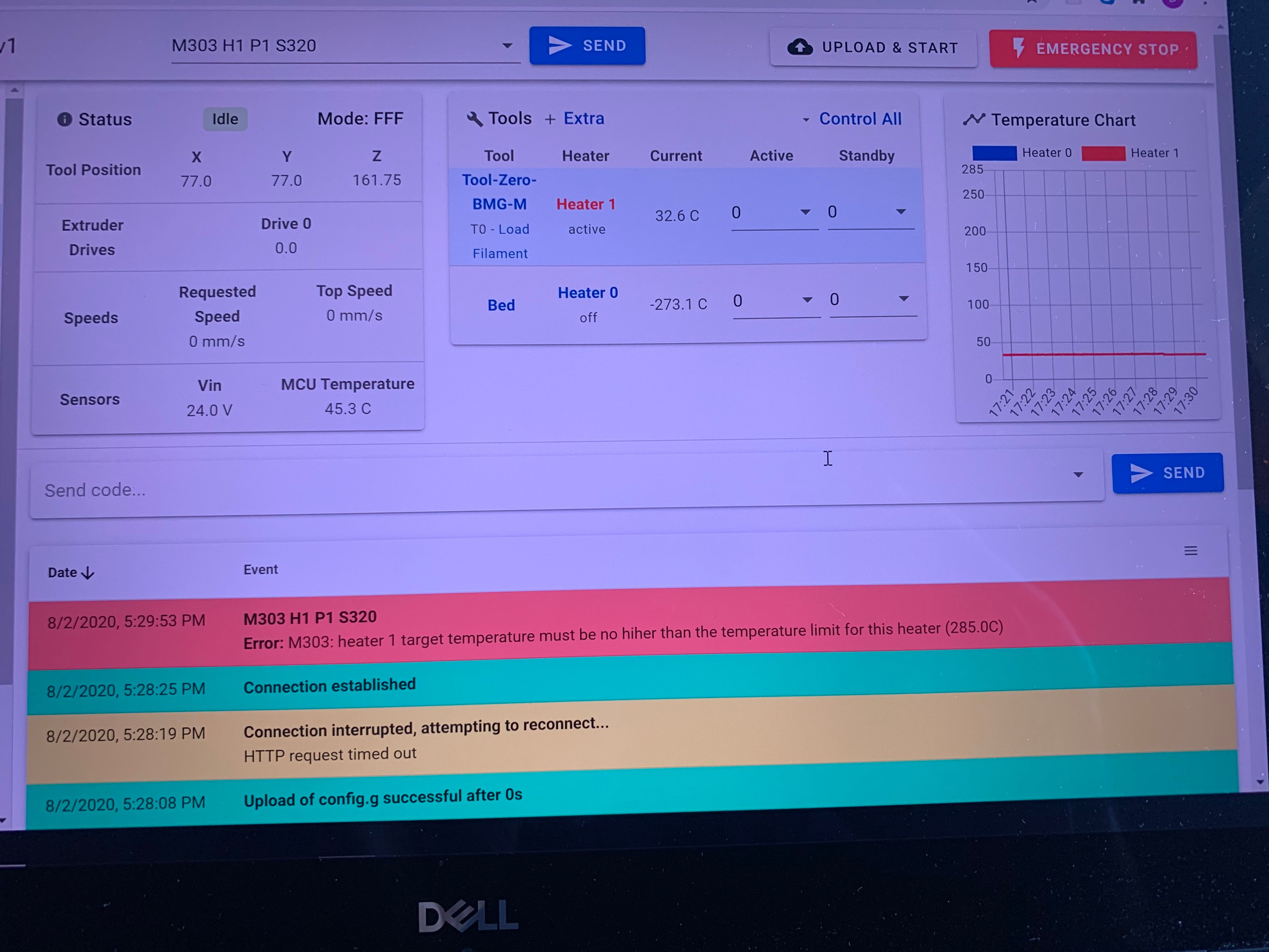

Here’s my set up
- Mosquito magnum
- Bondtech BMG-M ( not relevant but here it is )
- Slice high temperature thermostat 450c
- Slice heater ( 24v )
- Duet 3D 2 Wi-Fi - running reprap 3.1.1
- Configured thermistor with the reprap configuration tool to 445c .json file reflects that - i’m stumped
- thermostat and heater are properly installed
Heater section of config.g
—-; Heaters
M308 S0 P"bedtemp" Y"thermistor" T100000 B4138 ; configure sensor 0 as thermistor on pin bedtemp
M950 H0 C"bedheat" T0 ; create bed heater output on bedheat and map it to sensor 0
M307 H0 B1 S1.00 ; enable bang-bang mode for the bed heater and set PWM limit
M143 H0 S120 ; set temperature limit for heater to 120CM308 S1 P"e0temp" Y"thermistor" T500000 B4723 C1.19622e-7 ; configure sensor 1 as thermistor on pin e0temp
M307 H1 B0 S1.00 ; disable bang-bang mode for heater and set PWM limit; M140 H1 ; map to heater 1
; M143 H1 R445 S445 ; set temperature limit for heater to 445C
M143 S445 ; set temperature limit for heater to 445C—-
Thought I was getting closer
M303 H1 S240
https://duet3d.dozuki.com/Wiki/Tuning_the_heater_temperature_control
It’s either configuration, or reprap has no adjustable temperature limits

See snaps
That tuning was the magic potion capped out at 302c

@fcwilt I can reach 305c so 350c seems reasonable since the thermistor can reach 450c accurately
@supset said in Maxing out at 305c - ideas thoughts?:
I tune my normal heaters at 190 even though they can reach higher.
So it may be that if you tune at 300 it will work fine at 450.
@fcwilt really, I’ll give it a try,...
@fcwilt ya,...
@fcwilt it seems like that’s just a runaway setting, not an active or target setting
True but perhaps it could interfere with tuning?
@fcwilt you’re suggesting, commenting it out, perhaps yes
@fcwilt it seems the M143 Command possibly works, I commented it out, and got this, default 285c limit
I put it back and restarted, and the error disappeared
OK so the M143 setting does play a role in the tuning process and your previous value of 445 should not have interfered at all when using the 350 target temp.
Did you get a chance to try 300 when tuning?
I am thinking perhaps that the firmware isn't expecting such high temps like 350 and has tuning issues.
And if you could get it tuned for a lower temp like 300, 310, 320, etc then the heater might work fine for higher temps when it was simply heating.
https://forum.duet3d.com/topic/17972/config-json-update-not-works-configtool-nozzle-temp-limit
It looks like there is a bug in the config tool where M143 isn't being generated for the hotend, which would lead to the default limit being applied.
I've also asked if there is a hard upper limit for setting M143.
