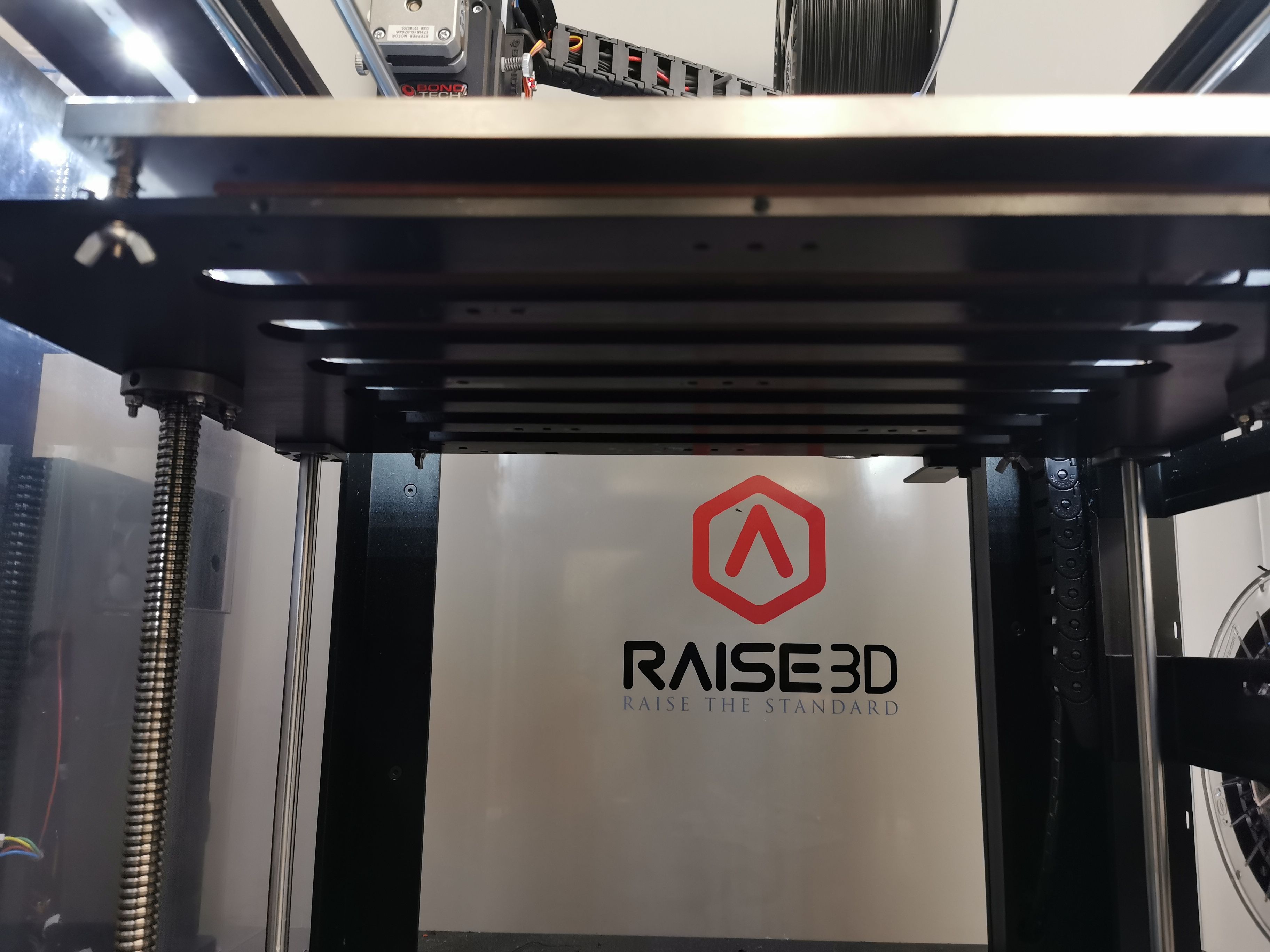

      Hi, I recently bought a Raise3D N2 and decided to install a Duet2Wifi.
      I have a question about the heated bed thermistor on Raise3D.
      Here is a diagram I did by measuring the resistor installed on the bed.
      The bed provide a 3 wires connection : Signal, +5V, GND.
      On Duet Wifi, only 2 wires are necessary.
      Can I plug the Signal and GND wires of Raise3D Heated Bed, directly on The Duet Wifi ? Are am I missing something ?
      Thanks for your help.
      Thomas

            • Thomas_Stagsforgeundefined
              Thomas_Stagsforge @Phaedrux
              @Phaedrux
              Here some pictures :
              • Vetiundefined
                Veti
                according to this
                https://github.com/Raise3D/Marlin-Raise3D-N-Series/blob/master/Marlin/Configuration.h
                the Hotend is a thermocouple
                the Bed is a
                // 8 is 100k 0603 SMD Vishay NTCS0603E3104FXT (4.7k pullup)
                Thomas_Stagsforgeundefined 1 Reply Last reply Reply Quote 0
                  Thomas_Stagsforge @Veti
                  @Veti
                  Good, thanks for the information, good idea to check on Marlin. So we can see the sensor on the picture n°2.
                  I just measure 10kOhm. Don't why I got a 100kOhm when I first checked...But according to the spec i should read 100 000ohm... I'm gonna do futher research. Thanks for your help.
                  Vetiundefined 1 Reply Last reply Reply Quote 0
                          Doing another search on the Raise3d forums found someone doing a conversion of the N2 to Duet wifi and they say the thermocouple isn't compatible and they attach a new thermistor. But they don't say why or what about it isn't compatible. Using a thermocouple would require a thermocouple daughterboard, so maybe that's what they mean. The 5V line is also confusing. So to even try it you'd need to buy that daughterboard, which will be more expensive than just getting a standard NTC100K 3950 thermistor or PT1000 sensor that doesn't need any additional board.
                                @Veti
                                See this link, I suppose this is why there is +5V.
                                link text
                                I ran some test. So I plug the sensor to the duet with only 2 wires. There are connected to Signal and Gnd on the heated bed. The DuetControl app give me 25°C room temperature, not bad. I warmed up the thermistor with a blowdryer, temperature ingrease to 40°C. I currently doing a test with melting ice in a bag to get close to 0°C.
                                    Thomas_Stagsforge
                                    Hi, just a quick update. I did a test with water and ice, the temperature drop at 14°C.
                                    Anyway, I think with the actual smd thermistor it will work.
                                    When my duet2wifi wiring will be finished I'll be able to test it in real conditions.
                                    I made a change on configuration file buy editing the B value to match the datasheet specification (4100).
                                    Thanks everyone for your help.
