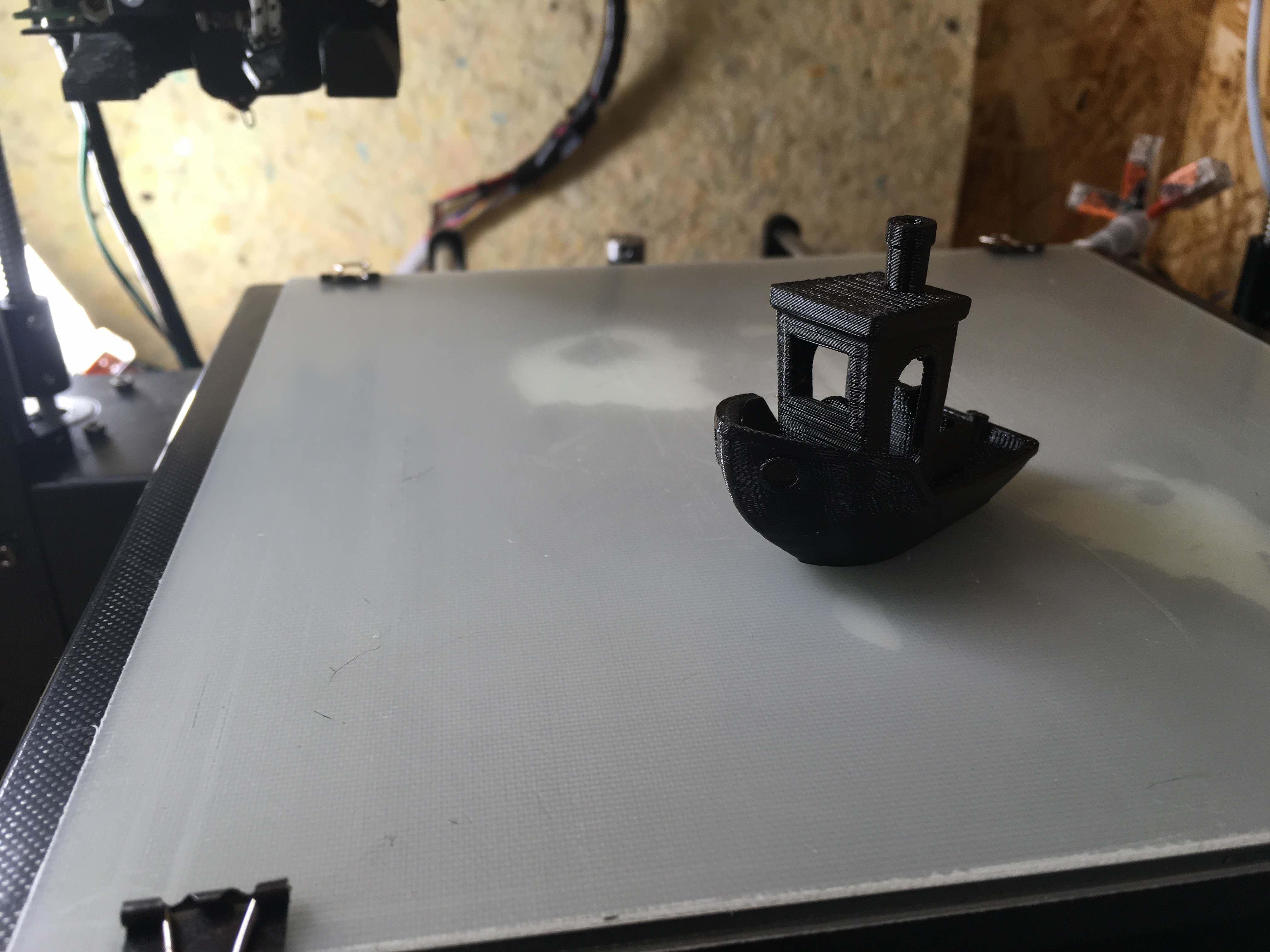

Board is a duet2ethernet-1.0.4 printing fine
even without any calibration (next thing to do):
