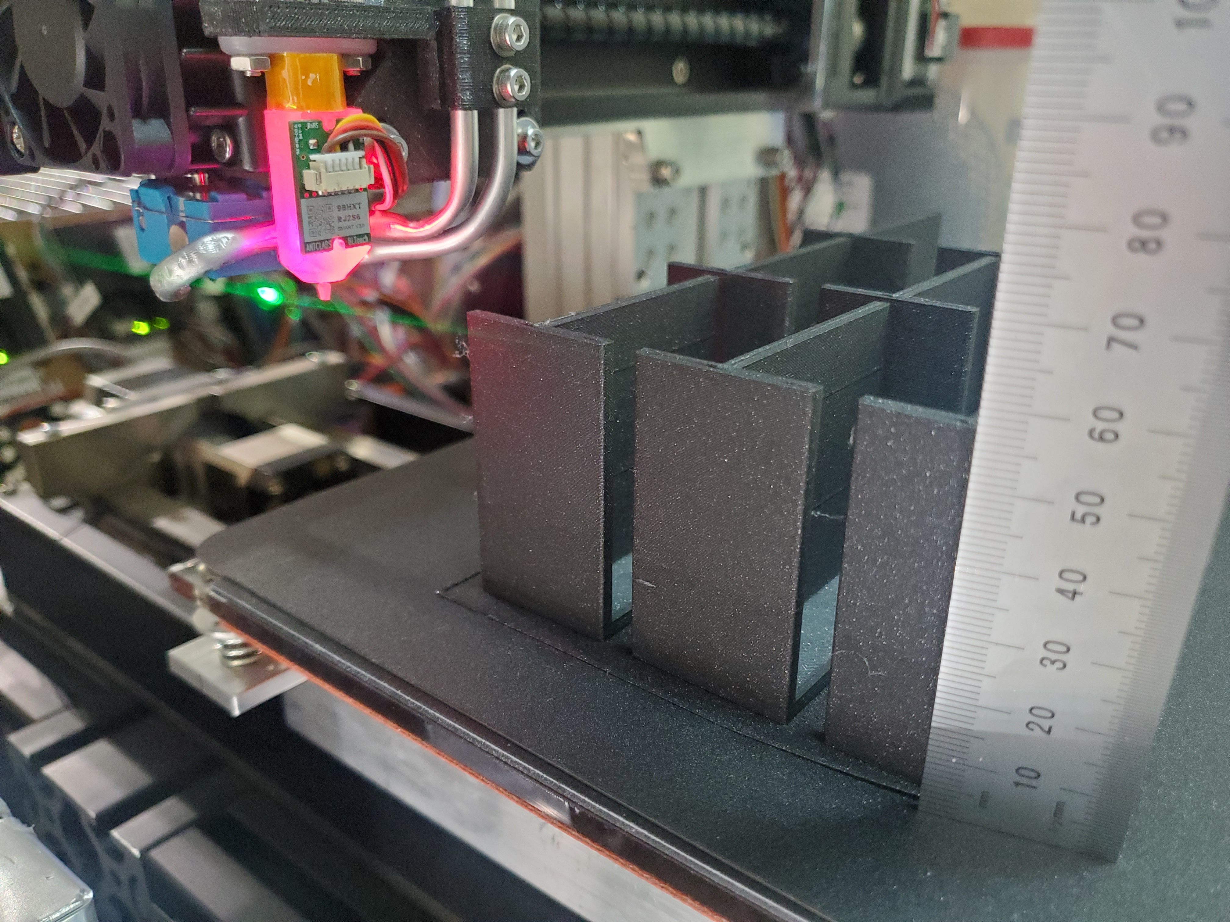

    Hello, I am using prusament galaxy black filament with duet wifi V2.
    I got two bands on my print.
    This is the second time it happened out of about 70 prints on this machine. All other prints are flawless.
    I was not able to watch it live as it happened.
    The other time it happened was long ago at 10mm heigjt and I think the printer moved 20% the speed than usual.
    Please help me find out what may have caused this.
    This may be totally unrelated events.
    I can provide more details as needed
    Thank you

    My guess is that your Z acceleration and/or jerk are set a little too high, so that you occasionally lose steps. Or, if your printer uses external drivers for the Z axis, you have one of the M569 timings set too low.
  • Moderator
    Can you post your config.g?
    Can you post your homeall.g?
    Can you post the entire gcode file or at least the first 50 or so lines of it?
    Can you send M122 and post the results?
    Can you send M98 P"config.g" and post the results?

  • Moderator
    @likevvii said in Thick layers:
    Error: Bad command: : LCD
    That appears to be from a bad comment in your config.g
    : LCD
    M575 P1 S1 B57600
    : instead of ;
    Warning: Heater 0 appears to be over-powered. If left on at full power, its temperature is predicted to reach 365C Warning: Heater 0 appears to be over-powered. If left on at full power, its temperature is predicted to reach 284C
    These are normal warnings. https://duet3d.dozuki.com/Wiki/FAQ#Section_M307_Heater_1_appears_to_be_over_powered_If_left_on_at_full_power_its_temperature_is_predicted_to_reach_521C
    Error: Driver 5 does not support x1 microstepping Driver 6 does not support x1 microstepping
    @dc42 said in Thick layers:
    I don't think this is the case here since you're using the internal drivers for Z and E. But I'm not sure why it's complaining about x1 microstepping.
    M569 P5 S0 T3 ; physical drive 0 goes forwards
    M569 P6 S1 T3 ; physical drive 1 goes forwards
    https://duet3d.dozuki.com/Wiki/Gcode#Section_M569_Set_motor_driver_direction_enable_polarity_and_step_pulse_timing
    https://duet3d.dozuki.com/Wiki/Using_external_stepper_motor_drivers
    M376 H5 ; MESH COMP HEIGHT
    You may want to try increasing the taper height value, though I can't see why it would cause those bands. https://duet3d.dozuki.com/Wiki/Using_mesh_bed_compensation#Section_Compensation_Taper
    Otherwise the homeall looks fine.
    M201 X2400.00 Y2400.00 Z3000.00 E2000.00 ; set accelerations (mm/s^2)
    The Z axis acceleration looks really high though. Z3000. Given the low Z jerk and low top speed and small moves involved in a layer change I wouldn't think it would cause an issue, but you may want to reduce that to something more reasonable for a heavy slow axis like Z. Try Z300.
    For microstepping on Z I would stick with x16 with interpolation.
    If you compare the printed model to the slicer gcode preview is there anything in that layer range that might cause a bulge? Error in the model causing a layer gap that's being filled by bridging or something?
  • @Phaedrux
    Thank you for the suggestions.
    Fixed the issues and followed your recommendations.
    I changed Z accel:
    3000 to 300
    My Cura slicer shows zero signs of bands or imperfections.
    I wont touch step width and pulse timing for now since I don't fully understand it yet.
    Regarding the Z, I'm afraid it would be detrimental to my performance due to step rate maxing out. But I guess i'm just paranoid since a little timeout would barely be noticeable.
    I will see what happens for my future prints!
  • Moderator
    Why do you think changing your Z axis microsteps to x16 would max out the step rate? Especially given the low max speed you have set.
  • @Phaedrux
    I don't fully recall the exact values, but I did some math when doing a simultaneous (~150mm/s) X and Y move paired with extruder working and mesh bed leveling + sometimes Z hop it would pass 85KHz step rate (I am using duet wifi 2) and would get some stutters.
    So I thought getting Z microstepping to as low as possible would be a good idea to help out with the reducing step commands since my mechanical resolution was so good anyways.
    I would also love to double my X and Y microstepping rates too. Just not enough commands to keep up sadly!
