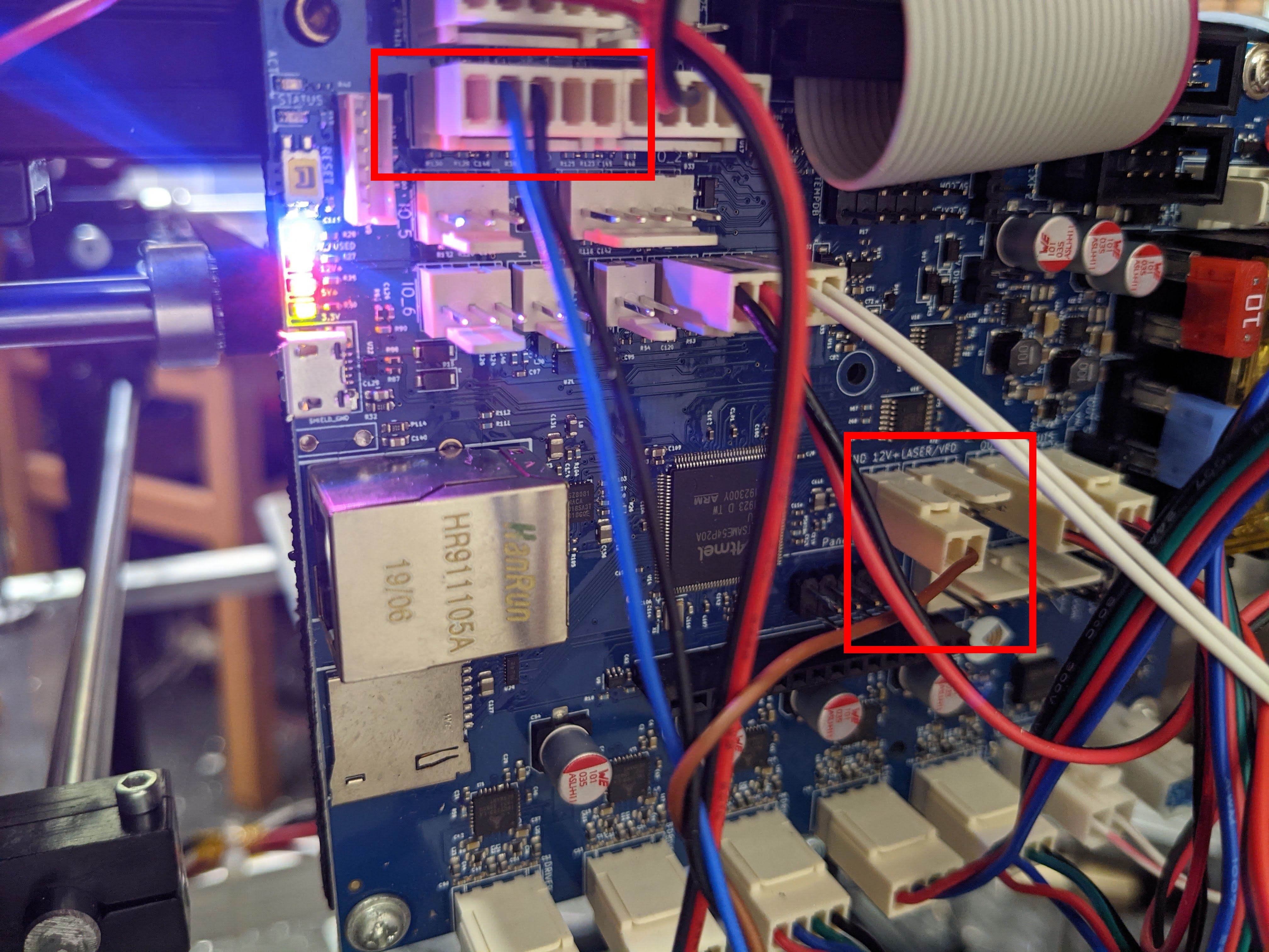

      Hi all,
      I have npn 12/24 sensor for x/y and I want know if anyone have already connect it on the duet 3?
      I can put brown and blue on the Vin for the 24v and just put the black on endstop signal on the board?
      If anyone have a solution I take it 🙂
      Thx!
        jay_s_uk @Amagatth
        @Amagatth I run a similar probe almost the same way. I take 12v from another header and then connect ground and the input pin on the endstop header.

          @jay_s_uk did you have a photo of your installation plz?
            jay_s_uk
            @Amagatth here you go
            The one on the left is the ground and signal connection, the one on the right take 12v (as thats my system voltage)
