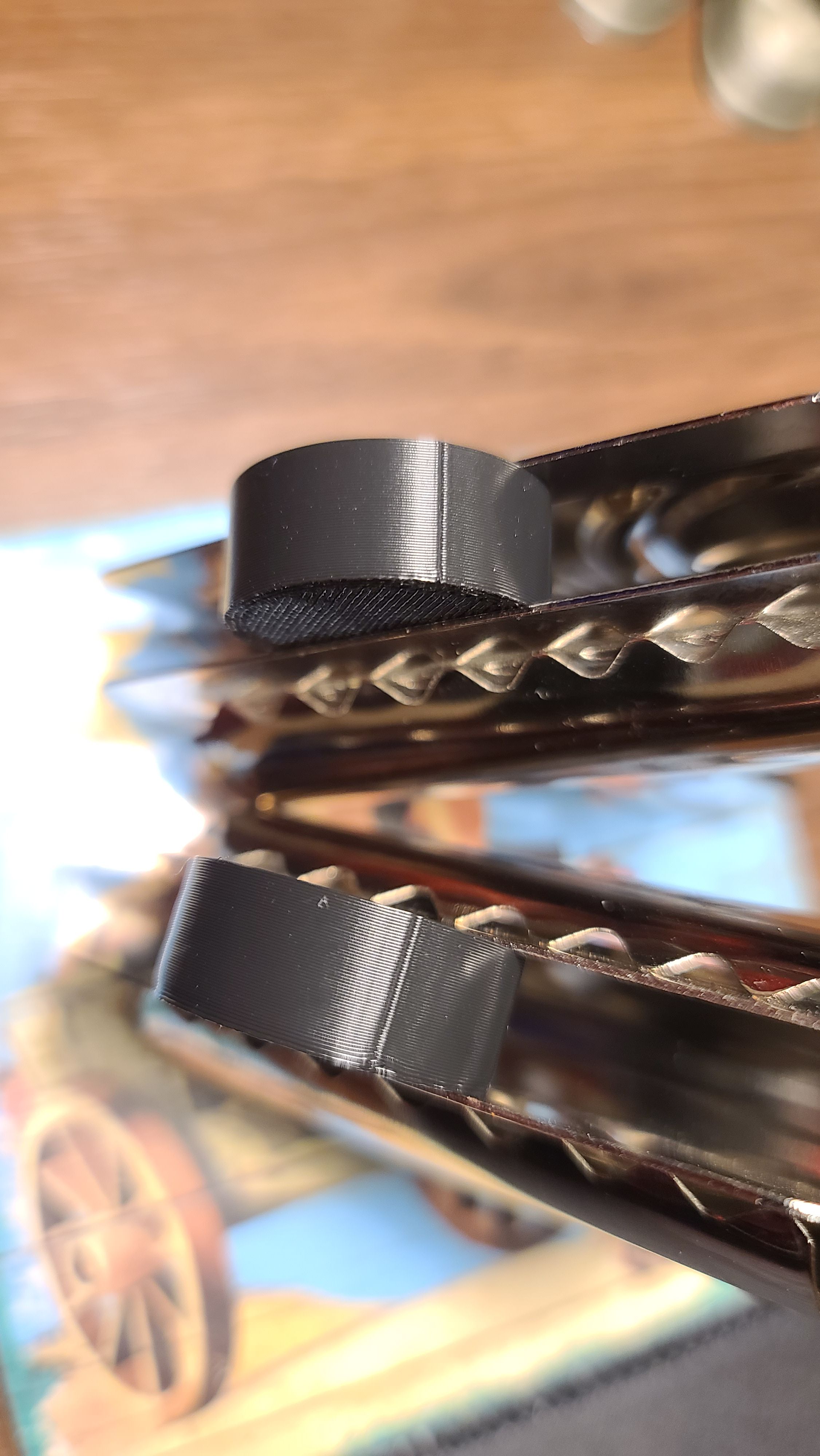

                        @dc42 We have been fighting the same issue. I haven't had a chance to update to 3.2 final, but have been actively testing all the 3.2 betas. We are drawing the same conclusions and even went as far as testing the same gCode on our old Marlin based machines, which is not exhibiting the same artifacts.
                        As of now, we've found nothing to fix this - including both jerk policies. However, I will upgrade to 3.2 final today to see if there are any changes.
                        Here is a screenshot of the render in Simplify3D.
                        And the printed model:
                          @oozebot, where that corner seam shows a bulge in your photo, I presume there was a layer change. Do you know in which direction the perimeters in those layers were printed?
                          If the bulge happens at the end of printing a perimeter, just before a retraction and travel move, then you should try increasing pressure advance.

                                          @bot Well he did try these settings: https://forum.duet3d.com/post/202855
                                          M566 X900 Y900 Z120 E3000               				; set maximum instantaneous speed changes (mm/min)
                                          M566 P1                                            ; Set jerk policy to mimic Marlin and uses jerk between all moves.
                                          M203 X12000 Y12000 Z600 E6000          				; set maximum speeds (mm/min)
                                          M201 X4000 Y4000 Z300 E3000             				; set accelerations (mm/s^2)
                                          M204 P800 T2500								   ; set print and travel accel
                                          M572 D0 S0.035 ; PRESSURE ADVANCE
                                          M207 S1 R0.0 F3000 T1500 Z0.0 ; firmware retraction
                                          I thought the results looked better, but ¯\_(ツ)_/¯
                                          I think that was only with 3.1.1 though, and not 3.2.
                                          these settings were tested again on 3.2 results was basically same as in 3.1.1
                                            Can you show a comparison photo of the results of those settings and the print from the PrusaMini?
