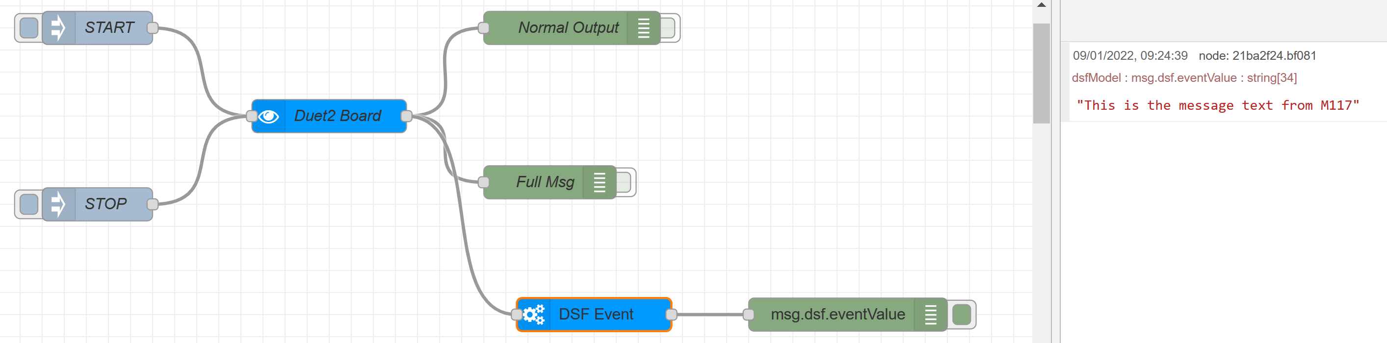

        tekstyle @MintyTrebor
        @mintytrebor
        i am using a duet2wifi with a rasp pi4 for node-red.
        • tekstyleundefined
          @mintytrebor
          i changed the type to DUET. i also changed my credentialSecret code to false. it seems to be getting something under debug window on the right now. but following your example, i can not see the OM for the command M117 "xxx". if you go to line 141, that is were STATE starts and I do not see the field for displaymessage = "xxx"
          12/20/2021, 9:32:20 AM
          msg : string[57]
          "Error loading flows: Error: Failed to decrypt credentials"

          • MintyTreborundefined
            MintyTrebor @tekstyle
            @tekstyle ""Error loading flows: Error: Failed to decrypt credentials" is a node-red error (not from NodeDSF) because you have changed your credentialSecret code configuration in your setting.js.
            The help text for credentialSecret states changing it will prevent node-red from decrypting existing credentials:
            // By default, credentials are encrypted in storage using a generated key. To
             // specify your own secret, set the following property.
             // If you want to disable encryption of credentials, set this property to false.
             // Note: once you set this property, do not change it - doing so will prevent
             // node-red from being able to decrypt your existing credentials and they will be
             // lost.
             //credentialSecret: "a-secret-key",
            Which means any ip addresses, usernames, passwords (etc) you configured in your nodes before you changed credentailSecret are no longer accessible to node-red.
            I suggest you Reset the settings.js beck to what it was before you changed it.
            The default setting is just commented out eg:
            NodeDSF - Native Node-Red integration with Duet boards.
            BtnCmd - Customise DWC with user defined buttons/layouts/panels (DWC Plugin)
            ReleaseMgr - Duet update info inside DWC.
            Repo
            tekstyleundefined 1 Reply Last reply Reply Quote 0
                @tekstyle Node-red has probably generated a new key automatically now..
                Look for a file called something like "flows_#####cred.json" in .node-red folder (the same folder as settings.js) and rename it to "flows#####_cred.old". Then restart node red.
                It will probably clear all of the node settings you have already entered, but it should clear the error.
                You will have to re-enter the IP and set the mode to Duet in the monitor node of your flow.

                        @tekstyle Great!
                        First check you are on the latest release (v1.1.4) through the palette manager, I found a bug whilst answering your query, so please make sure you are updated before going any further. (It can sometimes take a while before updates show in palette manager)
                        Then add an DSF Event node plus a debug node and configure it like this:
                        Deploy, start the monitor and send a M117 message in DWC and it should appear in the debug window (like the picture above).

                        • tekstyleundefined
                          @mintytrebor
                          i finally got this to work. that last post was a great help! thank you! now on to setting up email notification.
