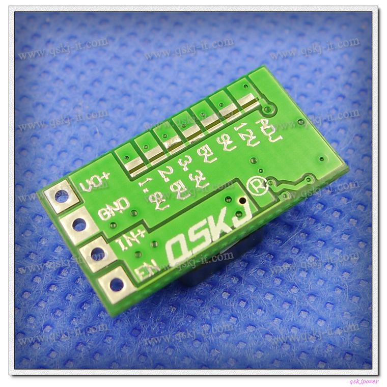

I have unbranded chinese psu which is loud and i am not comfortable leaving machine on with it. I was looking at meanwell psu's and thought, what will i need to swap if going 24V? Hotend heater? My bed is ac driven by ssr which is upto 36v.
I have 4 nema 17 and 1 nema 23 motors, would 150w be enough cause i dont need to drive the bed heater. -
To change from 12V to 24V you need to change any heater to 24V (in your case just the extruder heater cartridge(s)), also any fans if they are currently 12V fans. There are ways of using 12V fans, but it is usually simpler and costs very little to replace them with 24V fans.
A 150W PSU should be adequate if the bed heater is separately powered.
I will look into buck converters as noctua does not have 12v fans. I seen you mention somewhere how to wire it. Thank you
P.S. Here is what i found you wrote:Yes, that will work. Alternatively, if all your fans are 12V, then you can remove the V_FAN voltage selection jumper, connect the +12V output of the buck converter to the centre pin of the V_FAN voltage selection block, and connect the fans as normal.
So its a V_FAN jumper select. Then i connect step down converter to 24V PSU and 12V out to V_FAN pin with removed jumper. This is if converter is not isolated. Am i correct in this?
https://www.ebay.com/itm/2A-DC-DC-Buck-Step-down-Adjustable-Converter-Module-5-24V-to-1-8V-3-3V-5V-9V-12V/132109827948?hash=item1ec25bff6c:g:ODQAAOSwB-1YtB3B
I think this would be cheaper option and i will retain more common 12V fansBTW, i have set up printer with Prusa's induction probe and i have consistent Z where i can print without doing fine tuning each time. Probe sits too close to the bed for my liking but it works very good with consistent first layers. I just had 30h print and now running another production print which might take 90+h. Very happy all is running finally.
