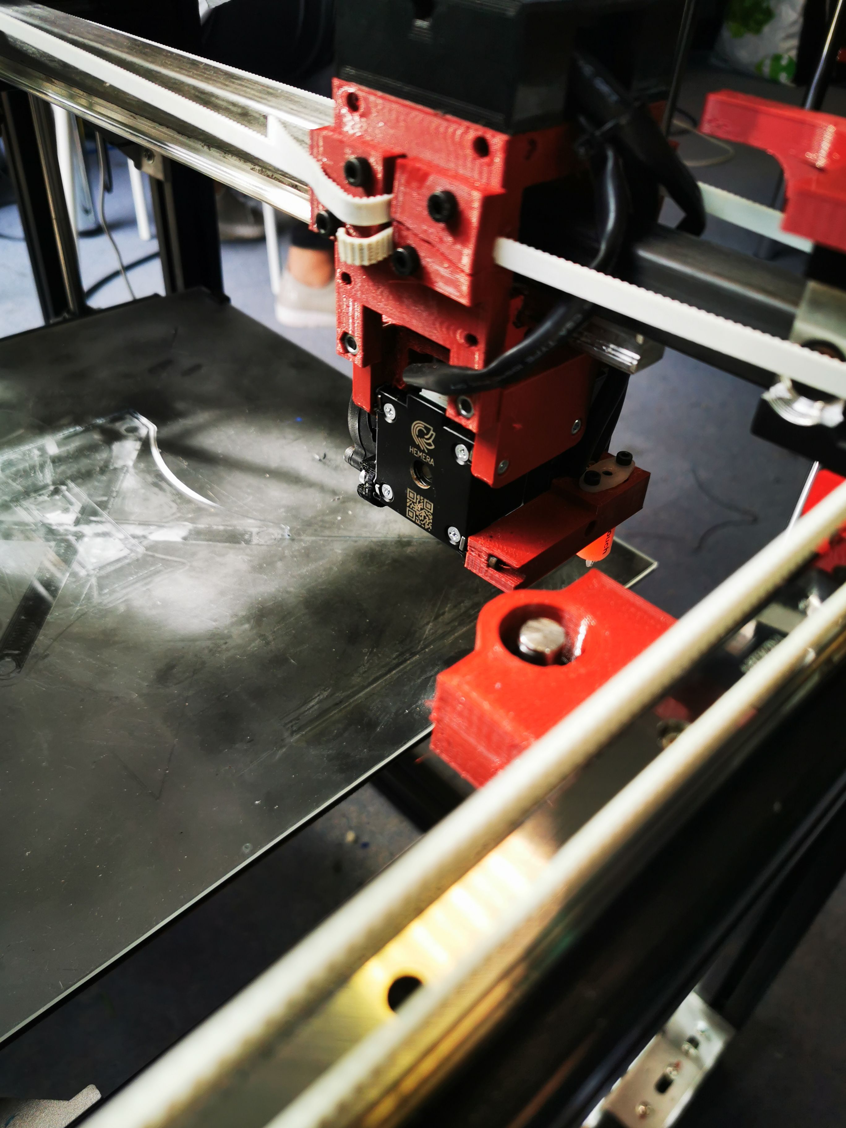

                all its mount with igus professional cable my extruder its an hemeraundefinedIMG_20211022_123851.jpg IMG_20211022_123836.jpg
                Amagatthundefined 1 Reply Last reply Reply Quote 0
                • Amagatthundefined
                  Amagatth @Amagatth
                  @amagatth IMG_20211022_132117.jpg and the bl is connected to the duet at io7

                    Because the BL touch deploys and retracts properly before you start the print I am assuming that the wiring into IO7 is correct.
                    From you configuration the input and output pins should not have a pullup resistor enabled:
                    M950 S0 C"io7.out"                                 ; Creation Pin servo Bltouch
                    M558 P9 C"io7.in" H10 F200 T25000 A1 S0.03 R1
                    The BL touch should still work initially (test this please). It will hopefully now work after doing an extrusion as well. My guess is that the pullups + the extrusion noise put it into a weird state.
                    www.duet3d.com
                    Amagatthundefined 2 Replies Last reply Reply Quote 0

                            @amagatth the next thing to try then is to route the cable separately. The BL touch cable might be picking up noise from the stepper cable and that is causing it to get into an errored state.
                            www.duet3d.com
