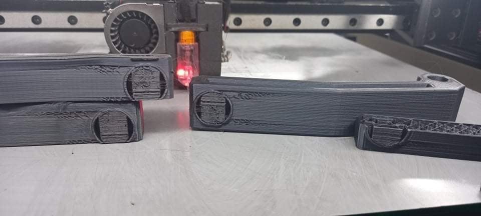

      I need some help please, so I have built a 3d printer, cartesian.
      It's all working but for one issue, whenever the extruder retracts or starts a new layer, it doesn't seem to extrude right away leaving missing lines in my print and on the first layers.
      I've calibrated e steps several times and also checked retract settings which are fine.
      I have no slipping in the gears.
      Where things get a bit stranger is that, my e steps are calibrated perfectly but it over extruders with 100% flow rate (cura) so have to set flow to 88%...howrver even at a 100% flow rate the slow extrusion at the stsrt of a layer is still presant.
      I've tested 2 brand new extruders and both same issue ![alt text](![image url]([image url]([link url](link url))))

        @craigrobbo-0 said in Help with strange under extruding on layer change:
        That isn't uncommon. Usually it has to do with the diameter of the filament and the nature of the filament itself. Just part of fine tuning.
        What are your retraction settings?
        Is this a direct drive or bowden extruder?
        Do you have retraction enabled on layer change in your slicer? I believe the default in cura is to no retract on layer change or travels. This can lead to under extrusion because the plastic in the nozzle may ooze out and it takes a while to build up pressure again.
        At any rate, we'd need to see more specifics of your setup to be able to help much more. Please share your config.g and perhaps a sliced gcode file so we can see your slicer settings.

          CraigRobbo 0 @Phaedrux
          @phaedrux
          Thank you, sorry for late reply I didn't appear to get a notification for the reply?
          So the gcode I'm confident is fine as the same gcode works fine on my other printer without this issue.
          I'll upload my config.g later.
          It seems someone suggested it's a pressure advance issue but after playing with this for a while, it made zero difference to this particular issue.
          The extruder is a biqu h2, I tried some "extra prime" settings but this helped in some places but then left lots of zits in other places...
            Is there perhaps a problem with extruder assembly?
            https://www.biqu.equipment/products/biqu-h2-v2-0-extruder
            Is the other printer the same as this one?

              Stephen6309 @CraigRobbo 0
              @craigrobbo-0 Make sure the gear on the stepper motor is tight. Pressure advance, M572, if the setting is too high, it makes my infill not reach the perimeters..
                @phaedrux said in Help with strange under extruding on layer change:
                Again sorry for late reply, I'm unsure why I'm not getting notifications?
                Any way, no 2 different printers but both are direct drive.
                So I have 2 extruders (bother biqu h2) and I stripped them down fully, made sure nothing was binding and reassembled, all looks spot on.
                Becasue the under extrusion is so consistent I wouldn't have thought it to be the extruder.
                Last night I made some more changes to my settings, reducing retract and turned off retract on layer change, but still looks just as bad unfortunately

                    So I decided to turn off retraction and the problem still persists... Pulling my hair out on this!

                        Alright so here we go:
                        I am also uploading some photos of just a few tests of some of my settings changed

                        • CraigRobbo 0undefined
                          CFFFP_leg_2.gcode
                          Here is just one of my Gcodes, one of probably 100 of the same STL 😄 ranging my speed, heat, retraction settings

                            CraigRobbo 0 @CraigRobbo 0
                            This just shows how bad they are coming out
                              I am using a BIQU H2 extruder (I have 2 of them and both do the same)
                              My slicer is Cura tried 4.7, 4.12 and 4.13
                              I have tried many of the usual expected slicer settings and some extreme settings
                              Temps from 190-230c (generally use 210c with PLA+)
                              speeds from 20mm/s up to 200mm/s (generally use 60mm/s)
                              Retractions from off upto 3mm and retract speeds of 10mm/m upto 40mm/s (generally use 0.6mm and 30mm/s)
                              travel speeds I have tried from 60 upto 400mm/s (generally use 120m/s)
                              Where things get a bit stranger is that, my e steps are calibrated perfectly (checked more than 10 times) but it over extruders with 100% flow rate (cura) so have to set flow to 88%...however even at a 100% flow rate the slow extrusion at the start of a layer is still present.
                                Is it perhaps an issue with the Biqu extruders themselves?
                                CraigRobbo 0undefined 1 Reply Last reply Reply Quote 0
                                  @phaedrux It is a possibility, I have stripped them down to as many pieces as i could and rebuilt them and they seem okay?
