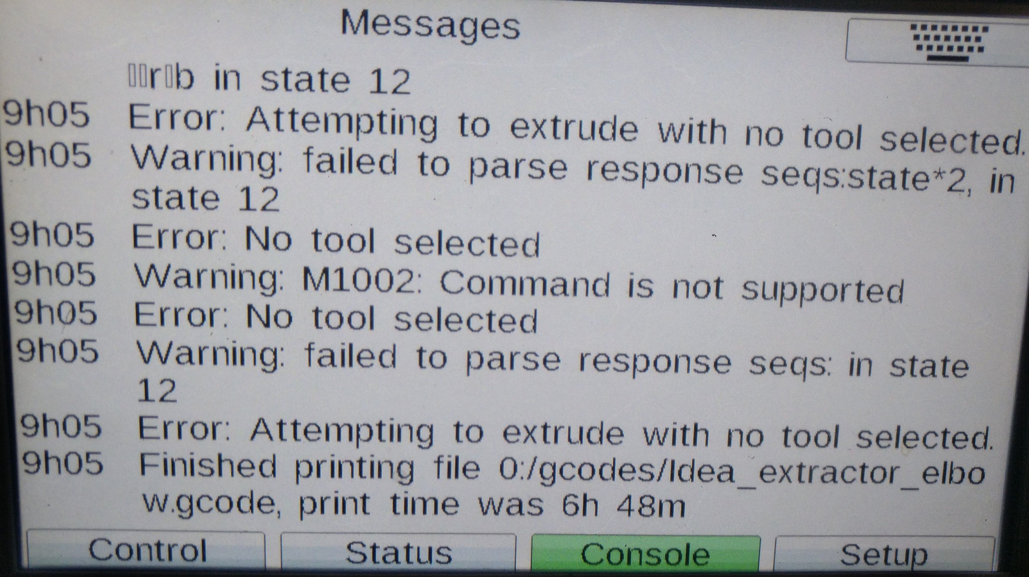

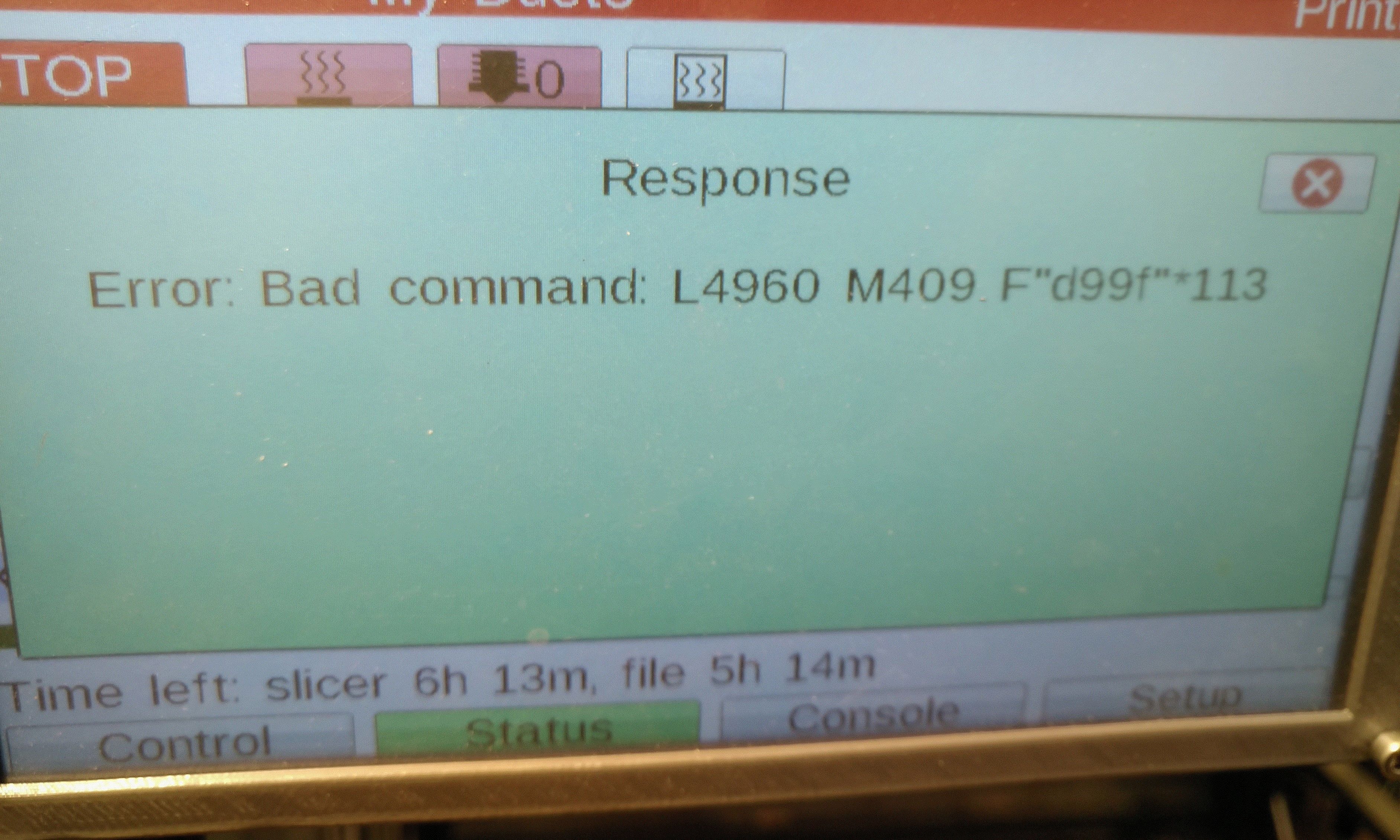

The bad command error is being picked up by the PanelDue firmware.

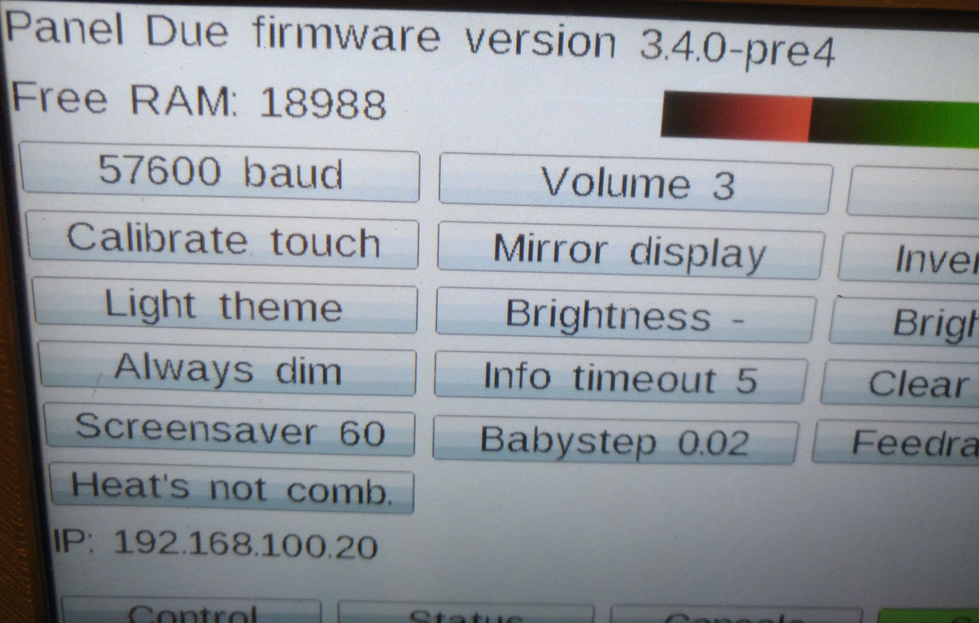

Can you please share what version of main firmware and PanelDue firmware you are using?
How is the PanelDue wired? 4wire or ribbon cable? How long? Does it run near other cables?
@phaedrux 7 "Ponel Due firmware version 3.4.0-pre4, FIRMWARE_NAME: RepRapFirmware for Duet 3 MB6HC FIRMWARE_VERSION: 3.3 ELECTRONICS: Duet 3 MB6HC v1.01, Shielded 4-core cable 1.2 meters long. Printer Interrupts nozzle heating and filament feeding, after different times. Standby nozzle temperature.

Did this start after updating the PanelDue to 3.4 pre4?
Do your wires run near other cables?
Can you please try updating to Duet firmware 3.4 RC1 and PanelDue 3.4.1 pre1?
