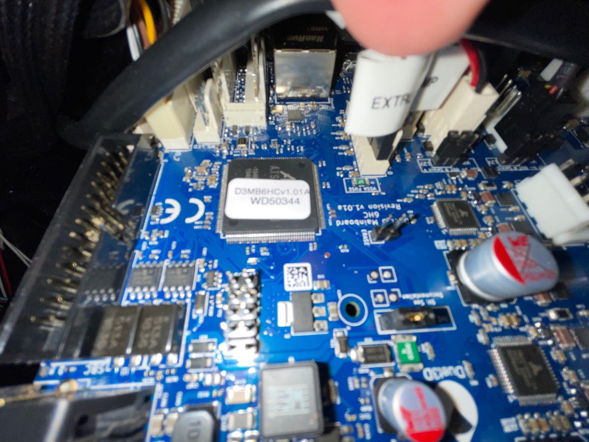

@phaedrux is the diagnostic light rite next to the micro USB port?
@phaedrux OK I used BOSSA to install Duet3Firmware_MB6HC... not Duet2and3Firmware-3.4.0 and it worked... I have access to DWC... so is it at this point I can install Duet2and3Firmware-3.4.0 or is there something else I should do to make sure I don't have another system lock up.
If you now have access to DWC you can upload the full 3.4 zip file to ensure you have all the right files in place for future updates.
https://github.com/Duet3D/RepRapFirmware/releases/download/3.4.0/Duet2and3Firmware-3.4.0.zip
Upload that zip file as is to the system tab in DWC. Don't extract it first. Once done, check the firmware version again with M115. It may prompt to update any attached expansion boards as well. You can check those with M115 B# where # is the CAN bus address of the expansion board.
Same errors as before, it is Duet2and3Firmware-3.4.0 causing the system to lock up, I'm going to start over here, this next time I will record and post a youtube video of the update as it happens. Hopefully I can glean some idea as to why or when exactly the fail happens. unless you have a better idea?
@phaedrux do you think it would help to disconnect everything from the board except the panel Due?
@phaedrux I erased the board again and then used BOSSA to re-install Duet3Firmware_MB6HC.bin. At startup the first error I get on my panel due is "ERROR Bad model parameters". Then it posts the IP address and then it posts connected.

@supertb1 looks like you haven't run M303 heater tuning on either of your heaters, so you have incomplete M307 commands.
@dc42 OK thanks... I will get that done... any idea why Duet2and3Firmware-3.4.0 is causing the board to lock up? or do you think the heater tune is the answer?
@dc42 This is what I came up with on my heater calibrations:
M307 H0 R0.395 K0.368:0.000 D5.05 E1.35 S1.00 B0
M307 H1 R4.905 K0.241:0.035 D7.64 E1.35 S1.00 B0 V24.0
Do I try and perform Duet2and3Firmware-3.4.0.zip again? or is there something else I need to do? -

Just to verify, you are uploading the whole zip file to the system tab in DWC? Correct?
Can you send M122 and M98 P"config.g" in the gcode console and copy and paste the results here?
Are you using a raspberry pi?
@phaedrux
To answer your question I am using the DWC to upload the Zip file as is with out unziping it in any way and no there is no Raspberry Pi or any other kind of USB handler. It is strictly Duet equipment in a stand alone format in the control box. Incedently I did get a good response back on the Y axis in closed loop so I am excited to get to that part. Let me know your thoughts please.

At least it looks like all of the boards are up to date now, so it did apply the firmware.
It may help to see a video of the entire firmware zip file upload process so we can see what it's doing along the way.
