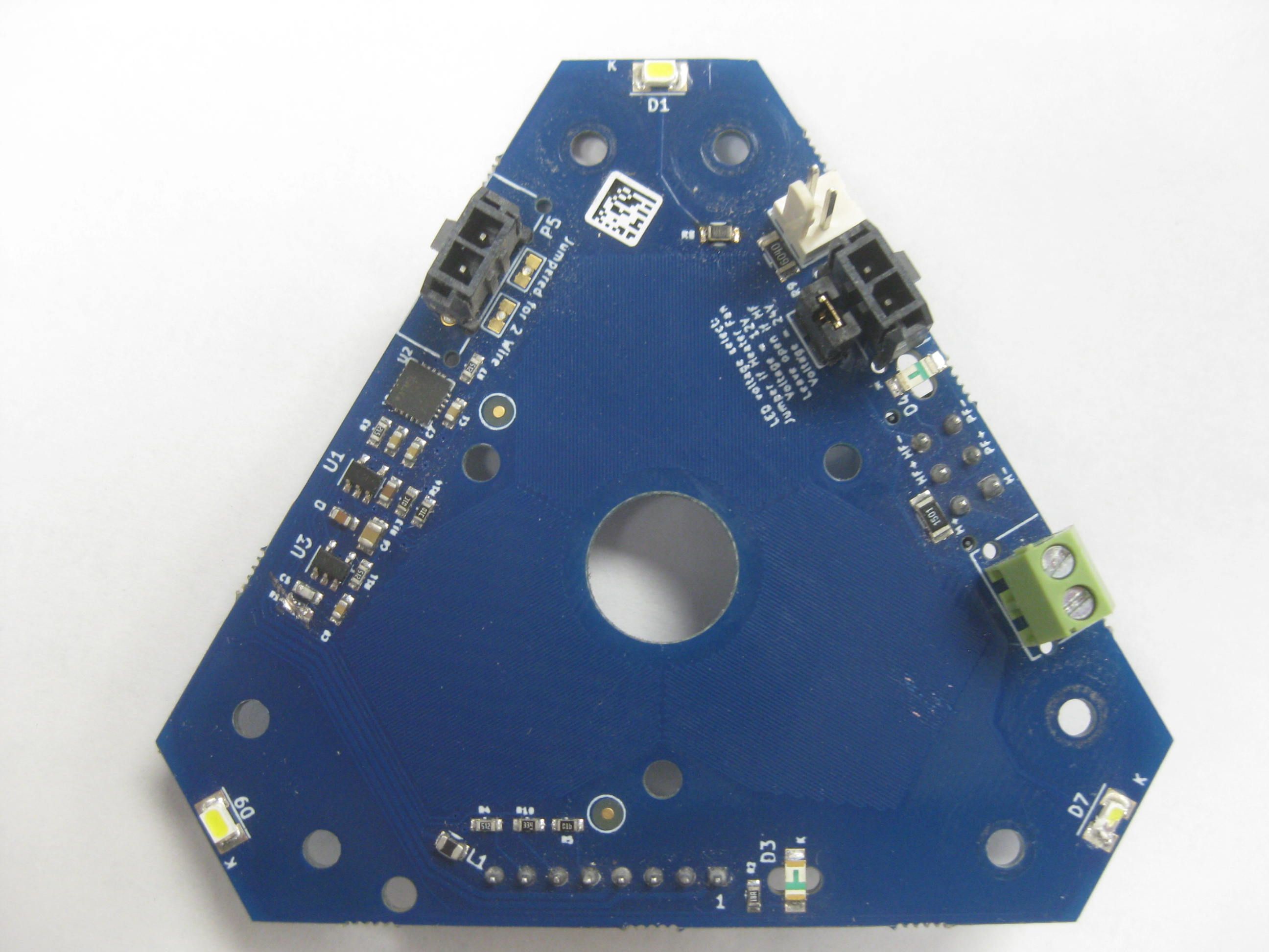

Smart effector flashing six times
When did you purchase from oozenest?
@phaedrux 26th November 2021
Can you disassemble the smart effector and snap some close up photos of both sides?
@phaedrux Will do.
@andy_m
Looks like there is some damage to the traces near the heater output -
@jay_s_uk Yes I noticed that, doesn't look like the tracks are damaged, just the blue cover but then they also look very delicate.
The damage to those traces looks like it could be the problem. They are quite delicate. Waiting to see what DC42 thinks.
Do you know what caused that scuff? I assume it worked at some point?
@phaedrux It was working fine, I'm not sure why, but the fan mount broke. (I work in a school and some of the students can be a little unreliable!) I think refitting the fan must have caused the problem, there isn't a great deal of space. I have another board like this, would it cause a problem if I covered the board with tape if I have to replace anything? Don't want to trash another one!
DC42 has confirmed that the damage is likely the problem. The traces are quite delicate.
