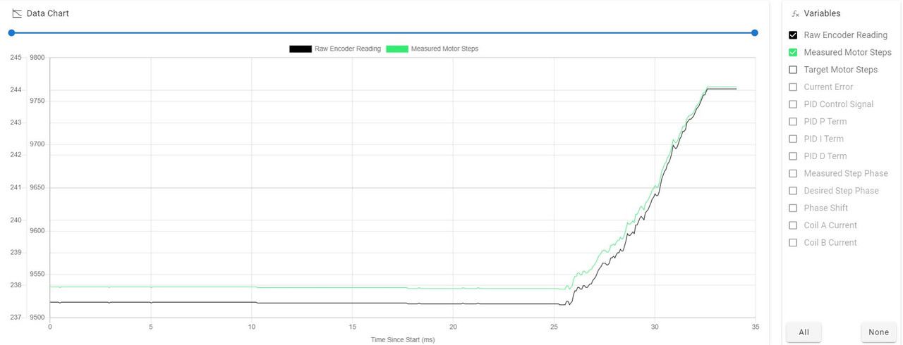

      I have a rotary axis with a Nema 17 stepper motor with a 500 cpr differential encoder with zero impulse (but as suggested only a+,b+ and power connected). Firmware is 3.4.1 rc1.
      Unfortunately I do not even pass basic tuning with this setup, but the motor moves apparently as expected (have seen this manoveur already on working motor). Might be something with the encoder? Cables are long (2m), but shielded and grounded at supply side.
      The error message is:
      Warning: Driver 123.0 warning: tuning failed
      Warning: Driver 123.0 new tuning error(s): The measured motion was inconsistent.
      Can you see what the problem is ?

        @wiego said in 1HCL basic tuning fails:
        By "power", please confirm that you mean +5V and ground.
        Is the working motor of exactly the same type?
        I'm confused by your first image because I can only see the green line for measured motor steps, but there should also be a black line for raw encoder reading.
        Which version of the closed loop tuning plugin are you using?

          yes, from the eight differential wires of the eoncoder (A,/A,B,/B,Z,/Z,5V,GND) only A,B,5V,GND are connected to the Quadrature Input of 1HCL. 24V as board supply on VIN.

          No, unfortunately the motor that has been working is another type with TTL encoder.
          @dc42 said in 1HCL basic tuning fails:
          In the first picture both lines exactly on top of eachother, that is the reason why the black is hardly visible.

            i just found out that cpr can have two meanings 😓 :
            • counts per revolution (=4xPPR)
            • cycles per revolution (=1xPPR)
            so my encoder has actually 500 cycles per revolution means 2000 counts per revolution.
            M569.1 P123.0 T2 C2.5 R100 I0 D0
            I change that to M569.1 P123.0 T2 C10 R100 I0 D0
            but recordings look still quite similar:
              dc42 administrators @wiego
              @wiego are you sure the encoder isn't higher resolution than that? It looks like the measured motor steps is too high.
              Do you get any other messages when the tuning fails? RRF normally reports its estimate of the measured CPR.
