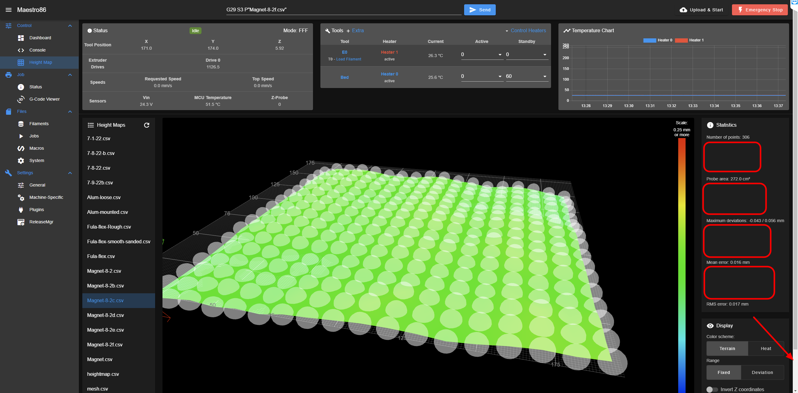

      @bilagain said in Height Map Padding:
      @ccs86 Please try either rolling your mouse wheel, left click and dragging or right click and dragging.
      That is for manipulating the graphic.
      I'm talking about the whole graphic and statistics pane size. You can see the huge amount of padding between the stats. This causes the pane to be so big vertically that it needs a scroll bar.

        @ccs86 Interesting. Gotcha. Figured you were asking based on the 'padding' around the graphic of the map.
        What browser are you using?

              CCS86 @bilagain
              Chrome
              • CCS86undefined
                CCS86
                Even at more square aspect ratios, the padding pushes data off the screen:
                Norderundefined 1 Reply Last reply Reply Quote 0

                              • CCS86undefined
                                CCS86
                                • CCS86undefined
                                  CCS86
                                  By changing this character to a 0, it collapses the text. This seems to show that the text is just trying to fill an over-sized pane:
                                  • CCS86undefined
                                    CCS86
                                    Okay, I think I figured out what is going on:
                                    • The statistics pane wants to scale vertically to match the height of the tallest pane
                                    • The middle heightmap pane is set to a fixed aspect ratio, so when the window is in a very wide aspect ratio, the middle pane gets very tall and forces the statistics pane too tall
                                    • The left pane which lists your saved height maps also auto scales height taller when the list gets long, so it can also force the statistics pane to be too tall
                                    Screen recording that shows the issue dynamically:
                                    2022-08-04-11-07-59.mp4
                                    I'm not sure what the cleanest solution is here. Maybe DWC could lookup the current monitor aspect ratio to decide which aspect ratio the height map pane should be.
                                    It would also be nice if the height map list pane was scrollable itself, instead of autosizing and forcing the other panes to be too tall to fit.

                                        • Sindariusundefined
                                          Sindarius @jay_s_uk
                                          @jay_s_uk I rewrote the 3D component of the heightmap plugin which replaced ThreeJS to BabylonJS which is used for the G-Code Viewer. It does come down to adjusting how the controls layout and resize in code.
                                          CCS86undefined 1 Reply Last reply Reply Quote 3
