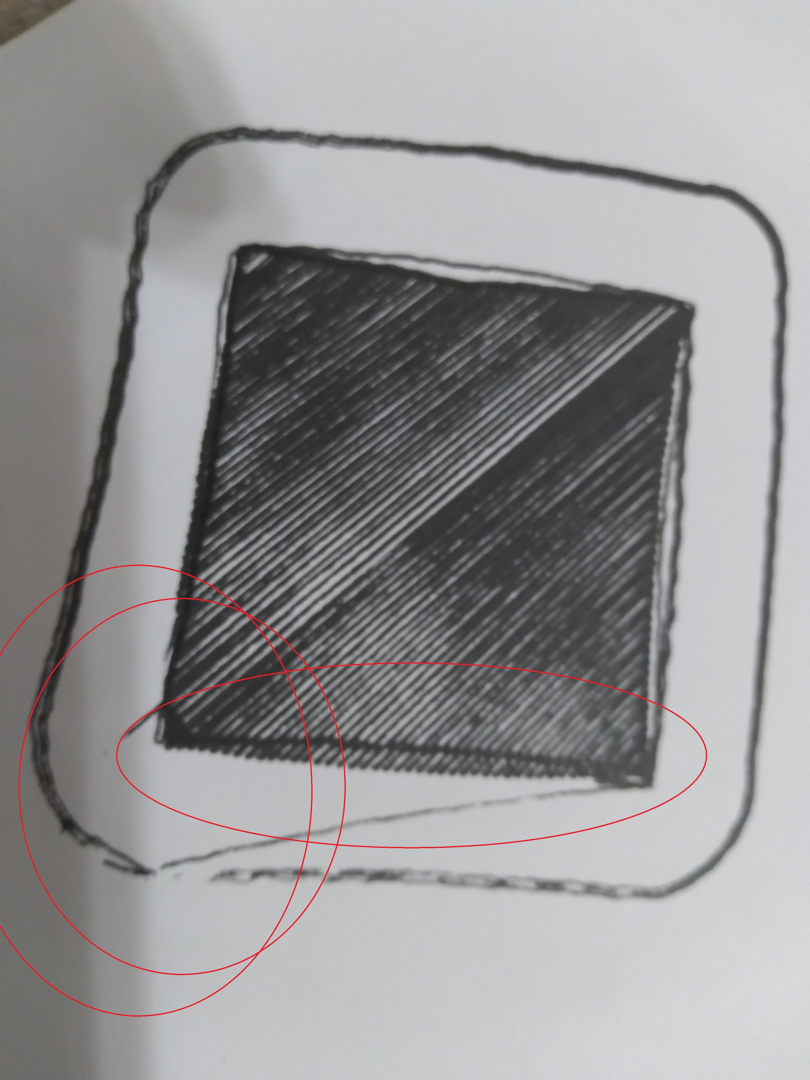

      Hi All Hope I will to find some help here , I have built polar 3D printer with reprap firmware however I am unable to find out why the shapes the machine draw or print are not exact, currently I am using below configuration file as this polar machine however without bed and it rotates around the center like flipped L shape .
      The problems I am facing are the following
      1- round lines some how straight lines are not coming out exactly straight it has some round areas
      2- one corner when i print square it is coming off not as the others
      3- infill is offsetting of the actual frame that printed and I feel it tries to compensate the initial mistakes
      Attached is picture of the out put, hope to find help here20220925_194246.jpg

        @shadi_polar I think the first steps would be to make sure that your printer is actually configured how you think it is. In a console please enter: M98 P"config.g" and post the results here. Some of the settings you have seem a little strange in particular the S parameter to the M669 does not seem correct, I can't imagine what 0.01 segments per second would mean.
        I'd suggest that you should probably move the M669 command to be before you specify any other movement configuration. So I'd move it to be just after the M584 command as shown in the examples here: https://docs.duet3d.com/en/User_manual/Machine_configuration/Configuration_Polar
        It would also probably help if you posted a picture of your printer (or a video of it in action) so folks have some idea what it is you are using.

          Hi @gloomyandy I appreciate your help on this below the outcome of M98P "Config.g", I agree with you some information might be strange in my Config.g file like the S because I added it without exact knowledge of the functionality so I thought that might Improve the result. but i do not know the actual value I should add :).
          Actually this is an old project i never finish as not dedicated to however since i am working on again i would like to know how should i move on below is a picture of the machine as i was not able to upload video due to the size
          I uploaded while the machine in action however if you notice that the circle is not exactly circle it looks like defected circle you can tell however in the square it is more clearer
