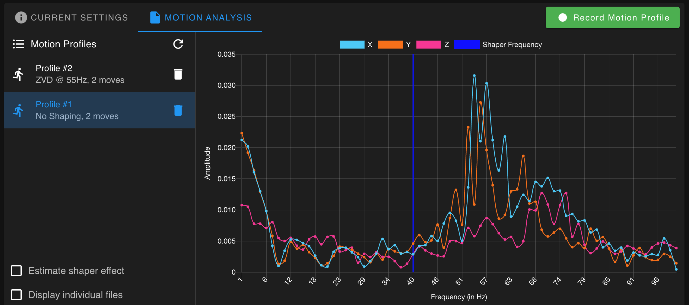

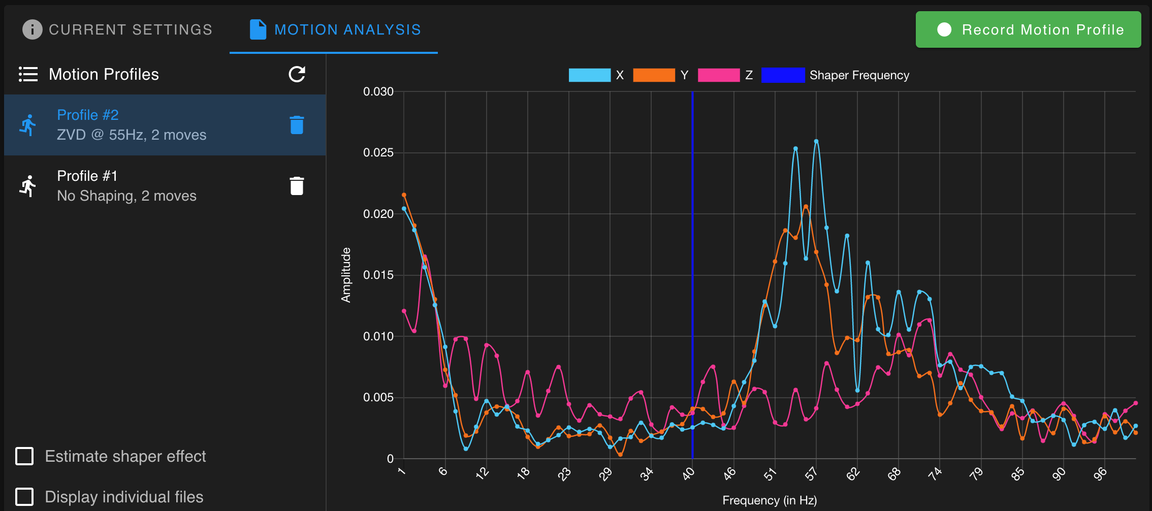

      Hello I had install the accelerometer on my home made delta (R400 H500) printer:

      Now I'm trying to understand how it works, This is without filter:
      and this adding the filter that some testing I think have the better results:

      My questions are:
      1. Why the does the filter acts so little?
      2. What is damping factor?
      3. How can I do to make better results?
      Thansk!
        dc42 administrators @samu_87
        @samu_87 what M566 settings do you have for X and Y in config.g? High values make input shaping less effective. The default value of 600 works well on most machines.

          @dc42 i have X600 and Y600
          I add my config.g maybe it can be useful
