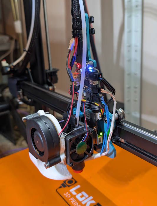

              Just a brief update on this conversion. I could never get a good consistent first layer, the mesh bed levelling just did not seem to work as expected. Other threads discussed this but it's possibly down to the z probe offset from the nozzle and less than perfectly square construction. After spending far more time than I would have liked trying to work around this, I decided to swap the print head and z-probe out.
              I already have a printer using one of the dyze designs horizon z probes and this had solved bed mesh levelling issues on that printer so went with one of those along with an e3d revo roto extruder/revo hot end with a high flow hardened nozzle. Having the nozzle act as the z probe get around any issues with an offset z probe.
              I modelled up a new mount to fix to the x axis gantry and had this cut out of aluminium along with an adapter to attach the extruder to the horizon probe.
              This solution has solved the mesh levelling and now the first layer is consistent. The total weight of the new print head is within 10g the same as the original.
