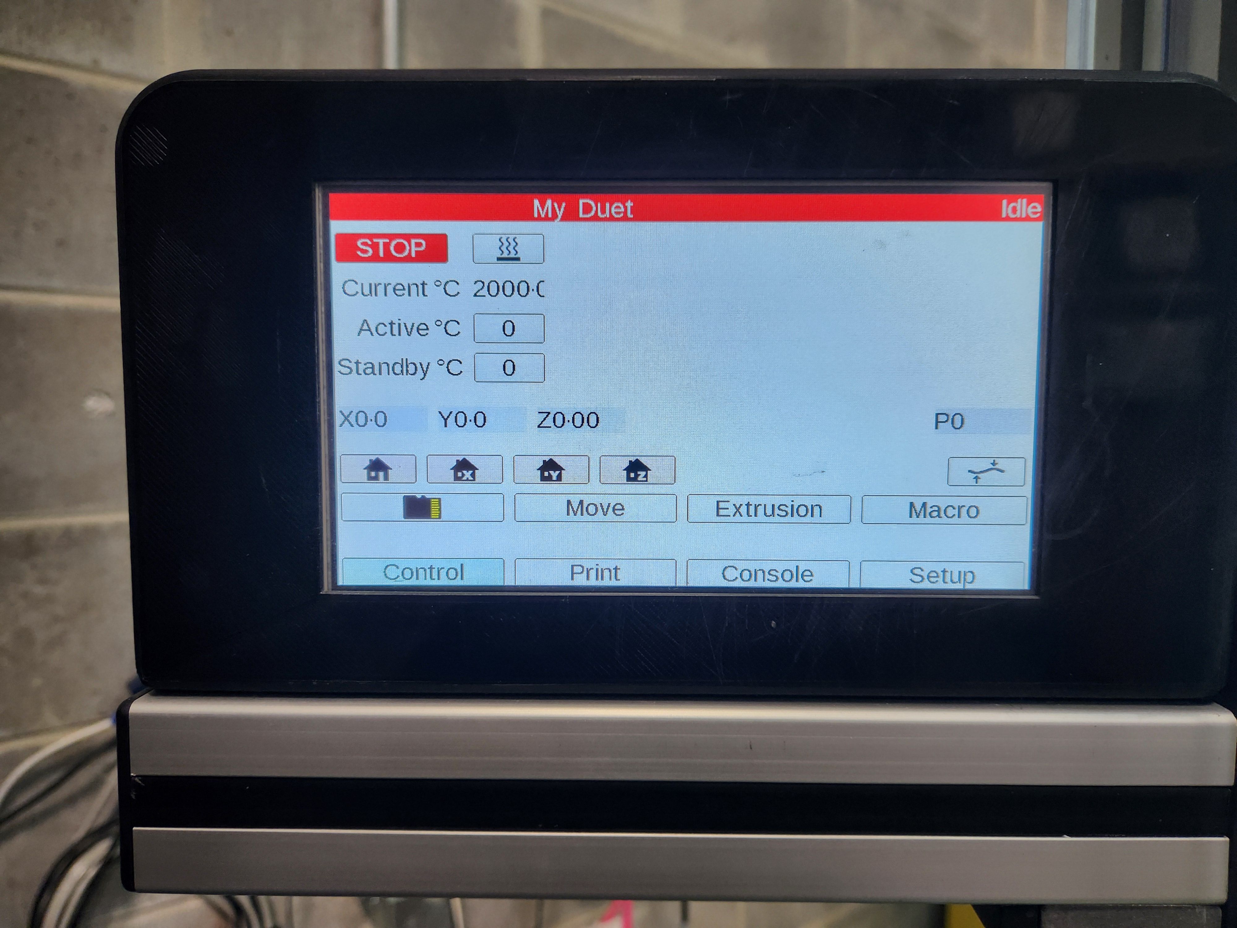

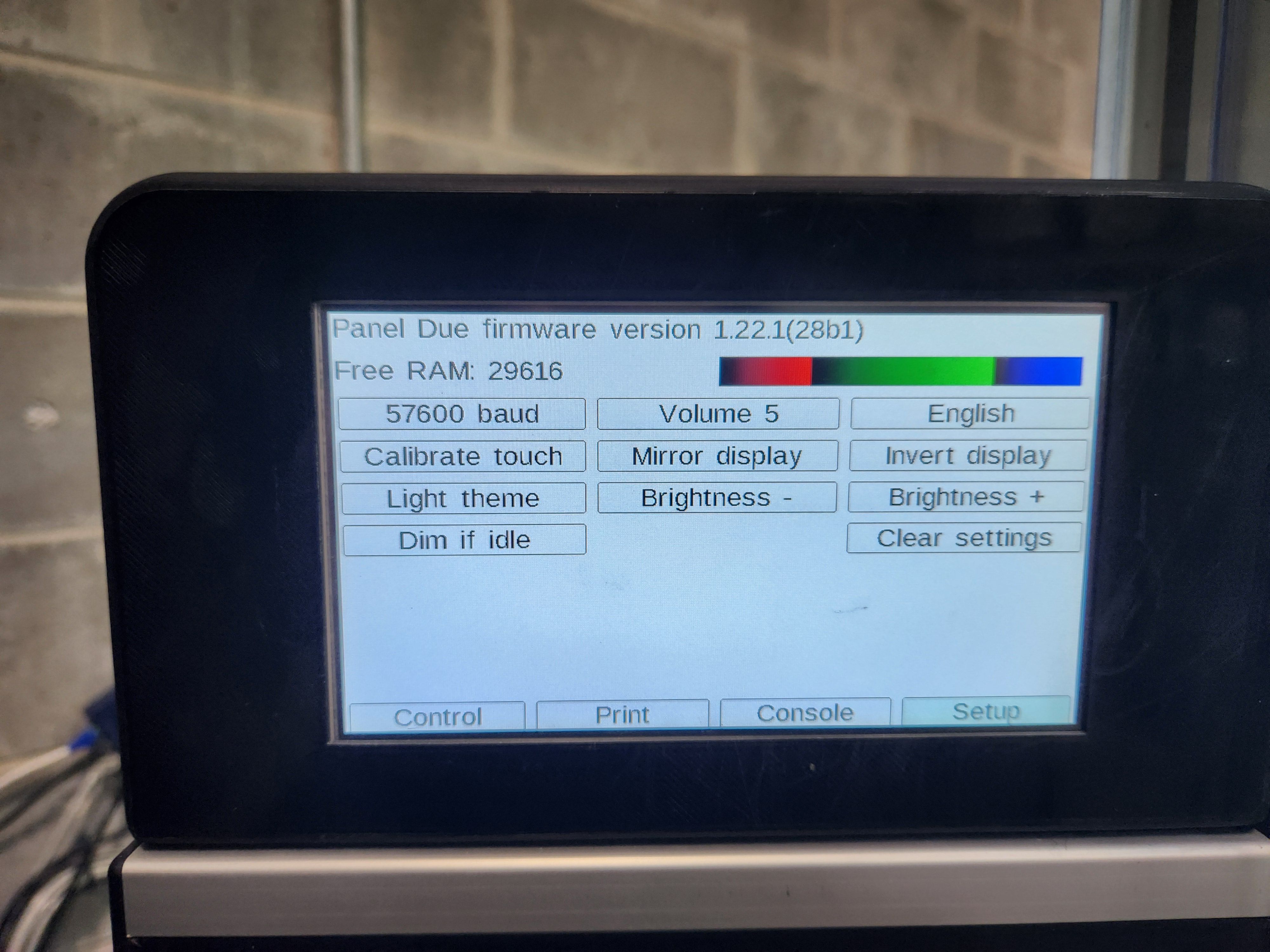

We are running the Duet 2 for our Frog 3D Printer and out of nowhere this morning when I booted it up there was instant problems. The first thing that I noticed was that it was reading the Bed temp at 2000, typically this happens when a thermistor is busted. I start feeling panic when I notice that half this screen is void of information. I think something must be wrong with the screen, but I can go to other pages (like set up) and have no issue.
It starts to dawn on me that it never brought up the message "Connected to X IP" I check the IP and find its unable to connect. I've tried restarting it several times, tried changing the Braud which did change the thermistor reading back to zero but ultimately never connected.

@Gage-Pritchard it sounds more like the config.g has not been read. Check the SD card is properly located in the SD card socket. Remove it and check it is readable in a PC. If you can connect via USB, you can collect an M122 report, and run the tests described here: https://docs.duet3d.com/en/User_manual/RepRapFirmware/SD_card#troubleshooting-sd-card-issues
