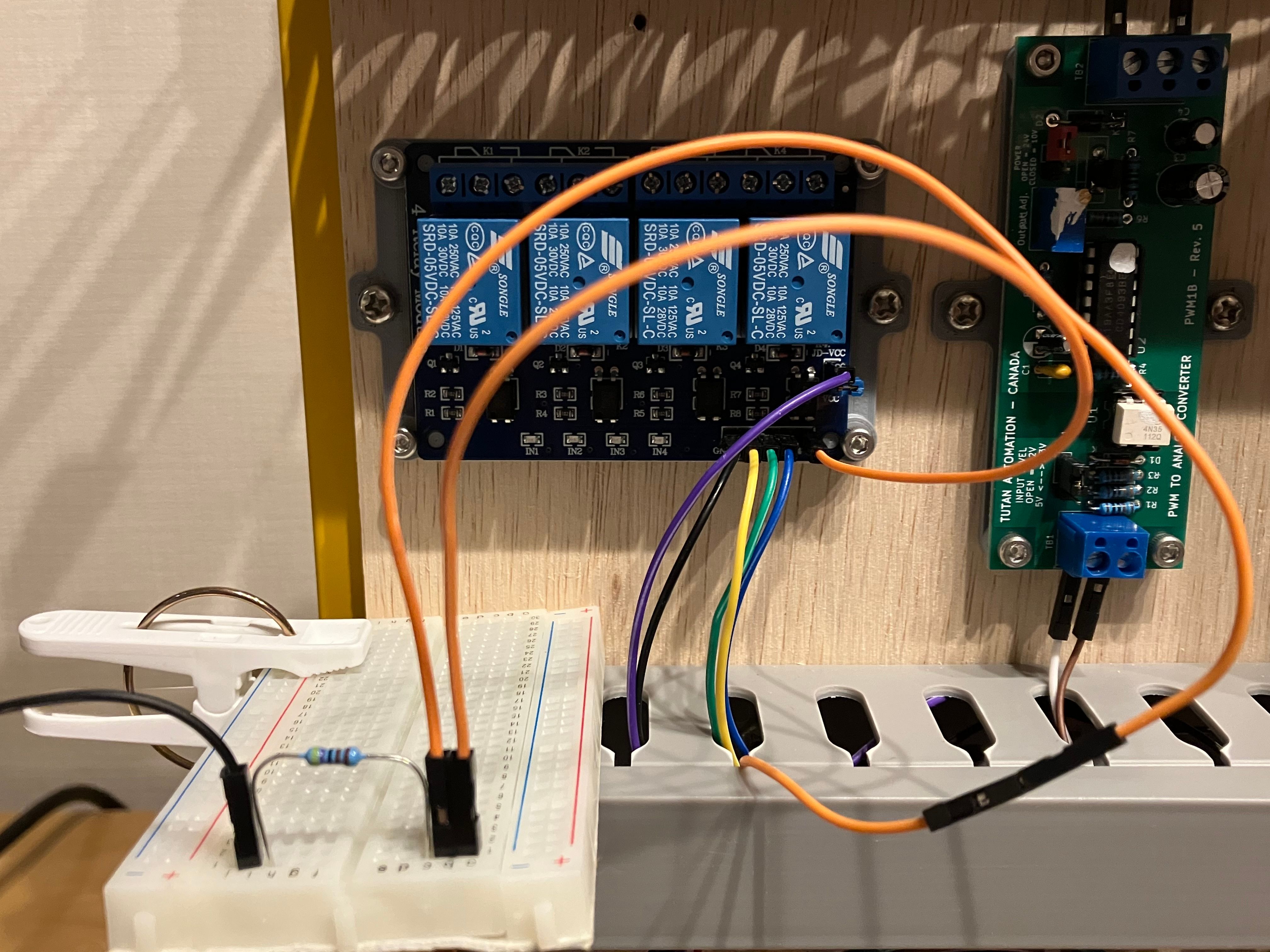

            @T3P3Tony I managed to get this work by...
            [PANEL DUE 5V_EXT] === Relay board VCC
            [PANEL DUE 5V_EXT] === 4.7K Ohm === [24V PSU -V]
            If I do...
            [out3-] === Relay board [IN1]
            [out3-] === 4.7K Ohm === [24V PSU -V]
            The relay will enable when powerup, and remain on when power lost for a long time (probably until PSU completely dry)
            Did I do something odd?
            Thanks in advance!

                    I now have...
                    No external 5V PSU, all power by Duet's 5V.
                    Duet [PANEL DUE 5V_EXT] === Relay board [VCC], which jumper connect to [JD-VCC] to power coil
                    Duet [GND] === 24V PSU [-V] === Relay [GND]
                    Duet [out3-] === Relay board [IN1]
                    Duet [out3-] === 4.7K Ohm === 24V PSU [-V]
                    And relay enabled as soon as power on.
                    I check the relay board's schematic, and I think it's neg-side-controlled. So having pull-down on the [IN1] actually ground the [IN1] and cause it enable instantly at powerup.
                    So if that the case, having pull-down on the [VCC] is actually kind correct?
                    infiniteloopundefined 1 Reply Last reply Reply Quote 0
                    • infiniteloopundefined
                      infiniteloop @titusou
                      @titusou
                      Referring to the KY019 schematics and the image above, you need to separate the logic level (3.3V) from both the input voltage the relay requires (5.0V) and the relays-controlled voltage (24.0V). With the JD-Vcc jumper in place (as spotted in the photo), the logic level requires 5.0V, which will not work, as the Duet-I/O uses 3.3V instead.
                      Remove the jumper JD-Vcc, feed 3.3V from the Duet into Vcc (labelled ”Vcc connect to Rai 3.3V”), feed 5.0V into JD-Vcc (labelled ”JDVcc connect to relay power 5V”). Possibly, you can forget about the pull-down resistor.
                      Oh, and don’t waste any further thought on whether or not to connect the V- of your PSUs: They need a common GND.
                      titusouundefined 1 Reply Last reply Reply Quote 1

                        @infiniteloop I got it works as you described. Thank you!!!
                        Some detail for future reference.
                        Duet [PANEL DUE 5V_EXT] ==(orange)== Relay [JD-VCC]
                        Duet [PANEL DUE 3.3V_EXT] ==(green)== Relay [VCC]
                        Duet [PANEL DUE GND] ==(black)== Relay [GND]
                        Duet [out3-] ==(yellow)== Relay [IN1]
                        Duet [out4-] ==(blue)== Relay [IN2]
                        Duet [out5-] ==(brown)== Relay [IN3]
                        config.g
                        ; Laser mode
                        M452 C"out6" R255 F200 ; Enable Laser mode, on out6, with max intensity being 255, and a PWM frequency of 200
                        ; FAN-as-IO setup
                        M950 P0 C"out3" ; Red Laser
                        M950 P1 C"out4" ; Laser Enable
                        M950 P2 C"out5" ; placeholder
                        No strange behavior during power on nor power lost. Everything looks good.
                        Note: the board next to relay is isolated PWN to 0-10V converter, in case someone wondering.
