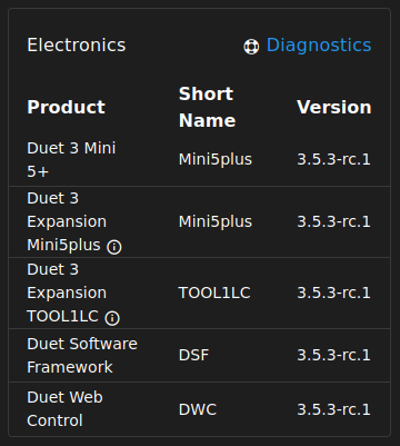

                                            Thanks @chrishamm, my entire system is now running 3.5.3-rc.1 as shown here
                                            Unfortunately @dc42 I'm getting the same bug as before:
                                            05/09/2024, 14.02.03 -Error in start-up file config.g line 156: M569.7:
                                            05/09/2024, 14.02.03 -Error: M569.7:
                                            Interestingly, I don't see these errors after power cycling the board and the SBC. That error only shows up when I do an emergency stop or chose "restart mainboard" or "run config file" after editing the config file. Although I guess I'm not getting those messages after a power cycle because DWC starts up only after the error, so doesn't show up in the console?
                                            @dc42 also, I just realized that my particular issue was never mirrored on github - or mentioned in the release notes - so now I'm wondering if this issue got confused with this one?
                                            Looking through the changelogs of previous releases, I see this limitation mentioned for 3.4.0RC1 but it's never mentioned again:
                                            M569.7 (configure driver brake port) is supported, initially on the main board only
