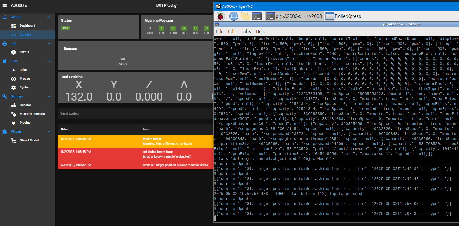

      I am trying to capture the messages from DSF/DCS like DWC's Console:
      And things like syntax errors, echo strings from meta code, etc. Basically, I want to create my own "Console" within my app so I don't have to use DWC concurrently with my app.
      I assume I would create a signal with a dsf-python function that gets raised when a message is sent from DSF/DCS, then have a function to parse the message when triggered?

              I have the example running and I'm watching the stream. I have set it to intercept "everything" (removed filters from the InterceptConnection call).
              With the example program NOT running, if I execute an G90 G1 X-10 F6000 while X is at 0mm from the DWC Dashboard tab, I get "Error G1: target position outside machine limits" banner message and it goes to the Console. All correct as my X limit is -1mm.
              With the example program running, if I execute an G90 G1 X-10 F6000 while X is at 0mm from the DWC Dashboard tab, The "Error G1: target position outside machine limits" banner message does NOT display in DWC nor in the Console, and the example app receives the following:

              So the error response is being redirected away from DWC, but where is it going?
              Looking at the responses, I can't decipher if one of those is the error message. They all just look like G and M code intercepts that are confirmation that the DCS received the command. Is there a specific flag or function for errors/faults?
              Is the error trapped in the M121 response? Is it the "majorNumber":409 or "flags":4900 keys? If so, is there a lookup table for these values? I didn't see anything on Github.

                    @rero unfortunately, your assumption is incorrect. I am asking about those messages that are not a part of the object model. I have been capturing the object model for 2 years now with my custom app and I am looking to be able to disable the DWC once I can get the error messages read by my app. I am creating my own "DWC" that is custom to my application (which is not a printer).
                    The object model messages do not include the "error (RED)" or "warning (YELLOW)" type of messages when there is an overall problem with the system, i.e, any yellow or red message that pops up on the DWC as a banner on the bottom of the DWC webpage or itemized in the Console page/tab as they occur.
                    From what I can tell, when an error occurs in DSF, the message is "pushed" out there. I need to know where "there" is so I can capture it. I believe the intercept example you and @droftarts sent has me on the right track but I'm still missing a piece of the puzzle.
                    If I send a non-supported G code from my app, the DWC reports with a yellow warning as an non-supported G command. If I sent a poorly formatted G command, the DWC reports with a red error message with the issue with the command. Neither were sent by DWC yet both were captured as a warning and error by DWC. So something else is at play than just the reading the OM.
                    Running the intercept example as .PRE or .POST will stop the DWC from reporting those messages. But I can't see within the intercept responses the error message itself unless it is what I mentioned before and there is a lookup table in DWC to textualize the error from the reported code.

                        @davidjryan That isn't quite right. DWC receives many code replies via the messages array of the object model, at least if they originate from system macros or job files. If you need results of all G-codes (e.g. also from HTTP, USB, or other channels), you should intercept executed G-codes using the IPC API. When you receive them, they should have the result property set which is what you seem to be interested in. Running /opt/dsf/bin/CodeLogger -t executed displays all executed codes, too.

                                  I've created a function to subscribe to the OM. It sees some of the error messages but not all of them.
                                  From the DWC Dashboard:
                                  1. When I try to overtravel an axis, the message comes through to my app and the DWC console.
                                  2. If I try to set a global variable that doesn't exist, the message does not come through to my app but it does show up in the DWC console.
                                  3. If I try to run a macro that doesn't exist with M98, the message does not come through to my app but it does show up in the DWC console.
                                  The terminal screen on the right shows just the 'message' portion of the OM patch once I receive the full OM on the first call, I didn't want to dump the whole patch on each patch iteration, just when a new message shows up.
                                  The DWC console "sees" everything, my app only saw the target position error.
                                  Does the source of the command call to the DSF matter (my app or DWC) in determining where the message goes?
                                  chrishammundefined 1 Reply Last reply Reply Quote 0

                                    @davidjryan It really depends on what you actually need to capture. In summary:
                                    • G-codes are targeted in SBC mode. If you send a code request, e.g. from DWC, you get back a corresponding reply when the request finishes
                                    • This may not apply for codes that are invoked by following macro files. Those messages are output as generic messages (via the OM)
                                    • Messages generated from codes that are part of system/trigger macros or print files are sent out as generic messages as well (via the OM)
                                    If you need to capture ALL error messages, you need to intercept ALL codes in "Executed" mode and inspect their result whenever they come in. I suggest you have a look at the CodeLogger utility and check if that is what you want.
