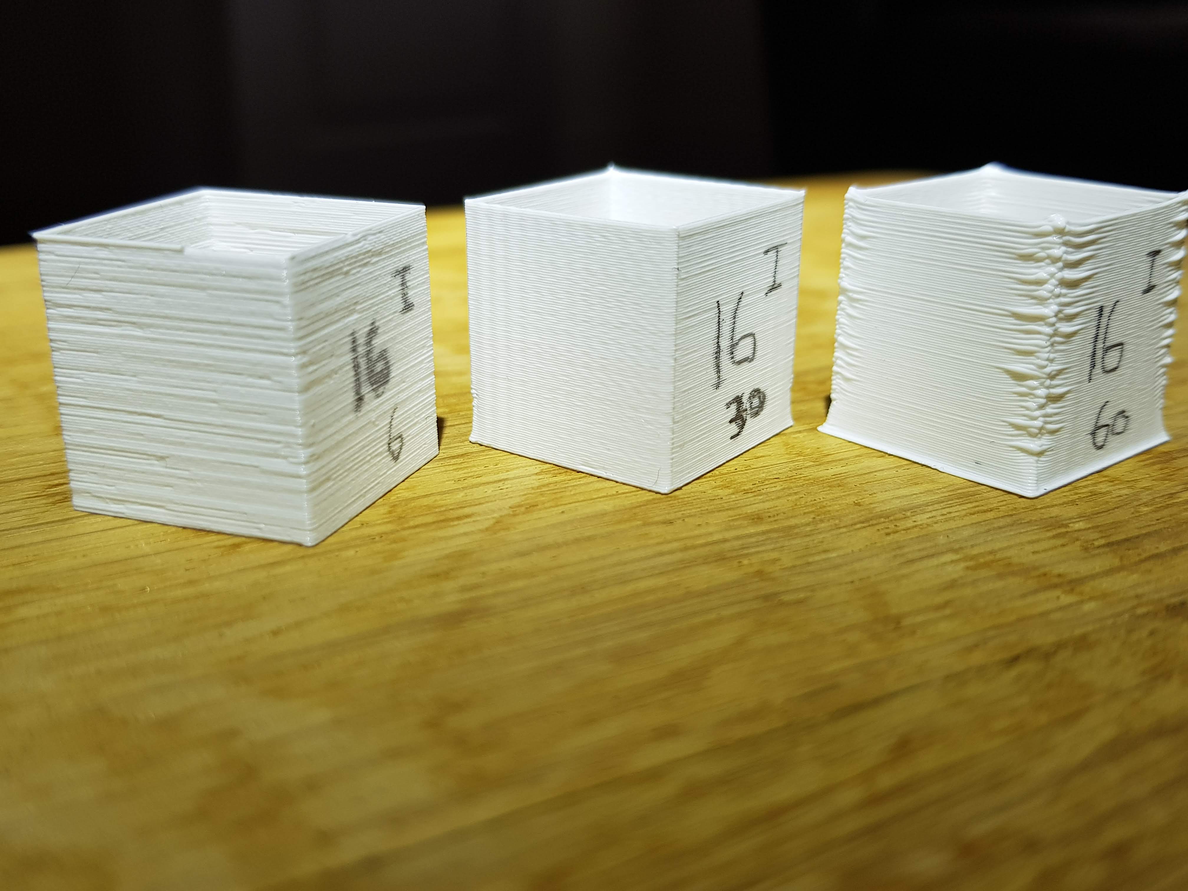

    Can anyone help with these print quality issues

        @janko Till now, I've been using x16 with interpolation. It was only when doing this testing that I noticed x16 no interpolation causes the pulsing that was quite noticeable on touch.
        Have nearly finished the test prints at each microstepping setting so will show some pics soon of the problems I'm trying to overcome.
        Do you have any values for the things you're talking about - travel speed for example? Mine is set to 150mm/s..

          I've updated the OP and added some pictures of my test prints.

            1. Id suggest you leave the motors at 1/16th with Interpolation to 256
            2. Have you calibrated the esteps per mm on your extruder motor ?
            3. On the X Y motors ?
            4. You're positive you have the correct esteps setting for your Z leadscrews ?
            5. This looks like extrusion calibration and retraction calibration ...
            6. Bowden or Direct drive extruder ?
            A. Use "matts hub" extrusion calibration guide to make absolutely sure your extruder esteps are accurate, very accurate.
            B. Make sure you have your extrusion multiplier in slicer set right.
            C. Run some retraction test prints - share those pics
            Find one that prints in under 45 mins ... this one scaled to 200% works pretty quick around 45 mins
            link text
            D. Run X Y Z ... 20 mm cubes - share those - with your best retraction and Pressure advance settings. after C above.
            E. <---- this should prolly be before C. ... run a temp tower on this material to find the near lowest possible temp you can print the material. Use that temp for the retraction tests and maybe even 5C less at the very tips of the retraction test model.
            for now maybe run all these tests at 30-40 mms speeds [ 20 mms 1st layers, external perimeters at 50% of main speed setting ]
            Drammyundefined 1 Reply Last reply Reply Quote 0

              Drammy @SputnikOC3d
              Hey @sputnikoc3d
              Thanks for the msg. In answer to your q's..
              • list item Id suggest you leave the motors at 1/16th with Interpolation to 256
                • Yeah, will do.
              • Have you calibrated the esteps per mm on your extruder motor ?
                • Yeah, I've run e calibrations a few times but happy to go over it again. Thanks for the link, it looks a good article!
              • On the X Y motors ?
                • Yes, I've found they were stepping a little over 100mm on the 100mm length test I ran and had adjusted these.
              • You're positive you have the correct esteps setting for your Z leadscrews ?
                • I believe so, it is a 8mm per revolution lead screw with a 1.8 degree stepper which at 1/16th should equal 400 steps. Have I got that wrong?
              • This looks like extrusion calibration and retraction calibration ... Bowden or Direct drive extruder ?
                • Direct drive (Flexion extruder and hot end) with e3d's 'Compant but Powerful' motor.
              I've got some IGUS bearings and some anodised aluminium rods coming soon so I will put them on the printer and then look to run through the steps you've posted.
              I noticed in the config.g the extruder max speed and acceleration looks high compared to the other steppers - is that right?
              SputnikOC3dundefined 1 Reply Last reply Reply Quote 0

                  I had an issue like this on my old Prusa, I changed settings, calibrated, tuned current, tweaked everything. In the end it was a mechanical problem. One of the horizontal rods that my x carriage rides on had come loose in the mount. I guess what I am trying to say is always look for the obvious first, sometimes we overlook the easy stuff because it looks to easy.

                      From what I see its definitely a rigidity / extrusion problem.
                      If you want to see significant alteration by changing interpolation you should test a complex gear in vase mode, but after checked rigidity and calibrate your extrusion.
