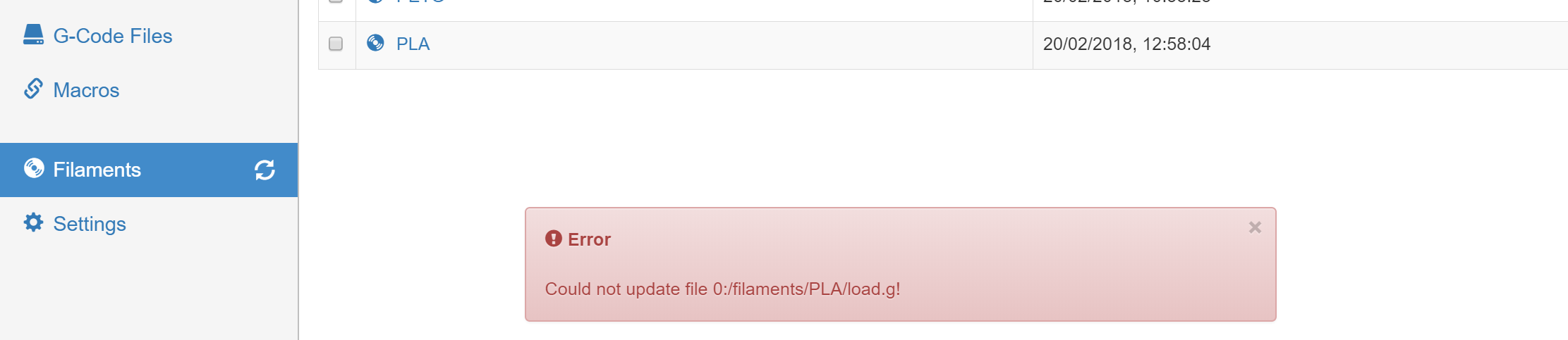

      So I have had some issues with DWC 1.21.1 and sorted them, so i feel this is more of a "bug report"
      The first is that it would only stay connected for very short periods of time and on re-connection "machine status" and "Heater temps" would only update sporadically.
      Also I could not save/update any filament configuration files or macros.
      All of this was solved by rolling back to 1.21 although this could not be done via DWC as it just reported errors when uploading the zip file.
      Since going back to 1.21 it seems that the wifi connection is more stable.

            I guess you mean you upgraded to firmware 2.0 then? There isn't a firmware 1.21.1 for the Duet WiFi.
            • Milesyundefined
              Milesy
              Yes. I upgraded to 2.0 and as far as I can tell there are no problems with it.
              My issues are with the DuetWebControl-1.21.1.zip and the problems that has had in my origional post. I am now doubting if I should have used this at all?
                dc42 administrators @Milesy
                Does reverting to Duet Web Control 1.21 help?

                  Reverting back to 1.21 solves all the issues and anecdotally my WiFi connection has improved.
