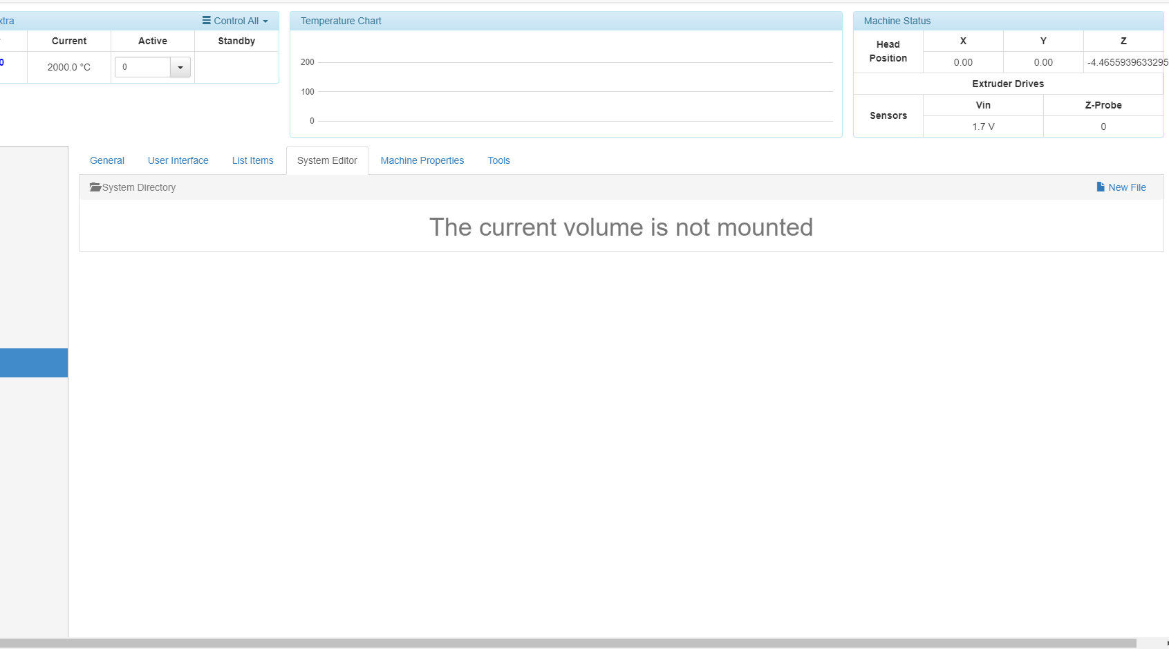

        I've been able to connect to the board now through YAT and the Duet WebControl. Unfortunately when I connect through Web Control and go to System Editor, nothing is there
          Which firmware version did you install? The Settings/General page of DWC should tell you what you have.

                Perhaps the /sys folder is missing from the SD card?
                What happens if you send M21 from the GCode Console page of the web interface?
                • CyberDustinundefined
                  CyberDustin
                  I'm getting this M21 SDHC card mounted in slot 0, capacity 3.98Gb<LF>ok<LF>
                    In that case the card is mounted (at least after you ran M21). Have you checked whether the /sys folder exists on the SD card?
                      CyberDustin
                      Yes /sys file is there.
                        When you get the "Card is not mounted" error:
                        • Try sending M39 to report the SD card information;
                        • Send M21 to mount the card, then see if the System Editor page works.
                        It could be that your SD card socket has a dodgy contact.
