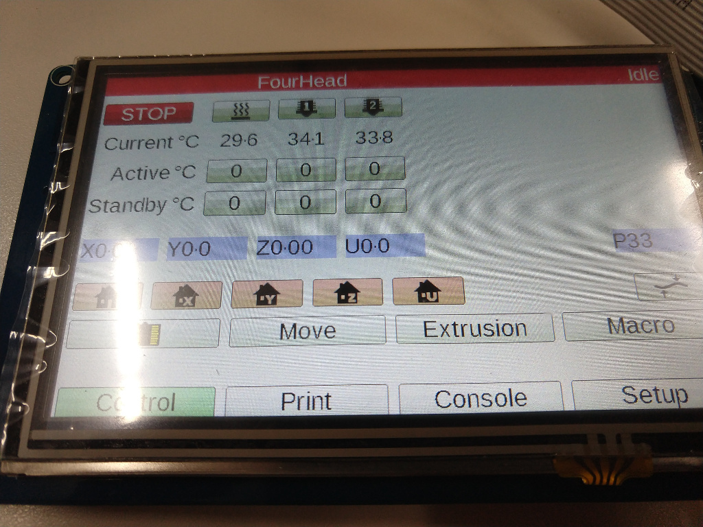

I have updated to the latest firmware 2.01(RTOS), and am using stacked dual PT100 interface boards for sensors. The electronics are able to read the temperature for all 4 sensors correctly. However I'm having issue with defining the tool heads and getting the correct heater to correspond with the tool.
With the configuration below, the LCD is showing only 2 of the tools. And If I try to turn on the first nozzle, just to a low 40C temp for testing, it starts to heat the correct hotend, but its acting like it thinks it is heating the 3rd one(temp highlighted red on LCD) and will thermally run away far beyond the set point on the first hotend.

It's a limitation of the current PanelDue firmware that it doesn't know the tool-to-heater mappings, so it assumes that tool 0 uses heater 1, tool 1 uses heater 2 and so on.
What I don't understand is why only 2 of your tools are showing in the top row. I will investigate this. Which version of PanelDue firmware are you using? Look on the Setup page to find out.

The PanelDue shows: firmware version 1.17

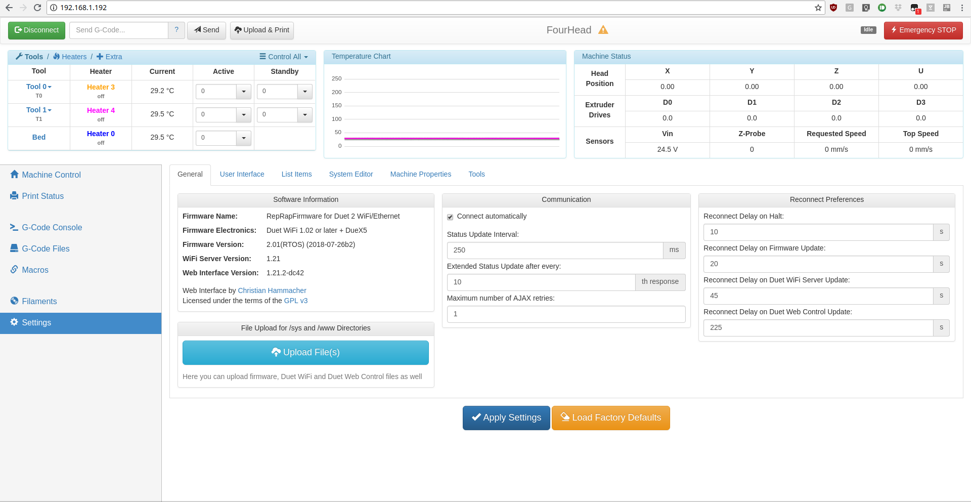

Also here is the full the copy-pasted "Software Information" from the web interface:
Firmware Electronics: Duet WiFi 1.02 or later + DueX5
Firmware Version: 2.01(RTOS) (2018-07-26b2)
WiFi Server Version: 1.21
Web Interface Version: 1.21.2-dc42So it sounds like I should probably just give in and rewire the heaters to use the first two on the main board for best compatibility?

OK I updated the panel firmware, and it still showed only two tools.
Also the web interface shows the same of only two tools
So I then tried rewiring the heaters to use E0 and E1 heaters on the Duet 2 Wifi board, and the first two on the DueX5.
And I changed M143 and M563 config lines to use H1 through H4 instead of H3 through H6.It still shows two tools, but the 3rd and 4th temp sensor info is now also removed from the panel display.
And again the web interface after rewiring and reconfiguring
The two tools do heat and stop heating when target temp is reached with these settings, so that is good.

In your config you've used M584 to map axes and extruders to physical drives which is all fine. The extruders are mapped to physical drives 5,6,7 and 8. But what this actually means is that extruder 0 is physical drive 5, extruder 1 is physical drive 6 etc. BUT, in the tool definitions, Duet is expecting extruders drive numbers, not the physical drive to which they have been mapped. So you first tool (P0) should be M563 P0 D0 H3 (not D2), the second tool should be M563 P1 D1 H4 (not D3) etc. The extruder drives are 0 to 3 (mapped to 5,6,7and 8 ) so the two tools defined to use drives 2 and 3 will work but you don't have extruder drives 4 and 5. Logically this could be the reason why only 2 tools show up.

Thanks Ian, I think that explains it. The last two M563 commands are probably failing because the extruder drive number in them is invalid.
