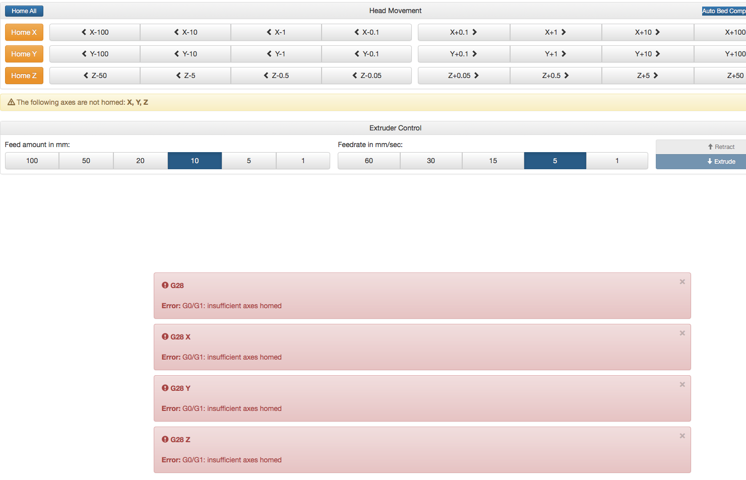

              Now I get an error, none of the motors move and lost the ability to home. Found the Wiki on it, but I can't seem to make heads or tails of what needs to be changed specifically. Can you steer me in the right direction again, I think when I get this resolved, I will just leave it be and use it a lot. Thank you for your help.

              • Phaedrux
                Phaedrux Moderator last edited by Phaedrux
                From the version 1.21 release notes
                On Cartesian and CoreXY printers, normal G0 and G1 moves are no longer allowed before the corresponding axes have been homed. In particular, if your homex.g, homey.g and homeall.g files raise Z a little at the start and lower it at the end, you will need to add the S2 parameter to those G1 Z moves. Otherwise the G1 Z move will be refused unless Z has already been homed and the homing macro will be terminated. If you want to allow axis movement prior to homing, put M564 H0 in config.g.

                  • dc42
                    dc42 administrators last edited by
                    As the release notes imply, adding M564 H0 to config.g will restore the previous behaviour and avoid the need to modify your homing files.

                    • titanhusker
                      titanhusker @dc42 last edited by titanhusker
                      @dc42 - Thanks, for your help, now we are working again!
