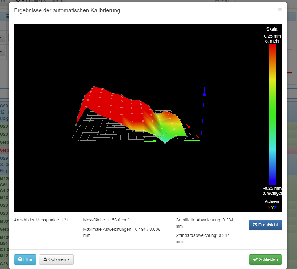

          I tested many hours and my conclusion:
          To get a working, reliable, reproduceable Orion is just luck. Any potentio position, bed speed (240-400), any pre pressure on the Orion itself, and I cannot get values like before.
          I get values like the pic, unbelieveable
          If I do with A5 S0.02 , it always aborts with "Error: Z probe readings not consistent" at unreproduceable positions on the bed.

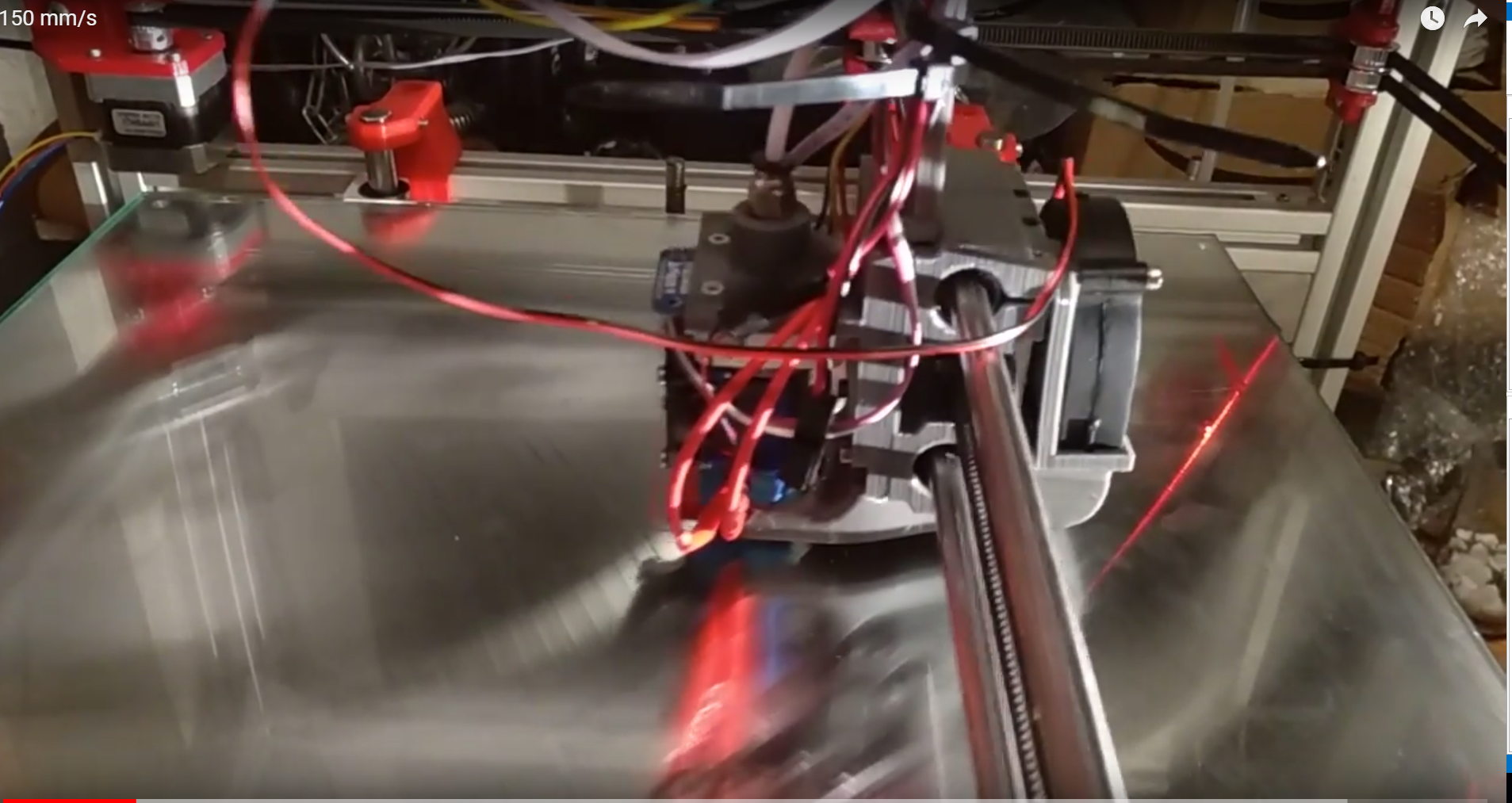

                      I thought your part cooling fan was on in the video?
                      When you changed the carriage and the problems came back, did you change from using the groovemoutt Orion top supplied with the kit to using the grey integrated carriage in the picture?

                        The carriage is basicly always the same. Before I got a direct mount with BMG and pancake stepper motor. The last values were reliable and good. Even with fan running. Since one week the fan is always of to eleminate the bad affects
                        Then I changed the design to bowden. I removed the mount parts for direct drive and decreased the height. I did not change the rest.
                        I never used the groovemount you shipped. I always use my integrated, where I got bad and the very good values, too.
                        Here is the picture of the "old" mount.

                          More hours of testing and still not reliable values. I removed all cables and even the filament tube.
                          I changed to another carriage, which is like mine but I had the hope that is better, but not.
                          Sometimes I can I got differences up to 1 mm, which I could see with my eyes.
                          The z Probe and the first mesh value got a difference like 0.006 mm, fine, Rest not

                                      Why does the G32 4 point probe differs so hard at the same points like in big mesh?
                                      The G32 seems realistic, as I manual leveled it there.
                                      https://forum.duet3d.com/assets/uploads/files/1537990154117-a0098d3d-47cd-4a0d-8fde-2169d264a9e8-image-resized.png

                                        @hevilp "Why does the G32 4 point probe differs so hard at the same points like in big mesh?"
                                        I don't know is the honest answer, this is not a problem I have seen before. It is expected that the results from mesh probing will be a little different from four point probing, simply moving the printer causes that but it should not be as much as you're seeing.
                                        How is the Z-axis supported on your printer? Can you add a couple of probe points to your Bed.g one in the centre of the bed, maybe one in the middle of each side?
                                        On my X5s there are two lead screws, left and right, and four linear bearings. When I started using the Orion on the X5S I would see a domed bed, higher in the centre because even the very light force of the nozzle touch would cause the bed to wobble, except in the centre where it was supported by the leadscrews.
