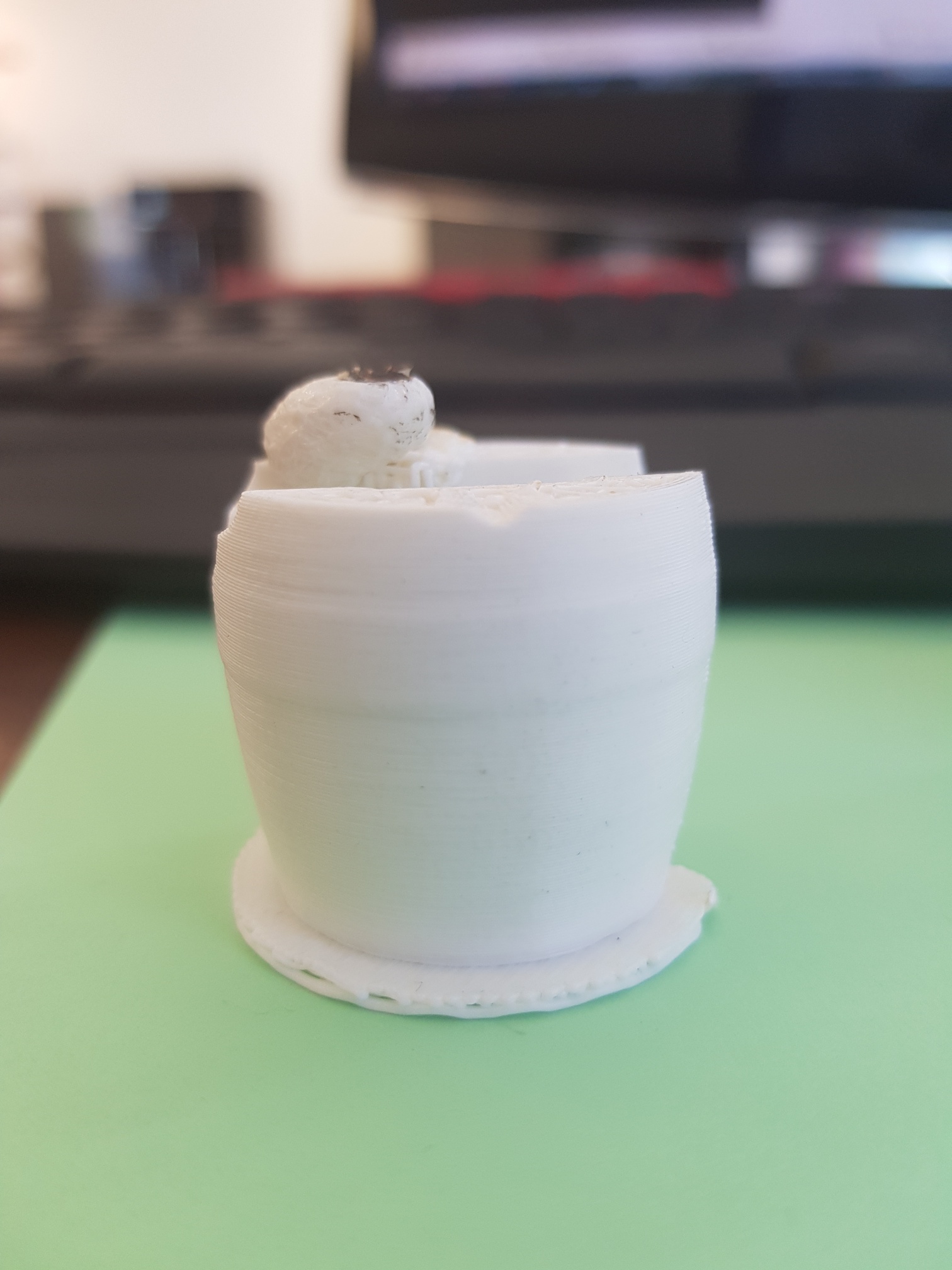

I had this model printed on my main printer and got this thicker back appearing on surface.
i then turned on pressure advance and print greati got a second printer that had a marlin board which printed the same model fine.
installed duet, and printed the same band.
so i turned on pressure advance, but the band is still there.all printers are direct drive.
just can figure it out, any suggestions? -
Solved.
Was due to Maximum speed and acceleration of extruder not set high enough.
