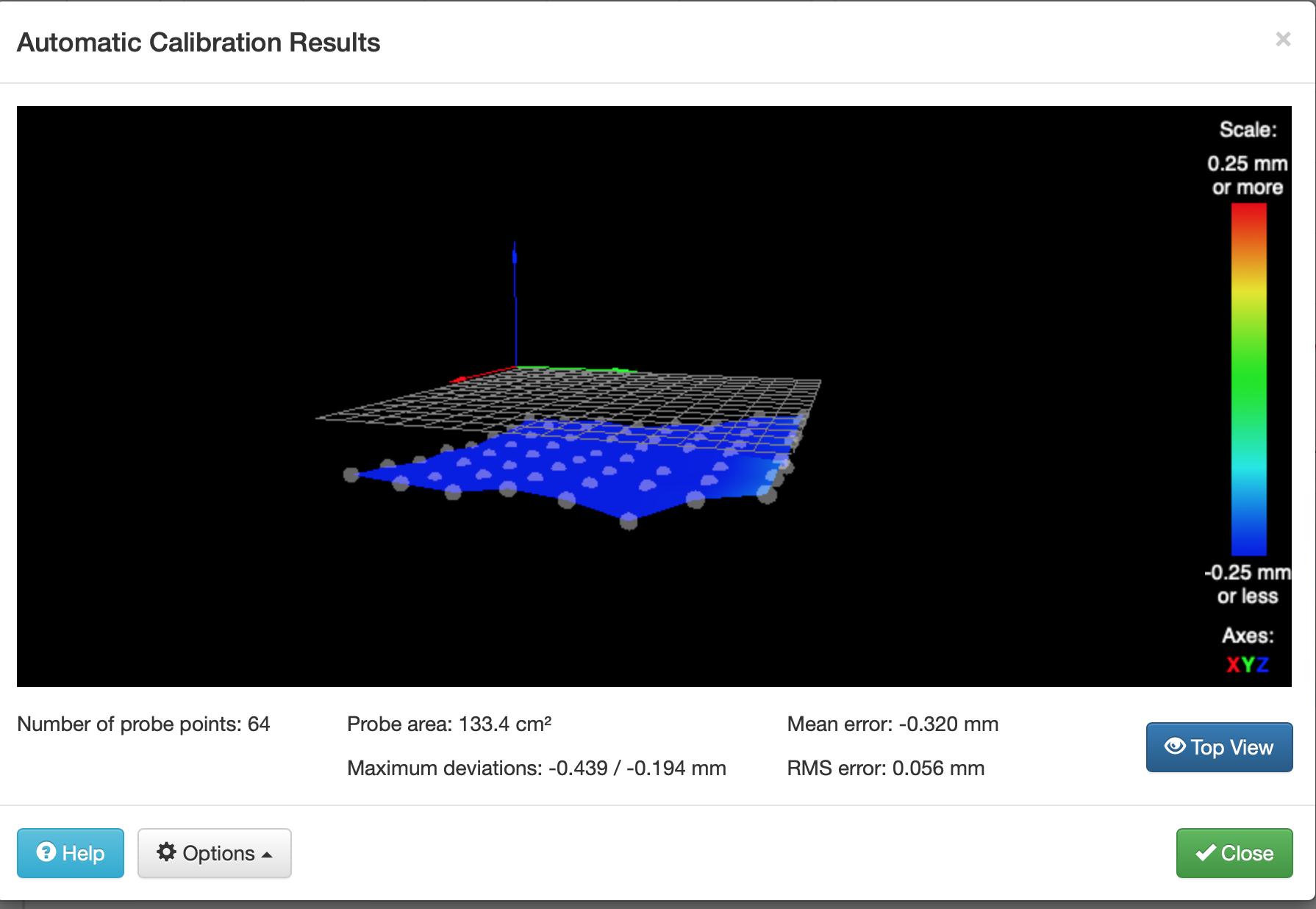

I did one with 64 points. What do you think ?
It has an overall Z offset, but it looks nice and flat.
How are you homing Z?

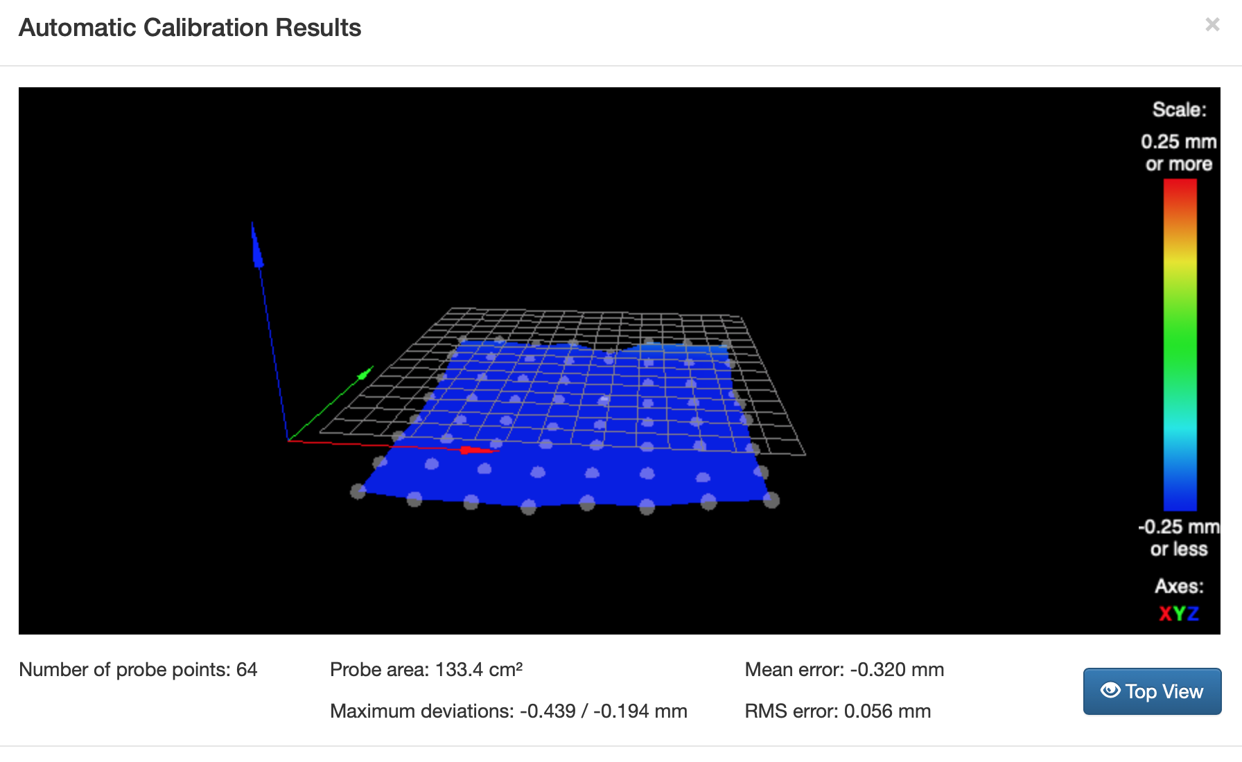

I am homing with an Endstop that I have placed on the bottom of the printer. I attached 2 photos to see. I also made another screenshoot of the same mesh from another perspective to see it.
@gbiski said in Ir probe results:
So the endstop and the Z probe disagree on where Z=0 is. Find out which one is wrong, and correct it.

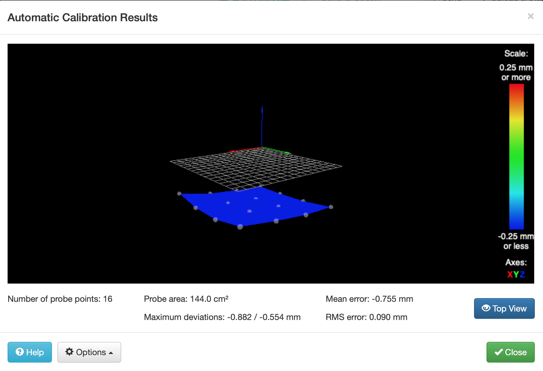

Can I ask what I do wrong ? I homed the Z with the Endstop. At the centre of the bed the distance was just equal to be able to drag a paper. So I guess the Endstop zeroed correctly. I measured with a caliper the distance between the lower end of the ir sensor and the nozzle (bed when homed at the centre).
This offset was 2,6mm and the leds of the ir sensor were open when the nozzle was homed. I put this value (2,6) on the trigger heigh field on the configurator. I uploaded the new configuration.
But when I run after all these again an auto bed compensation I get the following results: -
Your Z homing s set up correctly if, when you home Z and then command the head to Z=0 and some suitable XY position, it just drags the paper. The position after homing is not necessarily Z=0, it depends on what you have in your homing files.
