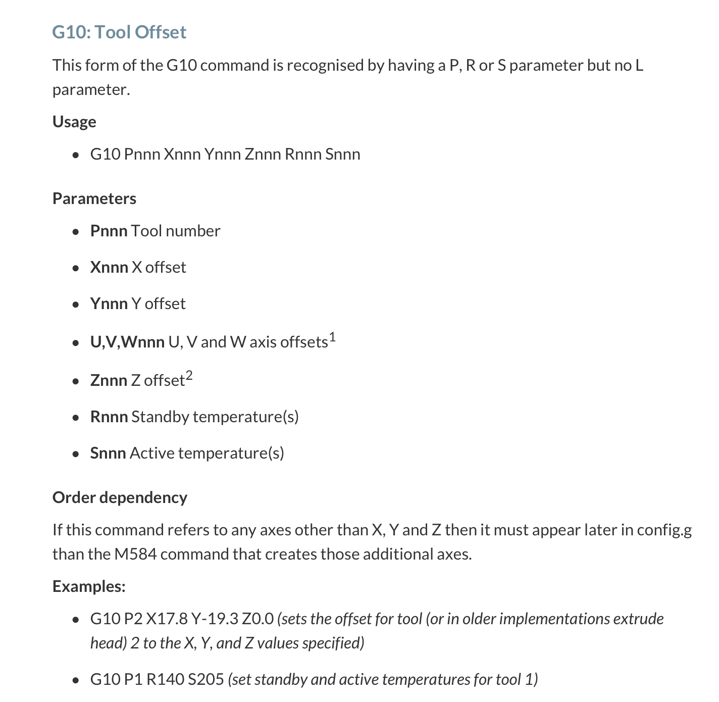

    G10 command? Has three different meanings on the Gcode wiki page.
    Retract, Set workplace coordinate, or Tool offset. I don't want to do any of those. Retract was done end of last job, workplace co-ord's in probing sequence at start of script, tool offset in config.g. Looks like a case of "make your minds up what it is reprap!" command 😂 Cura and Simplify3D only understand it as a retract command as do every other major flavour of gcode.
    Steve
  • @pilotltd see
    this screen shot is from the Duet code wiki pages. note the R and S Params
  • @pilotltd Hi Steve,
    Yes I agree that G10 can be a little confusing which is why I said "let's not complicate things too much". I only mentioned it because the wiki for M109 says quote
    "This is deprecated because temperatures should be set using the G10 and T commands."
    However, most slicers don't understand that.
