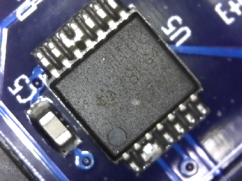

      Anyone have any luck wiring ST-M5045 to the Duet2 wifi? I had these wired on a smoothie board and even a MKS Base board just fine. For some reason they will no work on the Duet. I purchased a expansion board but believe it may not work? ( Not entirely sure what the chip does but its double soldered on 2 separate areas. So I have tried to wire it straight off the pin outs and still no luck (the motors wont even lock when power is up) I have checked En (-) and En (+) and get 3v. I have also sent a travel command and checked Dir (+) and get 3v when the software is pushing the signal. Attached is the board and how I have it wired. 0_1551031418122_Capture.PNG 0_1551031429054_Untitled.png

        I agree, your breakout board is faulty. Unless you are experienced in using solder wick to remove solder bridges, I suggest you return it to your supplier.

          Thank you for your response! I have tried the 3 options and still no locking of the motors or movement when powered on. I have also changed the config to have R1 for each respective axis (i.e. P5, P6) I will keep on triple checking the wires etc.
          What does that chip (the miss soldered one) on the expansion board do? Is it something that has to be repaired or will I just lose part function of the expansion board?
            That chip on the expansion breakout board drives the servo outputs.
