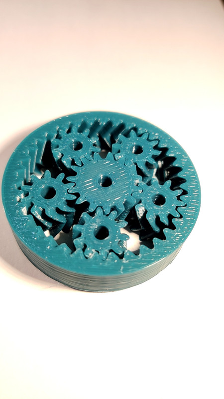

@bberger for me, 55mm arm spacing with 12mm extension (https://www.thingiverse.com/thing:5239585) gives enough room for the orbiter 2 to be horizontal and close to the hotend, and to cover a 250mm diameter bed. I see much less ringing than the bowden setup - this is a frequency scan on the ringing tower single wall at 80mm/sec:
I used a cf/petg filament (Colorfabb XT-CF20) for the extension, and I think clamping the pcb between extension pieces above and below stiffens the assembly. My most recent 19 point G32 gave deviation of 0.015. The sensitivity of the SE did not change - I have two SE with different optimal Z offsets, but those respective offsets remained exactly the same with the extension. I should add that I previously had an orbiter 1.5 on a 800mm bowden, which I have left in place, feeding the bowden tube into the orbiter 2 on the SE, and driving them off E0 and E1 - I haven't yet tried with the orbiter 2 alone. With the dual extruder setup, I am seeing much cleaner prints - this is a planetary gear that previously required quite push to get it moving, but moves freely straight off the printer now.
