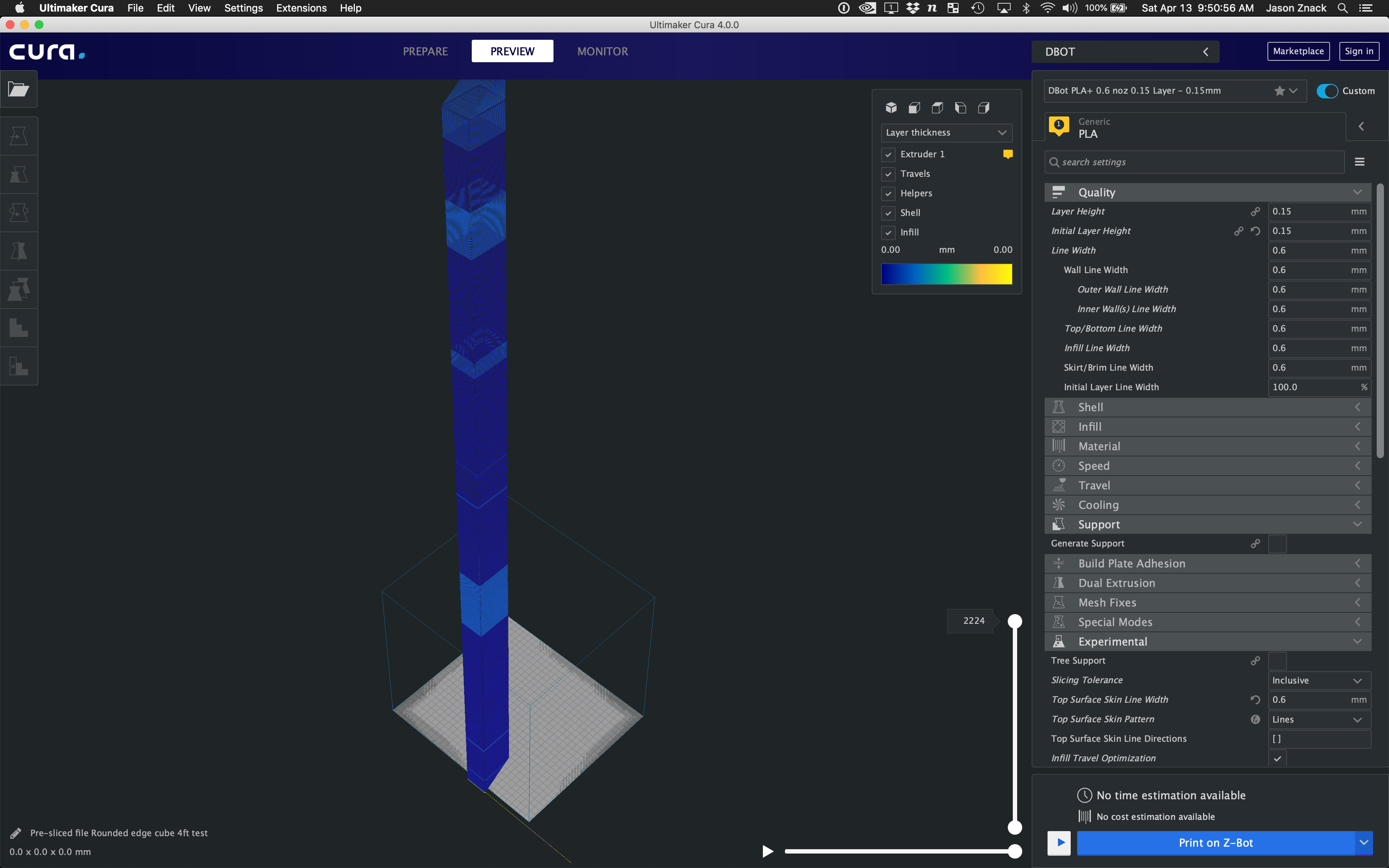

      Hello, I've started to notice a random error in my spiralized prints(just those so far) while printing the nozzle movement(x/y) will randomly come to a brief pause(near stop but not completely) causing an over extrusion in this area.. I can find no reason for this action in the gcode. these pauses do tend to appear in the same area forming a line of random blobs down a print... Any ideas?

                        Looking at the gcode in cura layer view it looks like there are some layer height changes throughout the length. Does it look like they match up with where the blobs show up?

                          its really hard to say... I just tried counting the layers till the first error on the cylinder.. it looks to be somewhere around layer 115 give or take.
                            Yeah that would seem to line up with the first band of layer height changes on the preview just up from the bed.
                              I'm having a tough time wrapping my head around the gcode since it's been processed for the belt printer, I think?
                              Just an idea, but it looks like coasting is enabled based on the comments in the gcode file. Maybe try disabling that in cura. It doesn't always work nicely with pressure advance. Normally that shouldn't come into play with a spiralized print, but maybe with the layer height changes it is?
                              It also seems to be set to Marlin Gcode flavour. Try switching that over to reprap flavor in the printer settings dialogue.
