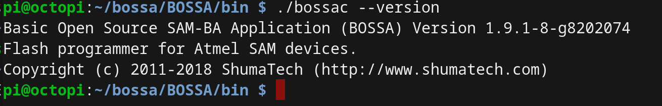

            @T3P3Tony thanks! I found out in the meanwhile that threre is an official build (it's on their GitHub releases page) that runs on Raspberry Pi for bossa 1.7.1; is there a minimum version requirement the use with the paneldue?
              dc42 administrators @oliof
              @oliof said in Upgrading PanelDue from a Raspberry Pi?:
              Yes, you need at least version 1.8.
              • oliofundefined
                oliof
                Success! At least it compiled (after I installed libreadline, wxwidgets already lingered on the pi)...
                Is there a non-destructive way to test whether the PanelDue likes this version of bossa? I'm a bit worried since the instructions to update start with erasing the current firmware.
