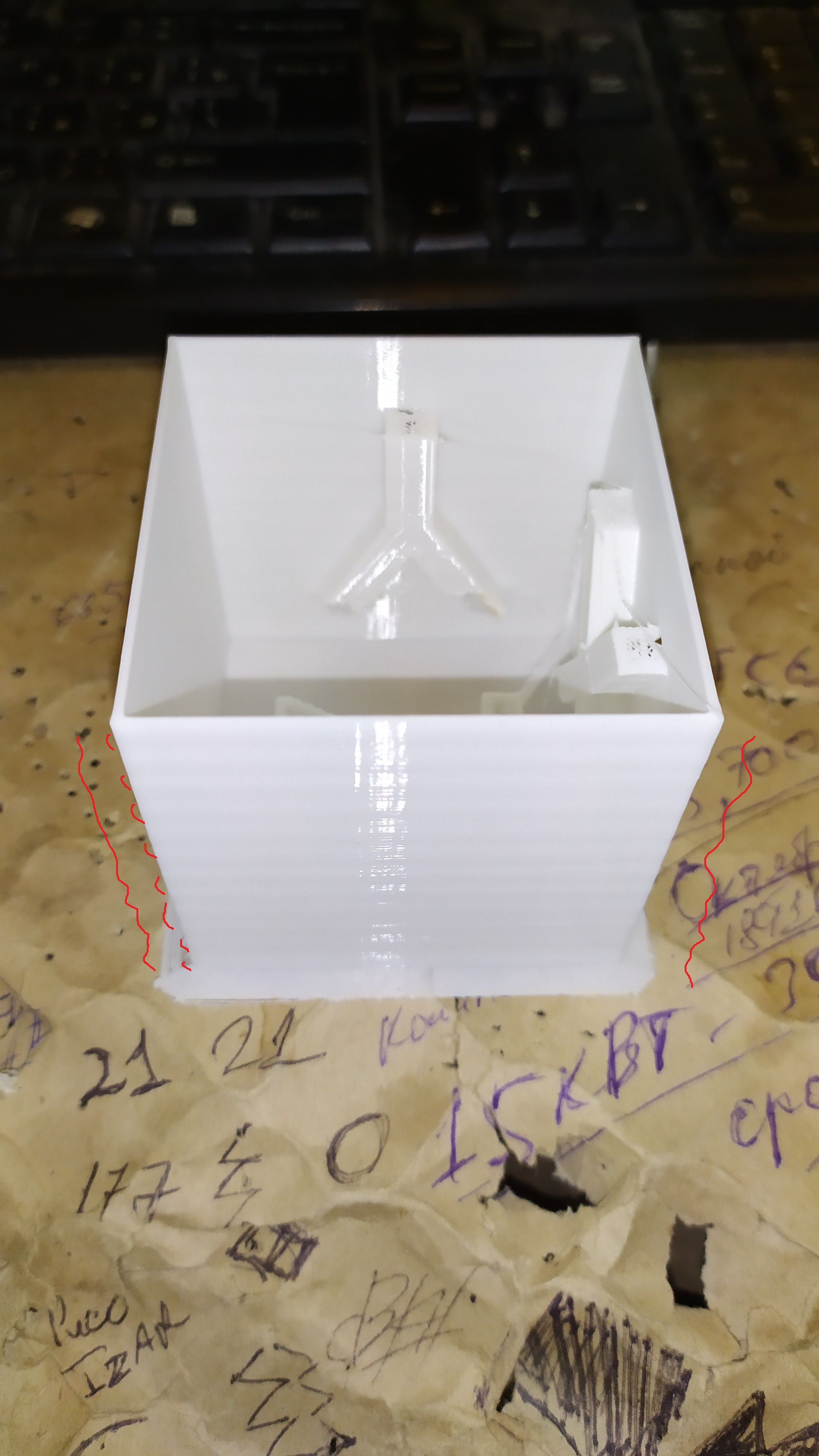

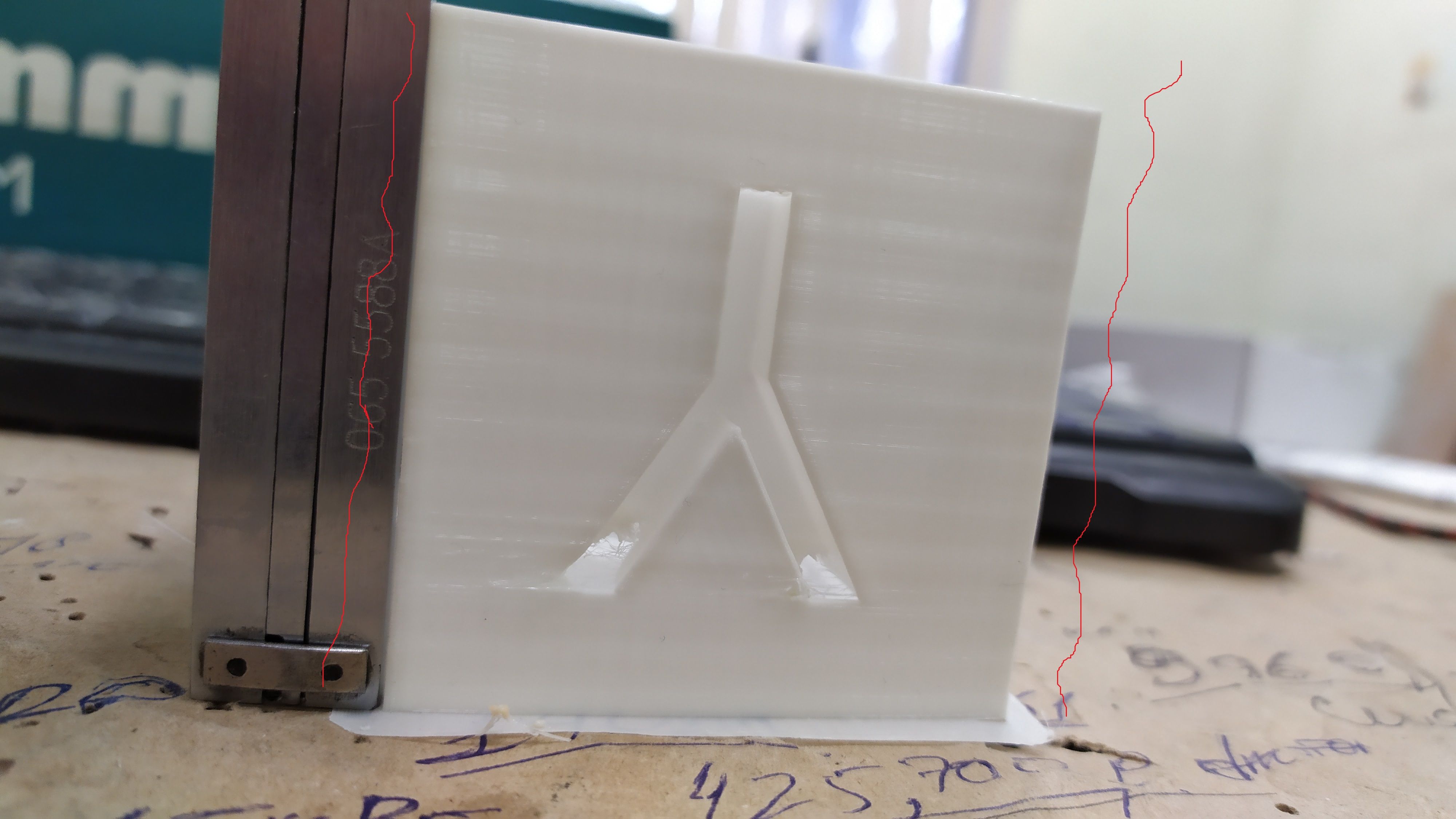

                @dc42 hi
                Have a backlash function been added for the X and Y axes?
                I assembled a large 3D printer and in it I use 1: 4 planetary gearboxes for the X and Y axes. Due to play in the planetary gearboxes and the HTD-3M timing belt, layers are printed in waves. That is, they do not go one on top of the other, they are constantly shifted relative to the previous one. This can be seen in the photo.
                Acceleration costs 900 mm / sec and jerks are malnye default. Filament PLA, fan on. I use feedback servo stepper motors and the print speed is only 40 mm / s so there can be no skipping steps.
                I know that even in the match 3 program there is this function, since many use a gear rack and because of it there are backlashes. Also in planetary gearboxes there are backlashes.
                backlash function implemented in mariln www. marlinfw.org/docs/gcode/M425.html
                please tell me how to solve my problem?!!

                      How do you know the problem is backlash in X and Y and not some problem in the Z axis?
                      • T3P3Tonyundefined
                        T3P3Tony administrators
                        following up on @mrehorstdmd's post. You could design a test which kept the same X but moved X or Y along the other axis while printing to test backlash, assuming it was repeatable.t
                        www.duet3d.com
                        • mrehorstdmdundefined
                          mrehorstdmd
                          A 45 or 135 degree infill pattern on the first layer will usually reveal backlash in the XY mechanism. In a machine without backlash, the lines will be evenly spaced and just touching each other. If there's backlash, the lines will be in pairs, with gaps between every other line.
                          Here's a rather extreme example: https://vimeo.com/173202575
                          Notice that the nozzle lays down a new line as it moves away from the camera, but on the return path the line is almost on top of the previous line, leaving gaps between the lines.
