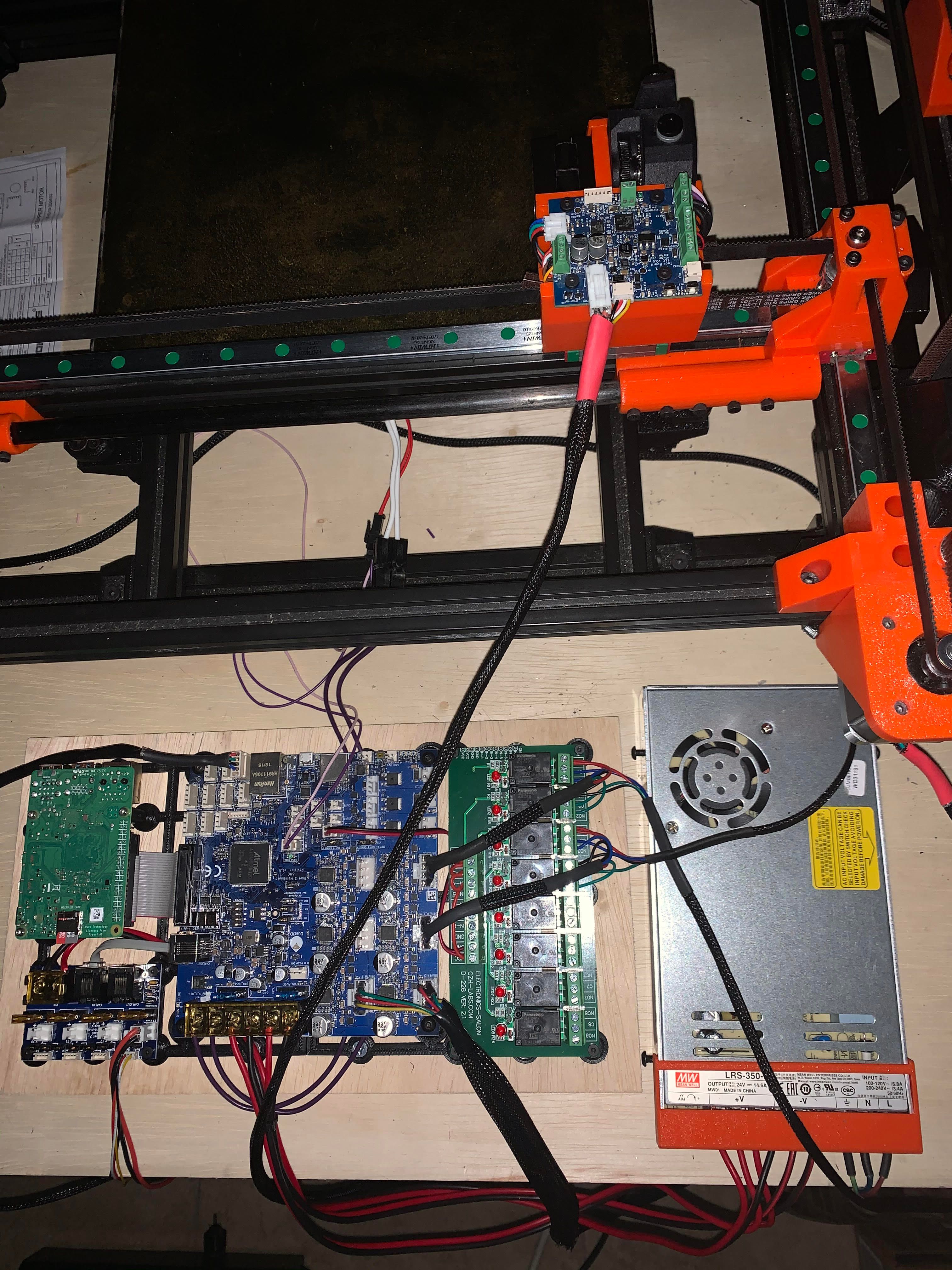

      On power up I see that some times the BL touch will run a self test and other times it will not. When it does not self test it will not extend during the Z home. If I power cycle the printer once or twice the BL touch will then self test and work properly.
      Is it possible that there is a background command being issued at startup that may be preventing the self test?
      Is it possible to add logic to the home routine to check that the pin is extended? I know that the trip value P is set in the G31 command, is it all possible to interigate the P value manually? My thought process is to extend the probe, wait some time, then check that P is equal to some value, if not error.

                I replaced the BL touch unit and I still this. I've also seen this on separate printers. And I've quadrupedal checked the wiring. If i power cycle 2-3 times the self test will run and everything works fine. If I then power cycle again the unit will not do anything and no commands will work. If then disconnect and reconnect the two power pins the self test will perform.
                Looking at the BLT timing diagram I see that there is a minimum 100ms delay before setting PWM so an internal power check can be run. I'm running using a 24 V power supply for the duet and a seperate 5V power supply for the duet logic. Is it possible that there is some power delay on the 24V or 5V side of the board which is cutting into that 100ms wait time.
                • Edumaundefined
                  Eduma
                  I disconnected the PWM cables and powered the BL touch direct from my 5V power supply. I still see the same results of the self test only occasionally being performed on power up. Looks like it is an issue on the power side.

                    • Edumaundefined
                      Eduma @I_Jedi
                      @I_Jedi
                      I found that the 5V signal to the BL touch was not instance on, but instead "slowly" ramping up to 5V. The BL touch was not seeing 5V fast enough and going in to error. I added a time relay to create a slight delay before powering the bl touch and it remedied my situation.
