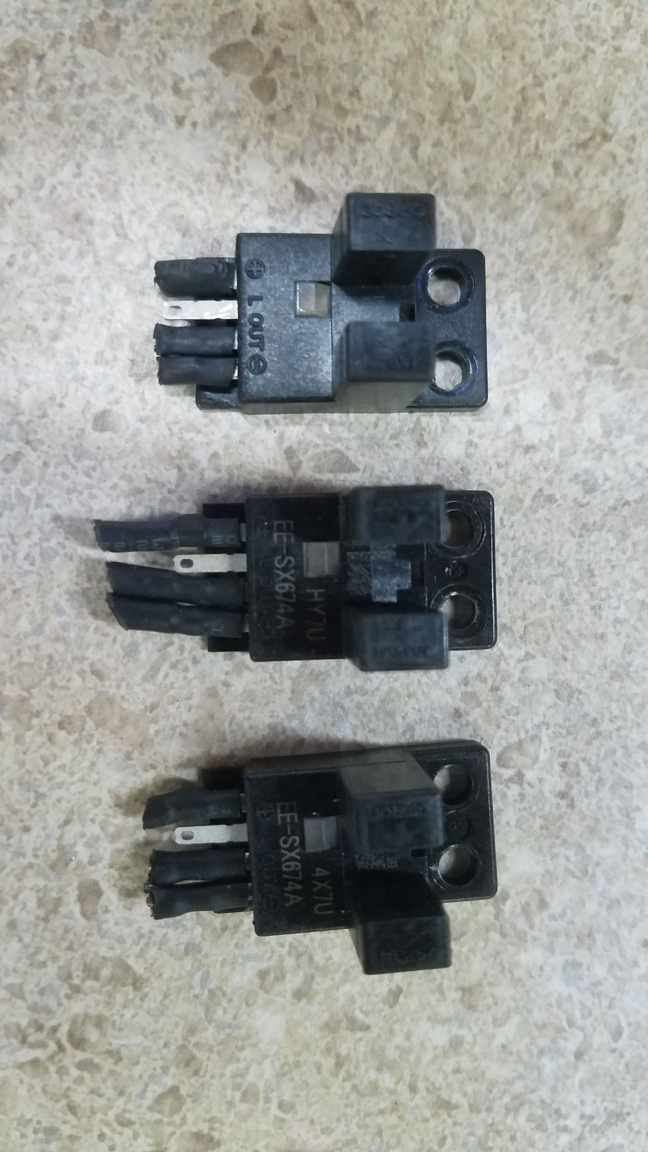

                      Can you post photos of the limit switches?
                      • AMPMAKERundefined
                        AMPMAKER
                        I have used similar sensors on CNC machines and Automation machines with no issues. Although most are 5v.
                        After many tries to get this working, I replaced them with Micro Switches. ☹
                        I have set the command M574 S0 , but when I hit the homing it moves in the opposite direction for about 10 mm.
                        Is this a default setting? When I looked at the homing codes they look correct? But no Negative movement towards the end stops???

                          Why do end stops hits still say " Yes " when they are not hit?
                            droftarts administrators
                            Sounds like your switches are inverted, or there’s a wiring issue, or your config isn’t right. It’s seeng the switch as triggered, which is why the carriage is moving away from it. If you hold down the switch, does it change state? Check in DWC or by sending M119.
                            See https://duet3d.dozuki.com/Wiki/Connecting_endstop_switches#Section_Testing_endstop_switches_using_the_web_interface
                            • AMPMAKERundefined
                              AMPMAKER
                              Yes, I had wired them NO. Changed them to NC. They work properly now. It made no difference setting
                              it active high or low. Strange they would not work in NO mode. The Optical switches where most likely a NPN switch's or NO.
