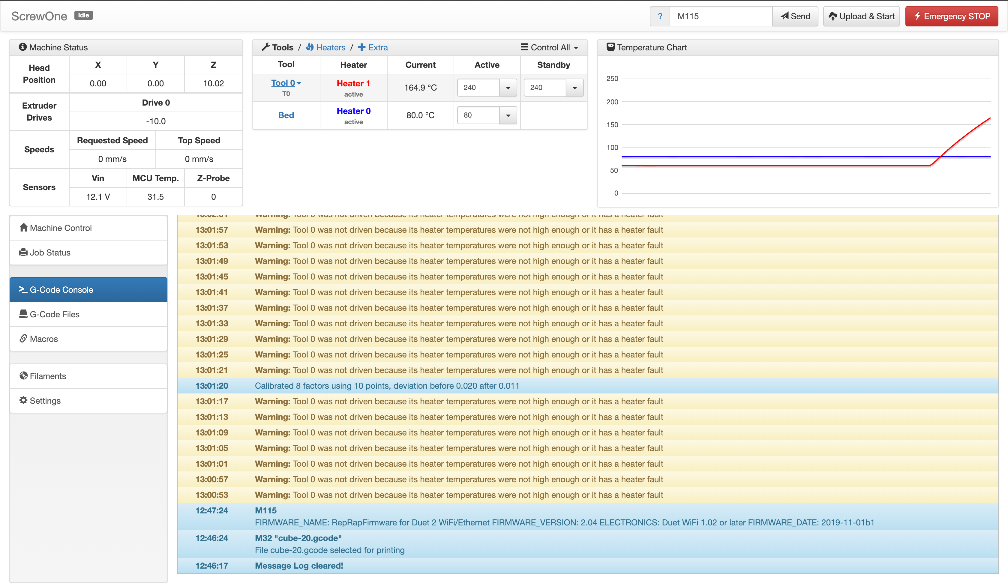

When you start a print, what temperatures do you see? Can you start a print, let it fail, then take a screenshot of the DWC?
@droftarts hello, please find screenshots attached:
So, it basically starts complaining about the temperature right at the beginning of calibration but plot shows stable picture

@skayred I think it's happening because the hot end is quite slow to heat, so the calibration finishes and the print starts before the hot end has got to temperature. Did it used to heat up quicker? Check wiring and connections, or possibly check if the heater is failing.
There are some warnings before the calibration, which may mean that you have an extruder move in bed.g (or however else you're invoking the calibration), but maybe pressure advance is trying to make the extruder move for some reason.

@droftarts well, warnings appear only after 60C was reached and calibration was started, nothing before - on the second screenshot, you can see warnings for each bed touch (I have piezo sensors under).
About waiting - I also use it, so temperature is reached before any following actions will be done.
