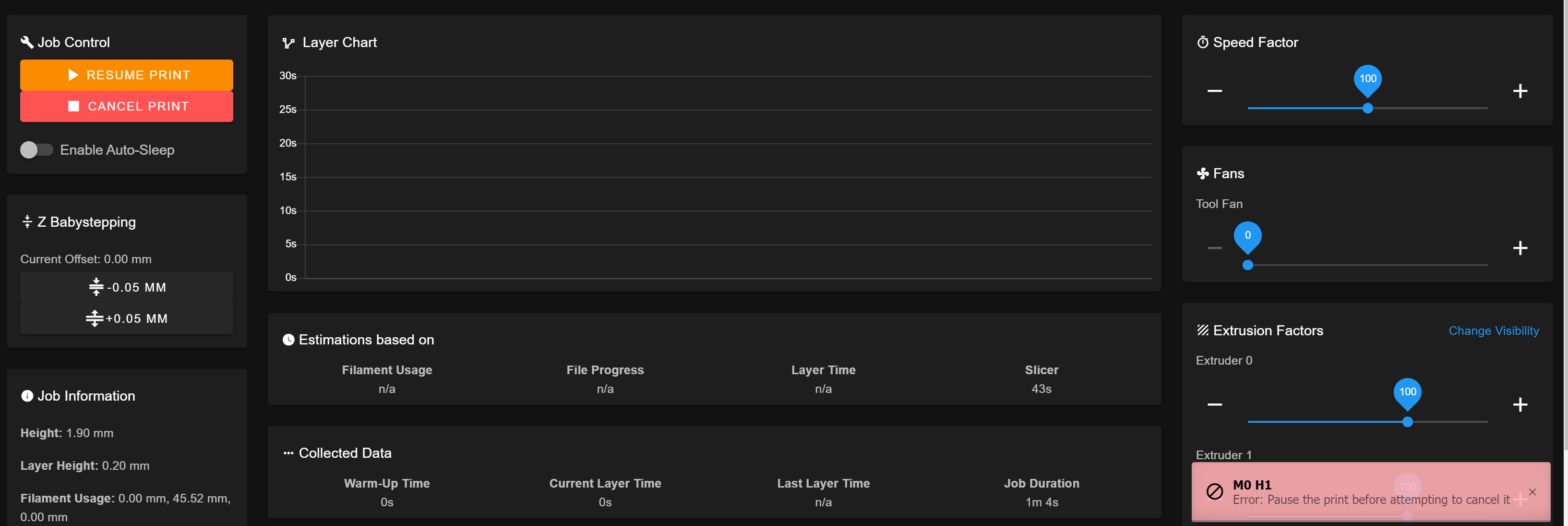

Start print > remember domething > Pause print > Cancel
and I get red error - "pause before cancelling"
And then it is in some kind of state of waiting or something...

Attachments below.
Please note print is paused but error message tells that I still should do it!
This is after Power Off, reload web page (even close-open browser for WebUI)
Sending direct command isn't possible either.

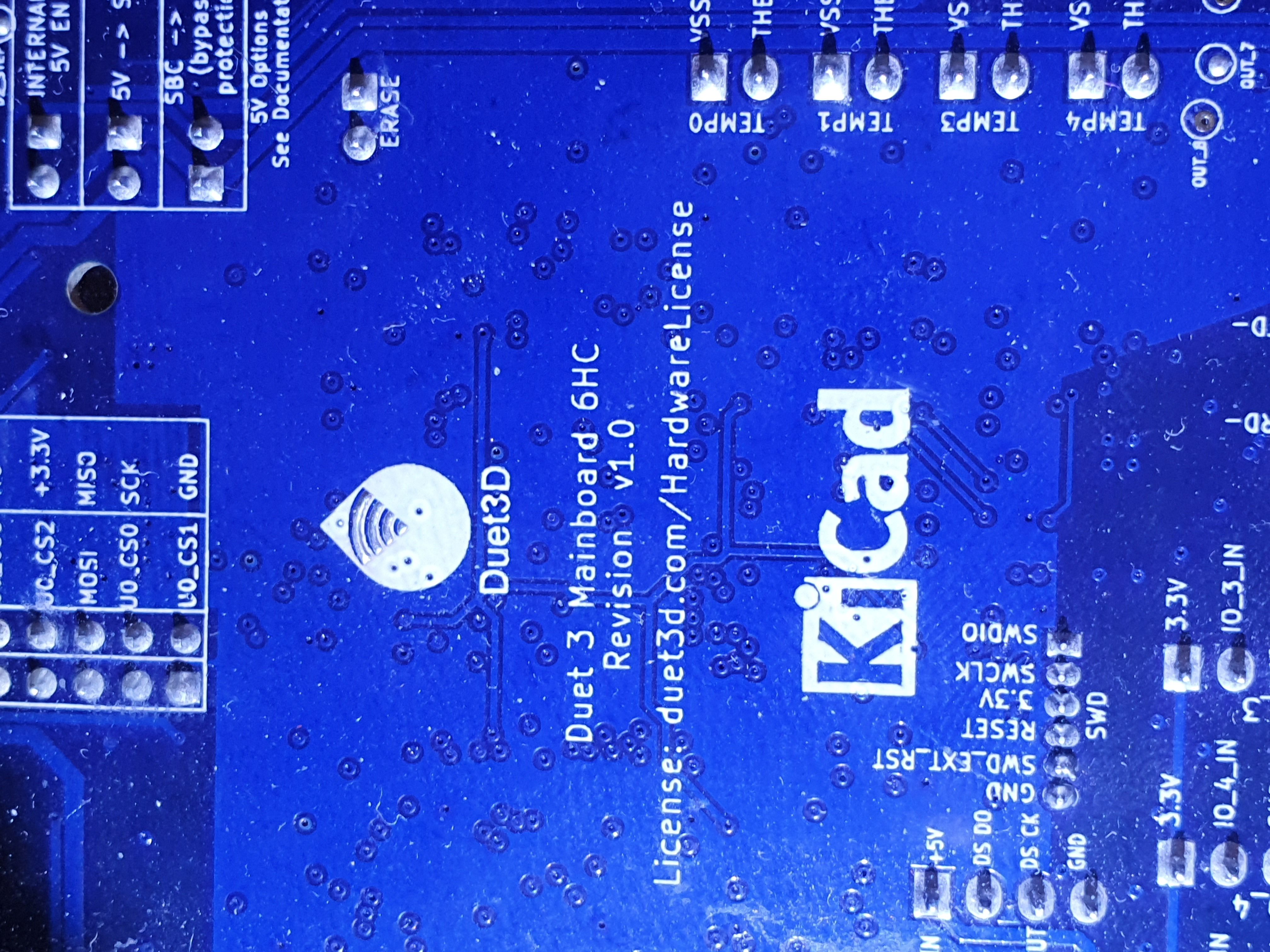

Board: Duet 3 MB6HC (MB6HC)
DSF Version: 1.2.4.0
Firmware: RepRapFirmware for Duet 3 MB6HC v0.6 or 1.0 3.0 (2020-01-03b3)When you say "power cycle" what are you power cycling? The Duet3 or the RPi, or both?

I also just noticed that when Pause print pressed - pause.g isn't seem executed...
