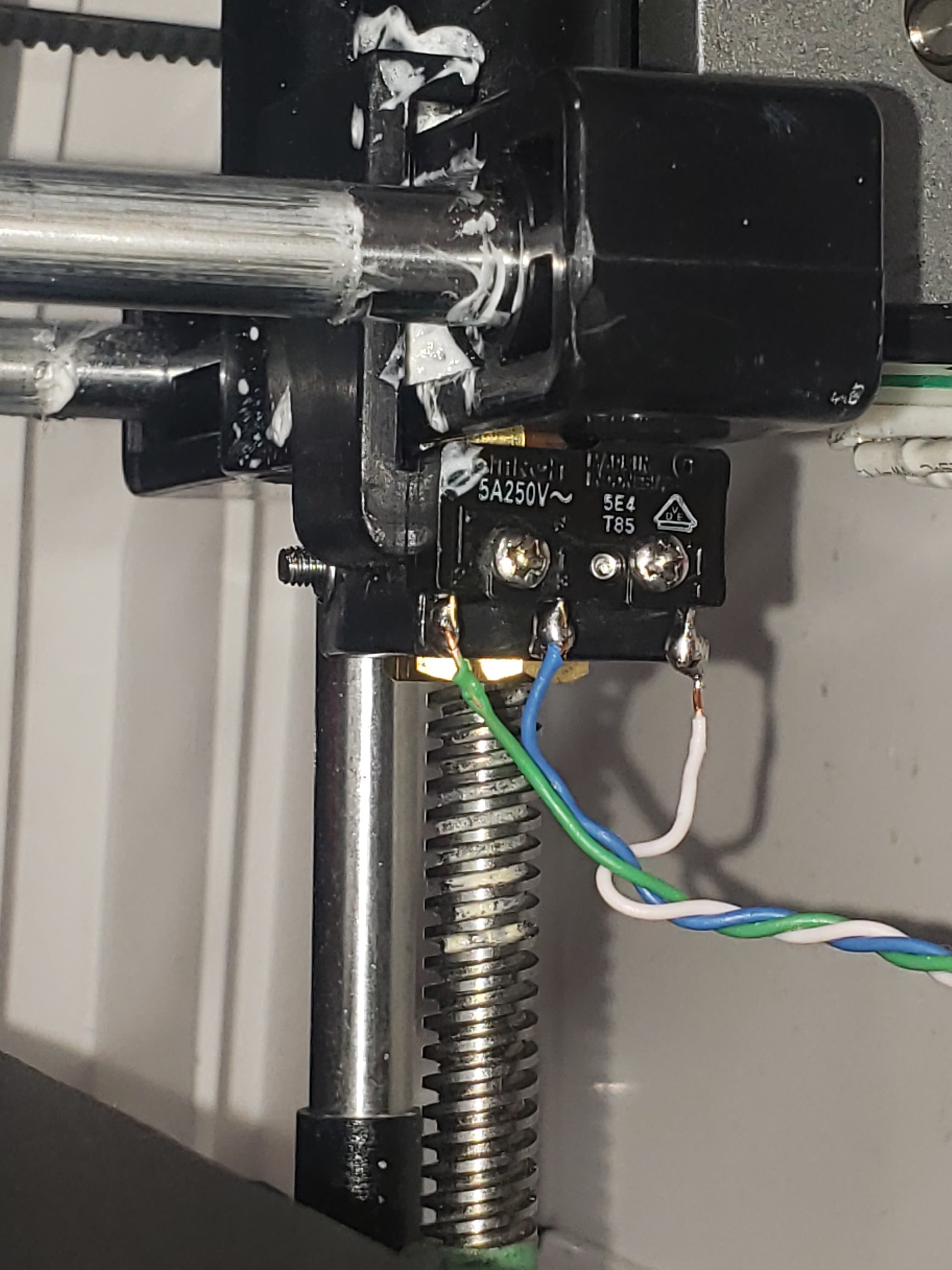

@joehsmash It could be that your endstops aren't at exactly the same height. I know that doesn't explain the difference of 0.15 when backing off 50mm but it would explain the difference between 1.45mm and 0.95mm

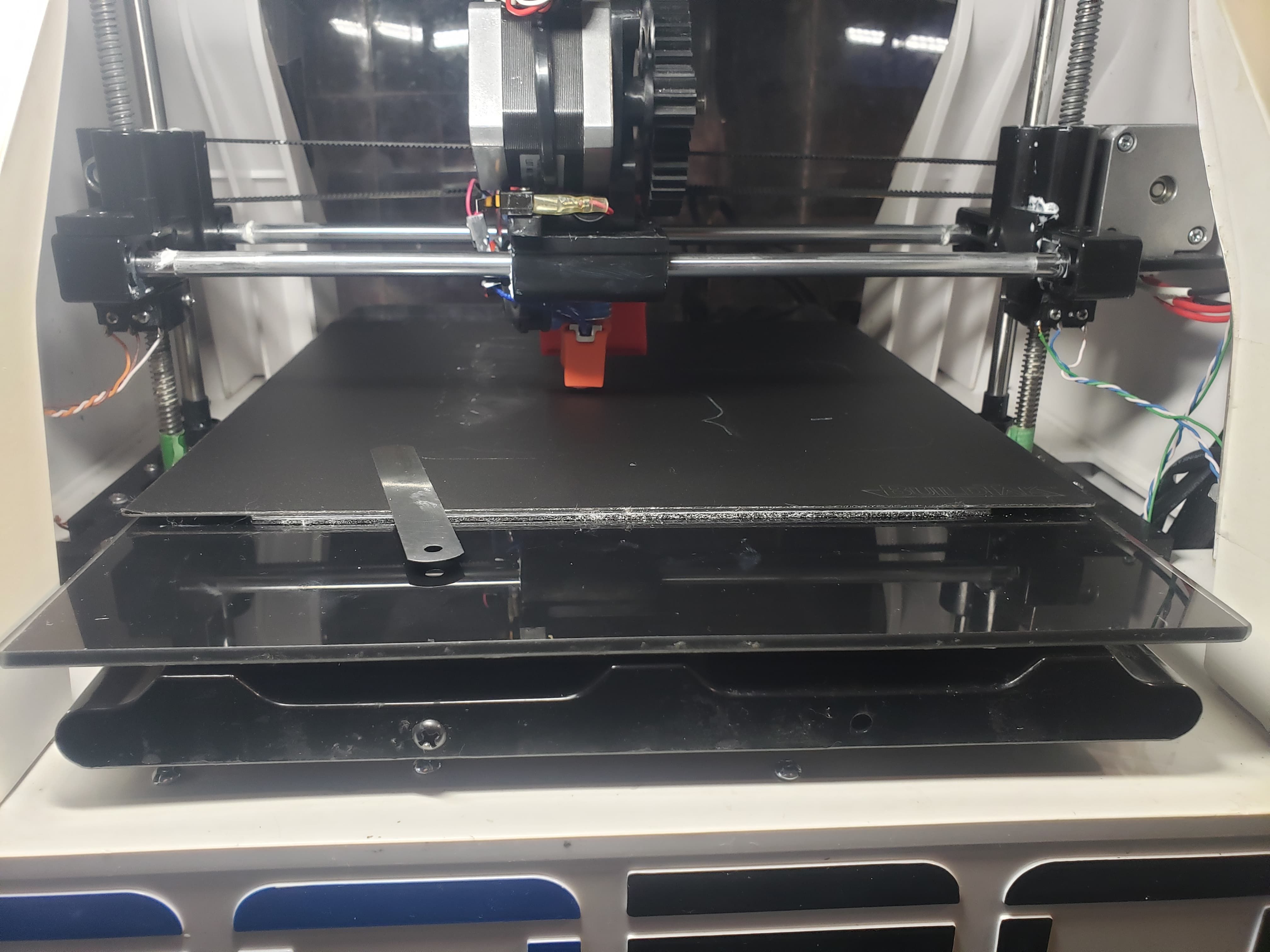

@joehsmash To use one Z stepper only is a good idea. Additionally you may have a mechanical problem with one side. It is easier to discuss this by seeing images from your construction, especially the connection between stepper and spindle/belt/whatever and how the bed/gantry is moved.
@jay_s_uk this is a certain possibility. the way my gantry works is the lead screws are embeded into the x gantry, there is a clamp that holds the switches onto the underside of the gantry which is clamped onto the lead screws.
so to adjust them would put the entire weight of the gantry on one little screw which would move in the long run
First I wonder why you have three cables at your endstops, because my are looking the same and two cables are sufficient: using left and right means closed when not active and they open when endstop is triggered.
I would expect some pressure between left and right, so if you change direction of one Z side, it will stuck at the trapezoid spindle. First test would be to let fixed the spindle and the linear guide on one side (let's say it is left), but loose the other (right) side a bit (trapezoid screw and linear guide) (like a fixed bearing and a loose bearing at CNC machines for installing ball bearings). So the right side can move a bit horizontally if necessary.
@JoergS5 i just soldered on ones for the no, nc and common because i didnt want to have to dissasemble them to solder them if i ever needed to in the future, both of the NO contacts are disconnected underneith
@joehsmash ok I understand and it's ok of course.
@JoergS5 the construction of the lead screws are integrated into the stepper, so theres no adjustments that can be made.
i can how ever manually adjust where the screw lays on the endstop clamp but for reasons i have posted before i wouldnt put all that pressure onto the one little tiny screw.
And I cannot see exactly that this green connector is and how it is connected to the stepper, can you make a close picture of it please?
@JoergS5 the green your looking at it just tape, so i can visualize if each of the stepper is moving.
i use it to verify if the mesh is working or not.
So the trapezoid spindle is directly inside the stepper? Or is there a coupler between?
@JoergS5 these are integrated lead screws. there are no couplers.
Ok I understand now.
Now what do you mean by weak screw where you don't want the whole load on. Which "tiny little screw"?

You can see where the top of the lead nut is embeded into the upper gantry. so technically i could cheat it and raise the gantry and tighten it down onto the lead nut with that screw.
