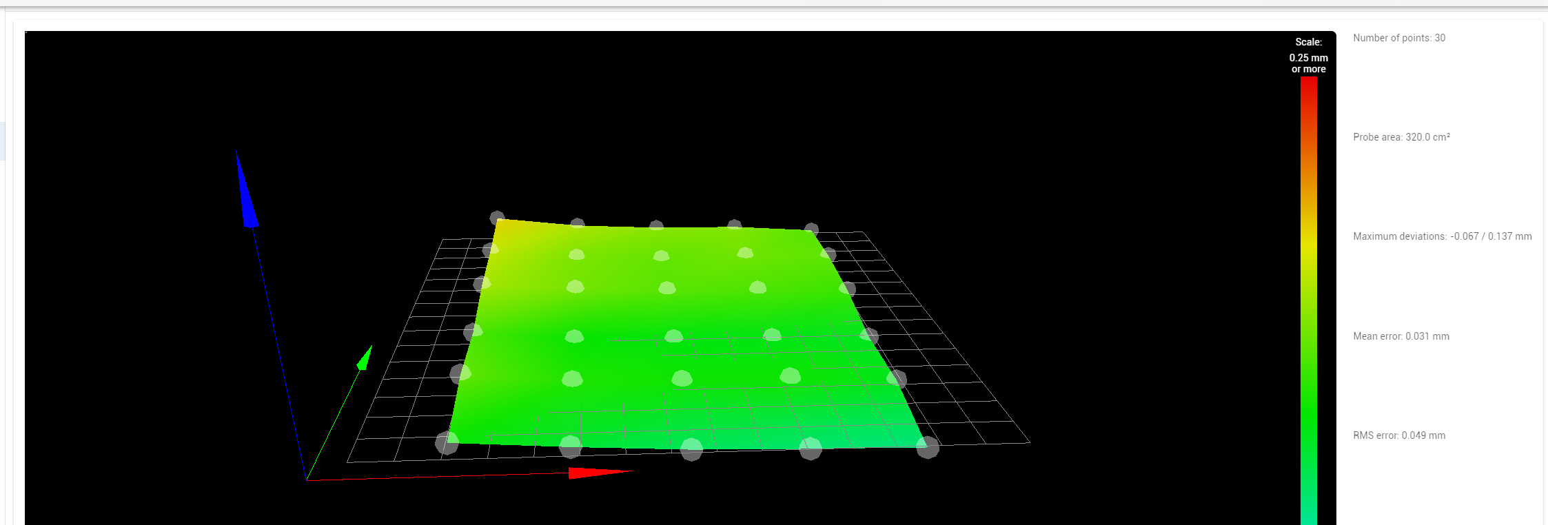

                I'm calling G29 S1 in the start code of the slicer
                I ran G29 to generate the heightmap manually just before starting the print.
                Here's a screengrab of the heightmap, that back corner looks a bit high, the back corner of the print is where the nozzle looks too close to the bed, Maybe a re-levelling is in order? But the printer should be compensating for that unless I don't have enough data points?
                Kweakuiundefined 1 Reply Last reply Reply Quote 0

                  @Kweakui @Phaedrux Ok, cleaning definitely helped (should have tried that first), it still doesn't look like it's trying to compensate though as the part close to that back corner is definitely too close to the bed.

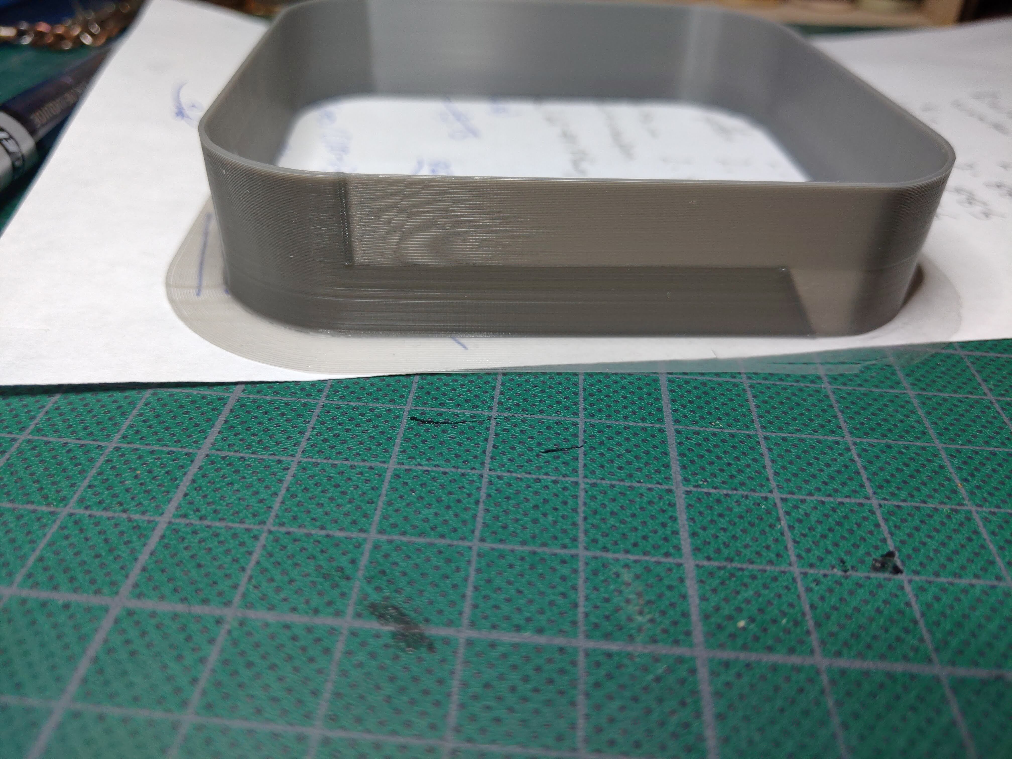

                    I'm a heck of a lot farther now thanks to your help guys, it printed out the test cube, there's still some dialing in for me to do I think, I'm still not convinced it's properly compensating, but I'm going to re-level the bed again and get that back corner in line as much as I can.
                    In the 21 mm of the test cube (box?) that it printed, the front looks pretty great but the sides have a bit of wobble to them and the back has these weird artifacts, here's a picture.
                    I think those might be down to Slicer settings, it looks like it does some sort of wipe at those points.
                    I'm going to try printing a few other things and see how to dial in all the settings.
                    If you guys have any suggestions, I'd welcome them.
                    Thanks for all your help!
                      Thin prints like that with short layer times are going to have artifacts like that, so don't worry about it too much.
                      It looks like you could level the bed a bit more, but it could also be some skew in the axis itself, which you can't really level out. You can try upping the number of points to get some more detail.
                      You can also reduce the first layer speed and increase the bed and nozzle temp a bit to help adhesion. Your extruder should be well calibrated as well.
