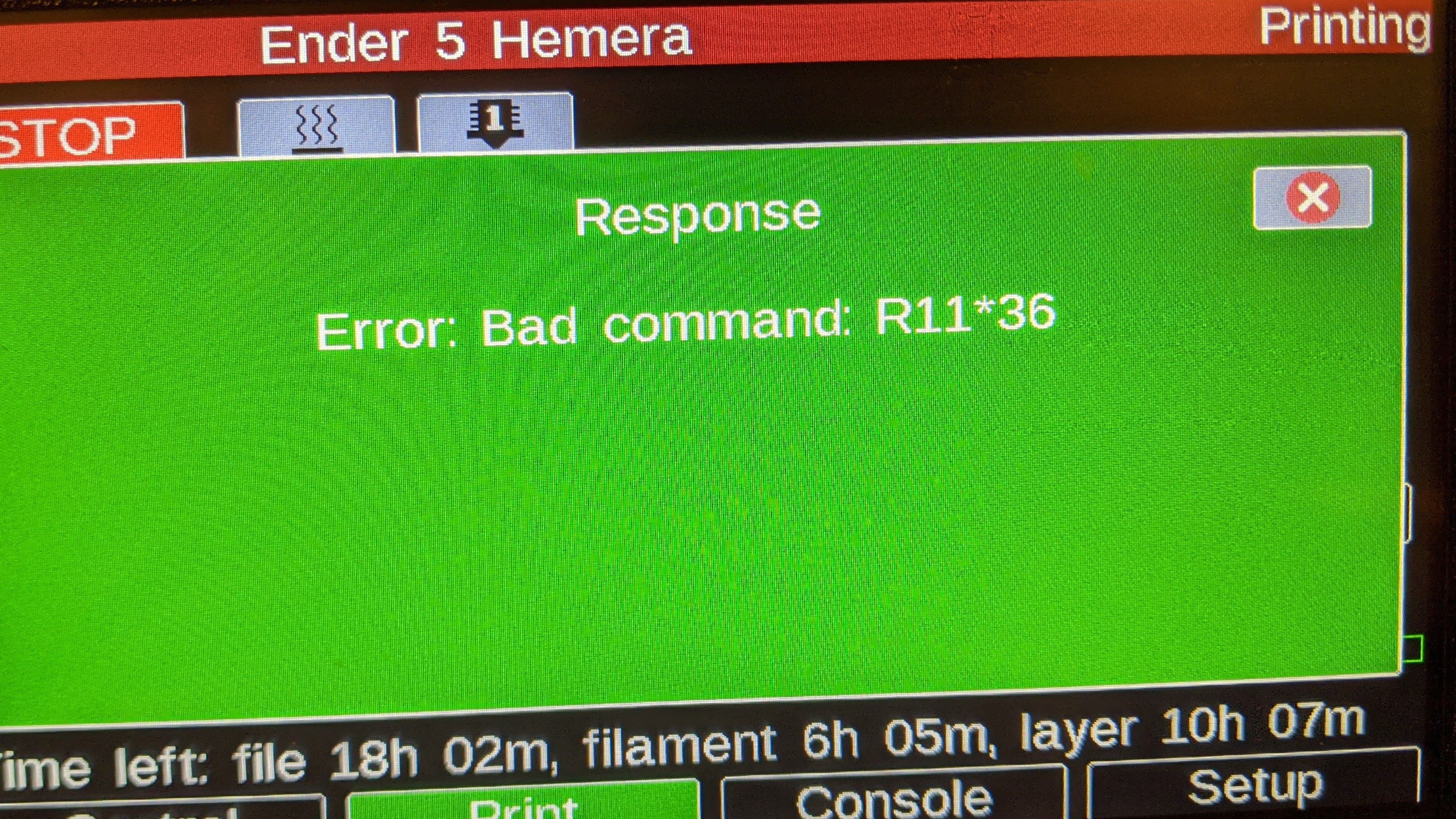

Solved Strange behavior after 3.1.1 upgrade

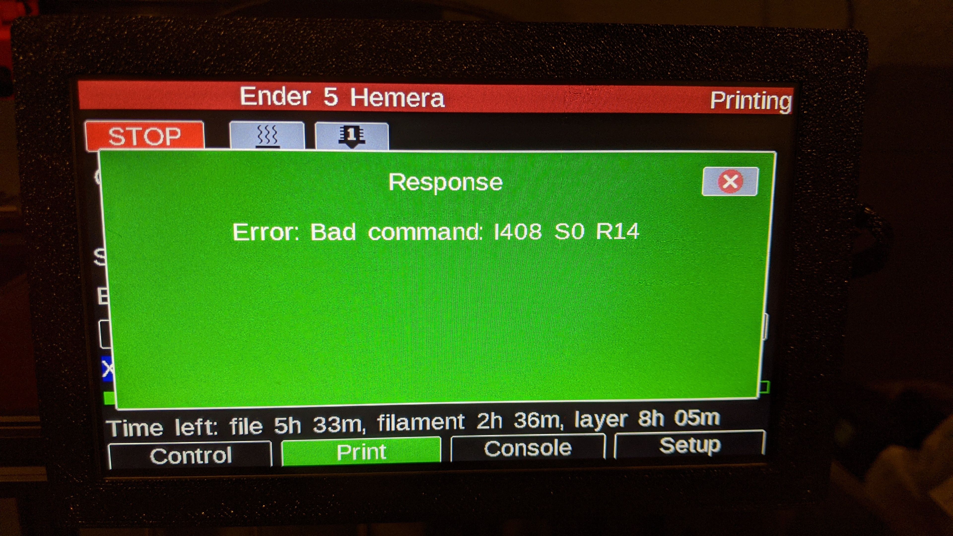

Power has been restored and I have begun testing with the lower 38400 baud rate. I also made sure the Green/White wire was fully seated in the connector this time.
No change in behavior. I still get random errors popping up on the Paneldue during prints (never when idle). I did notice that I never see any errors when homing but the errors are so sporadic so it is hard to tell if that is really any kind of indication.
My serial lines are cat 6 twisted par in the attached image they are the brown pair. The power lines are the green pair.
My Paneldue wiring does not follow stepper path. It comes directly out of the enclosure and up one leg of the frame to the display mounting position. In this image it is hard to see but the two pairs are in a braided cable and tucked into the frame T slot channel to hide the wire where it travels straight down and enters the enclosure.
Right now both the display and the config.g are set for:
M575 P1 S1 B38400 ; set the PanelDue Baudrate
I have made no configuration changes other than upgrading the firmware. DWC, Duet 2, and PanelDue. I was previously running from 3.01 RC12 to 3.1.1 on the Duet 2.
I'd be tempted to whip up a new 4 wire cable to test with.
@Phaedrux I will do just that. I can dig around in my wire bin to see if I can find a USB or similar cable that is shielded and will be long enough. It just seems strange after nothing but firmware updates I am having issues with EMI noise. Even if I can fix the display and filament detector with better cables will that just be masking the real problem?
There had been a few other similar issues identified with garbage commands and the PanelDue with fw 3.1.1, as mentioned by @bearer, so they may be related.
If you went back to FW 2.05.1 you could confirm.
The question would still remain though, does RRF 3.1.1 cause the issue, or does it simply illuminate an existing wiring issue. There haven't been widespread reports of this, so it seems to be isolated.
If you test a different cable and rolling back the firmware that might give us some more clues.
