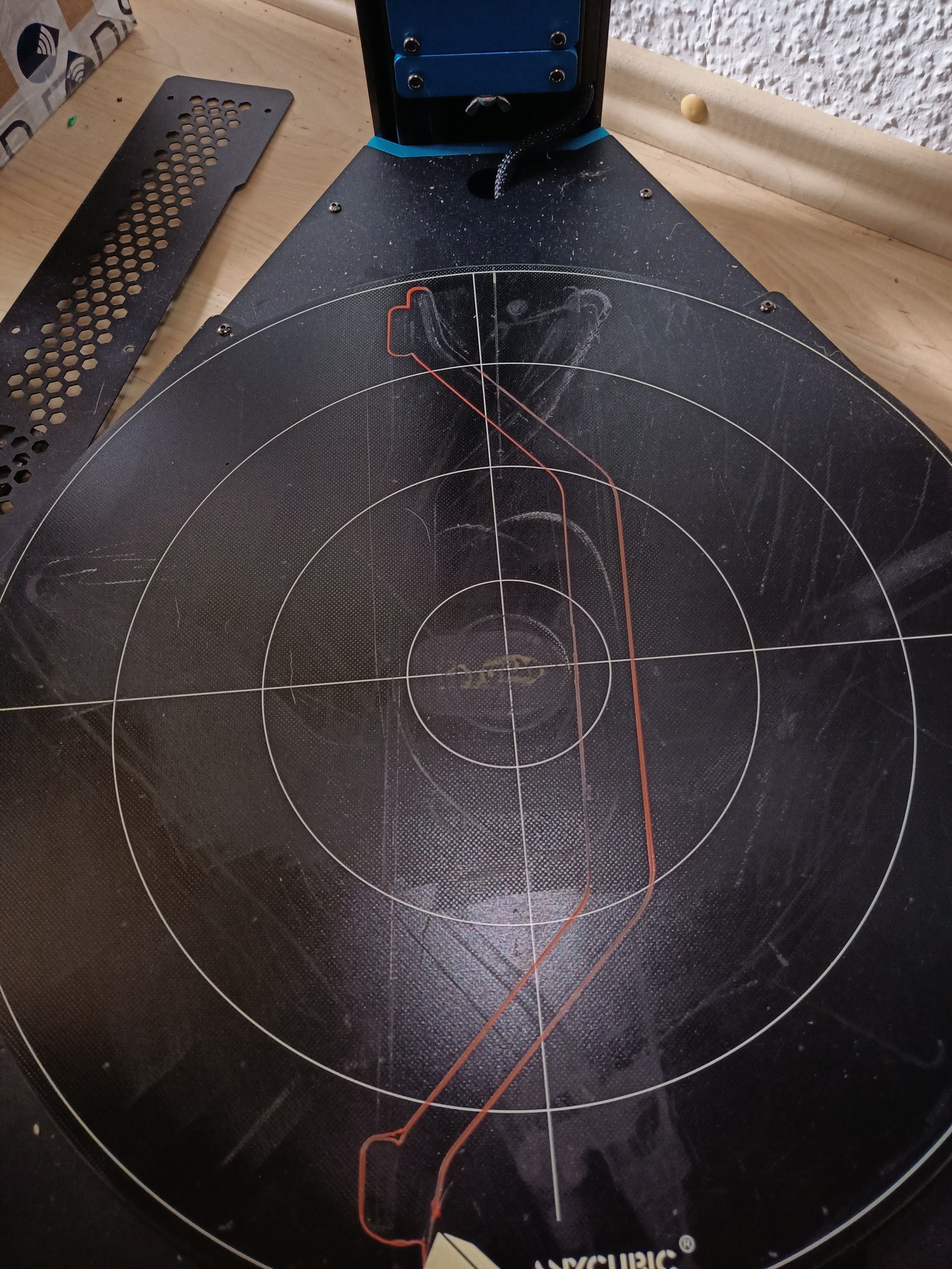

        Here a picture of the first layer, as you can see on the bottom it can be to low and to high over the course of a cm. I am sure the bed is not perfect, but it is not that bad either. This problem stays the same with or without mesh compensation. I do a delta calibration before every print, and do not home after.

                This is with the Z-0.3 and M666 all on 0
                I always heat the bed to 60 in advance, and nozzle usually 120
                Carloundefined 1 Reply Last reply Reply Quote 0

                    Especially on the bottom you can see that it is scraping the bed on the right, and half a cm next to it it comes off. I wanted to finish this layer, because this will continue untill the layers next to each other have that difference, but it started pulling everything off.

                                          • Lakemanundefined
                                            Lakeman
                                            This was the new height map
                                            Nozzle is clean, and filament I pulled back 5cm
                                            Changed back to S6 in the bed.g
                                            Some arms are 440.48 and some .47 So I have to chose, but that difference is minimum. Not sure why it was .50 in the override.
                                            Mesh is enabled
